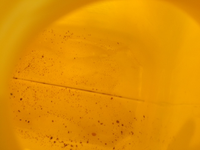

The plastic can I use for diesel has this reddish gunk in the bottom. It's a new can this year. The gunk started appearing right away. I treat all my fuel with Stabil diesel formula and for the last couple fillings, a biocide. The gunk looks biological. Any idea what it is and if I should worry? IMG_0343.JPG

Looks like some kind of mold.
   / What's the gunk in my fuel can? #3
Let it sit with some biocide in the bottom. Wash it. Dry it. Slosh some more biocide in it and fill er up. Report back at the next fill if it came back.

Could this be coming from your fuel supplier? It almost looks like rust particles.

I don't think it's rust or dirt as it's stuck to the can.

I changed the fuel filter at 50 hours (I'm at 65 now and have been using this jug since 5 hours) and it had some fine black material in it, though not a lot and no where near clogged.

I've seen it before as well. It looks like sediment from your supplier's tank.

I don't think it's sediment. This stuff doesn't move when I shake the tank with a small amount of liquid in it. Sediment would get sloshed around.

Get a paint stirrer and drag some of that stuff out, and get a closer look at it. May wanna show it to your fuel supplier.

Did that, took it all out. It's definitely not rust.
I've been getting fuel from three different local gas stations and they may not be selling a lot of diesel.
I only started using biocide recently, the diesel Stabil was supposed to take care of it. I'll be using it for the future and keeping track of what the fuel looks like from different stations.
