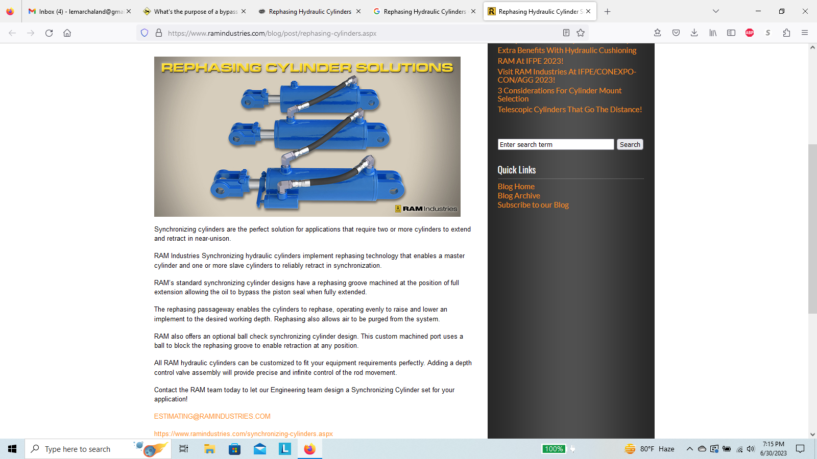

There is a situation were cylinders may have a "bypass" it is when Rephasing cylinders are used in a multi cylinder application.
Rephasing Hydraulic Cylinder Solutions
