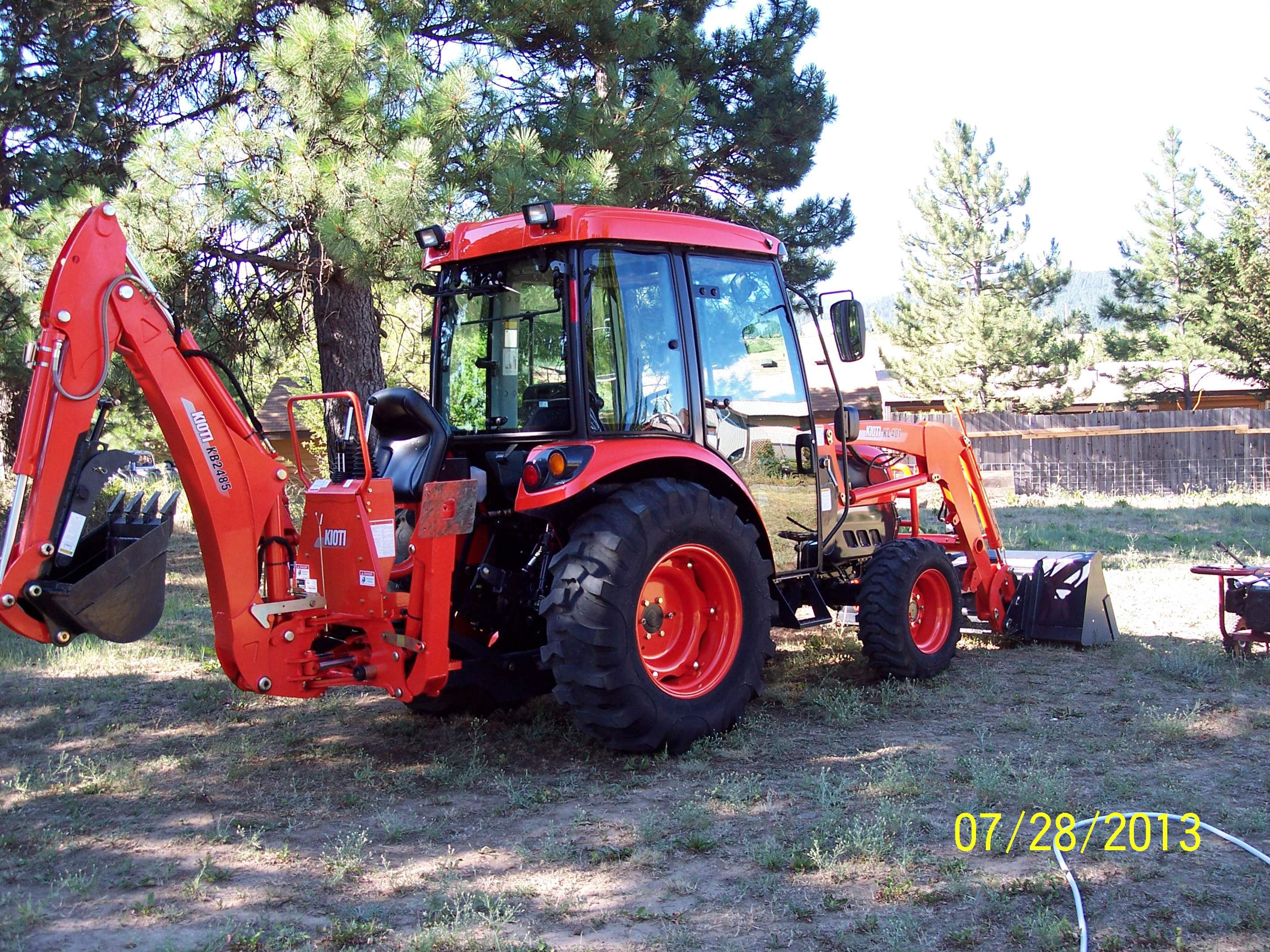

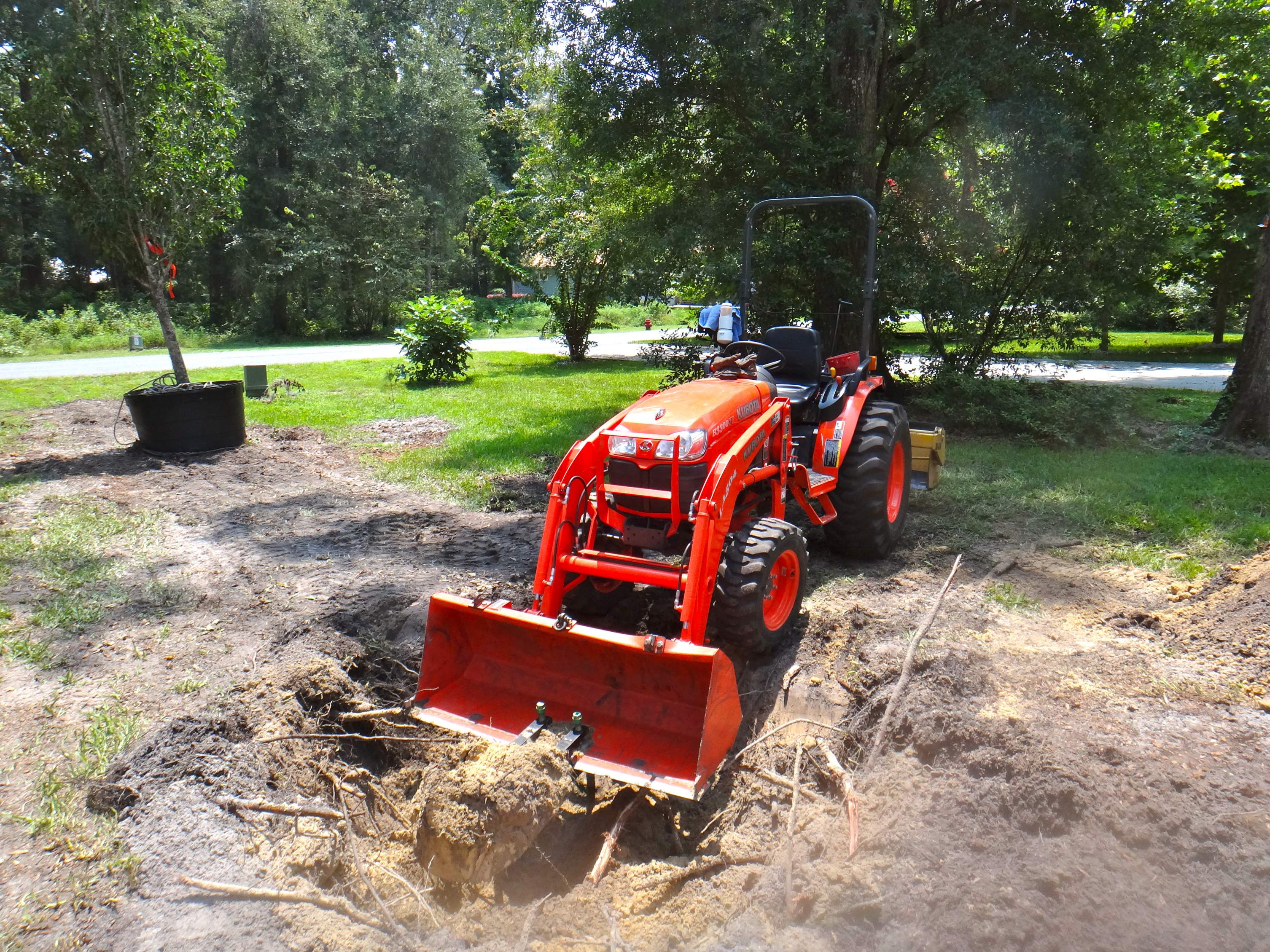

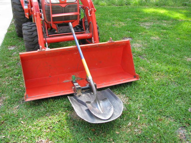

Many new to tractors want a Backhoe. Backhoes are fine if you use them a lot. Most people play with them quite a lot at first, then not much. Removing stumps is a good reason to have a backhoe....how many STUMPS ?.....how often? Can't let them rot?
For digging ditches, moving rocks and landscaping projects you may find a Ratchet Rake "Rip and Dig" or a Bucket Solutions "Bucket Spade" ample to your needs and cost relatively paltry $400 while (BIG UPSIDE) leaving the 3-Pt. hitch available for implements. Then you can buy four or five 3-Pt. implements with your Backhoe cost saving.

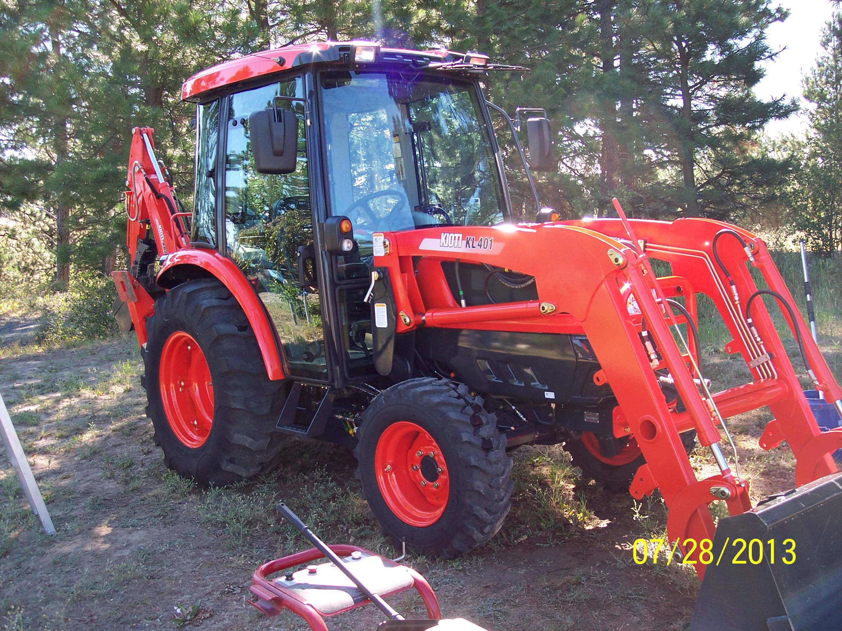

You should seriously look at moving up to an M size at the start. There is something to be said about 40+ PTO HP and 1 ton of FEL lift. Especially if you are looking at logging and any ground contact stuff (plowing etc.)
As far as towing figure tractor about 3,500, FEL 1,100, BH 1,500, filled rears 1,000 - you will need more tow power.
