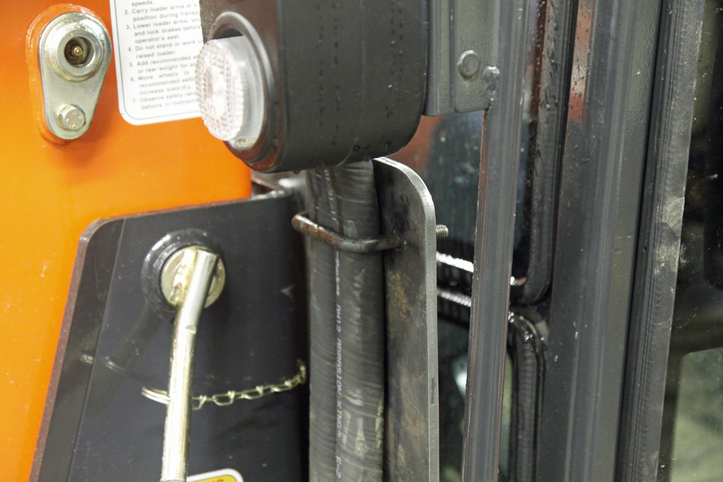

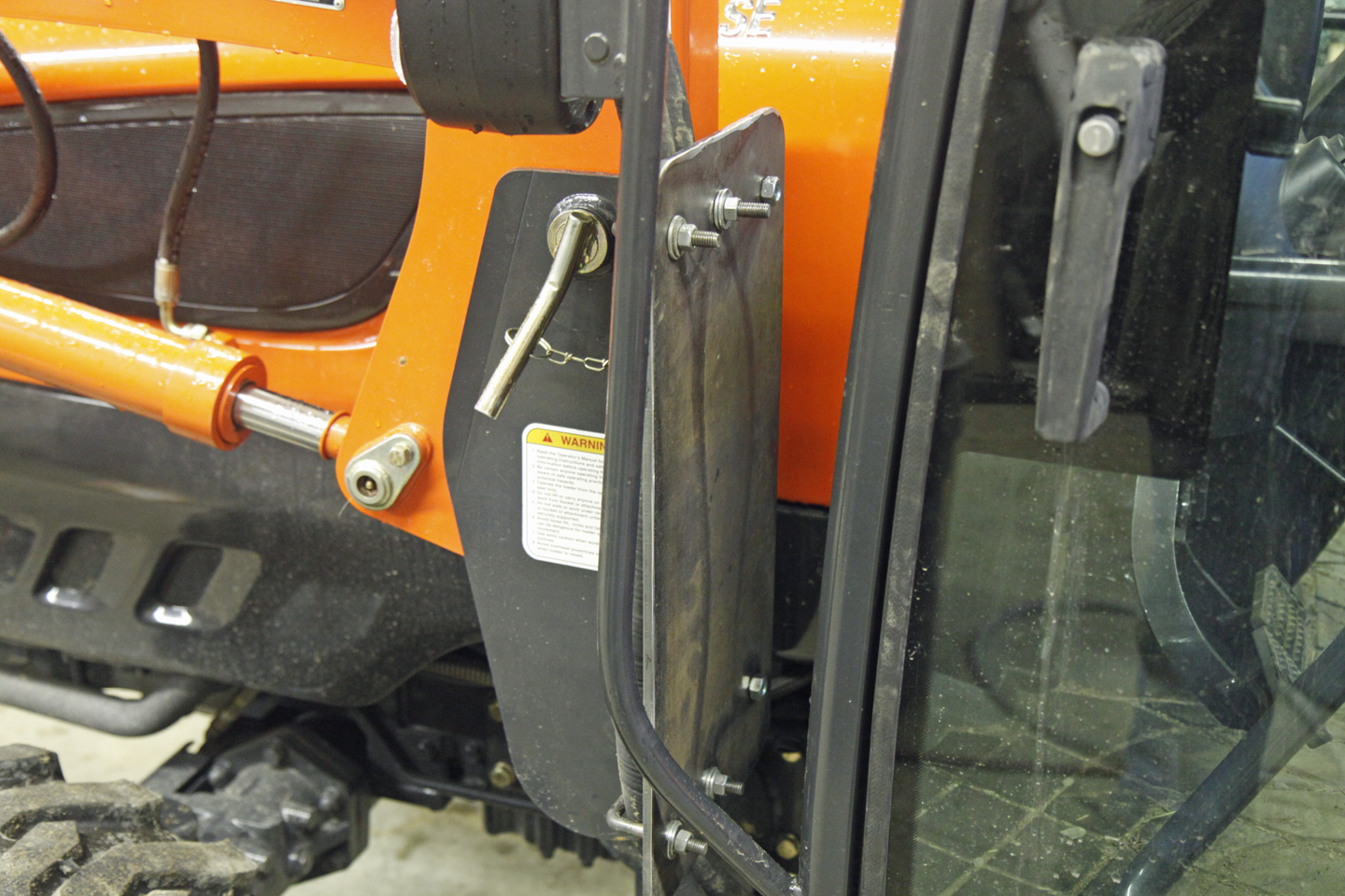

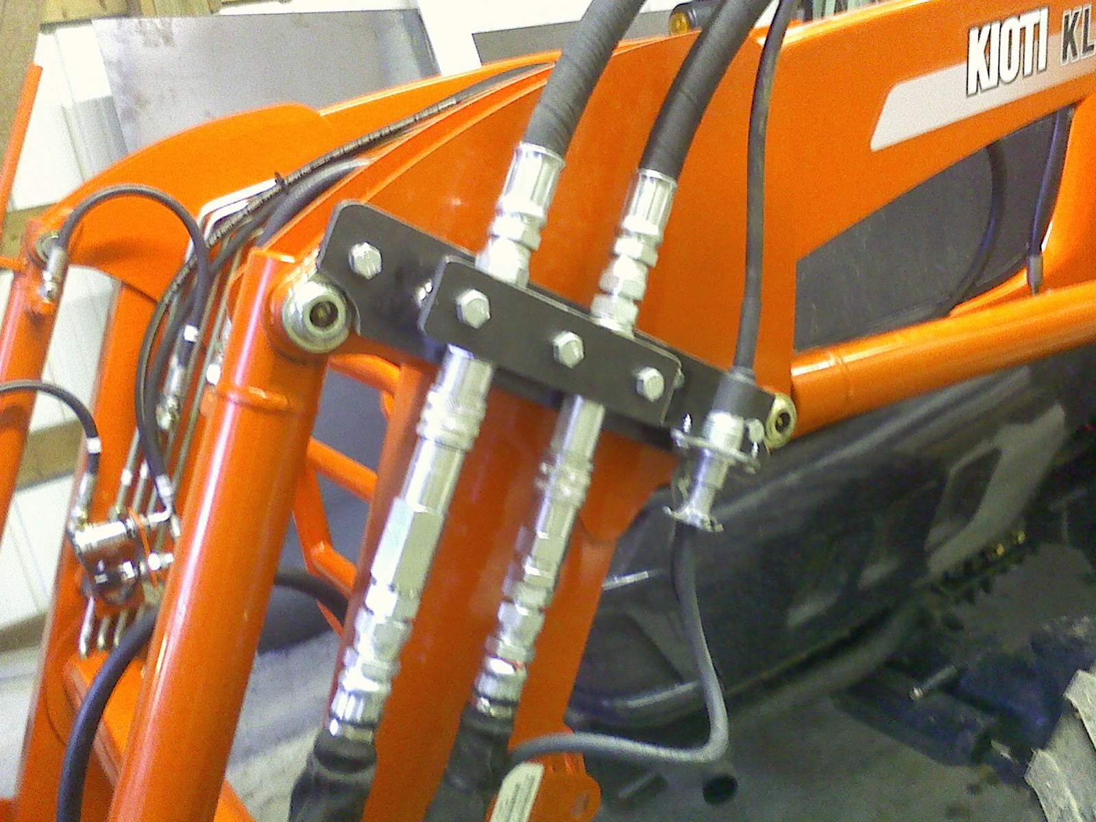

i had to add a mounting plate for the hoses to run to poser the front snowblower. had to remove the loader to insert the bolts.
Are you running a hydraulic drive front snow blower? Or are the lines to rotate the chute?
its a front loader mount snowblower. the 3/4" lines are for the operation of the snowblower. there is an electrical line to operate the hydraulically operated rotator and deflector. i haven't added it yet. in process of doing so.

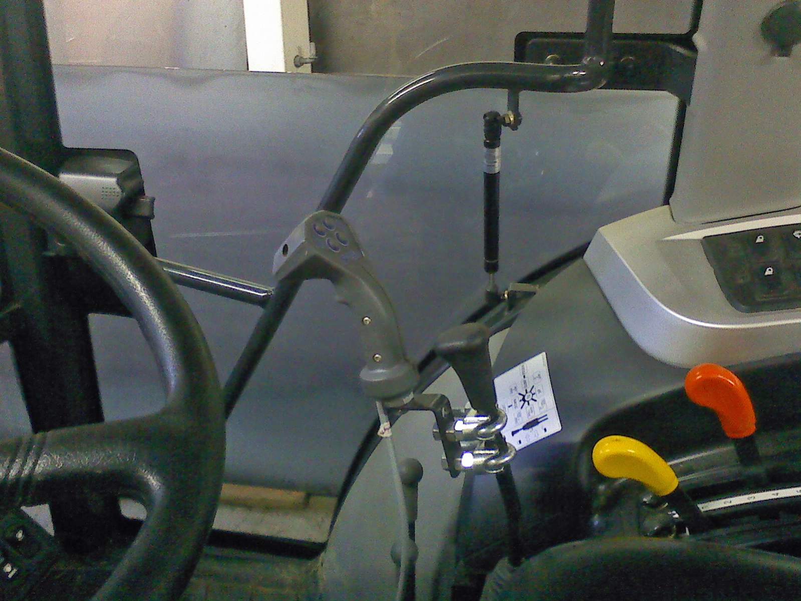

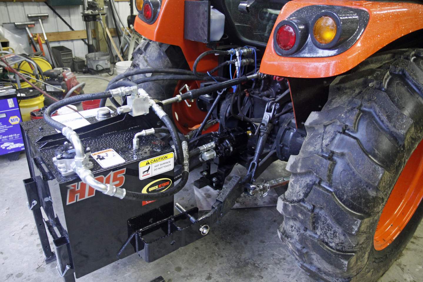

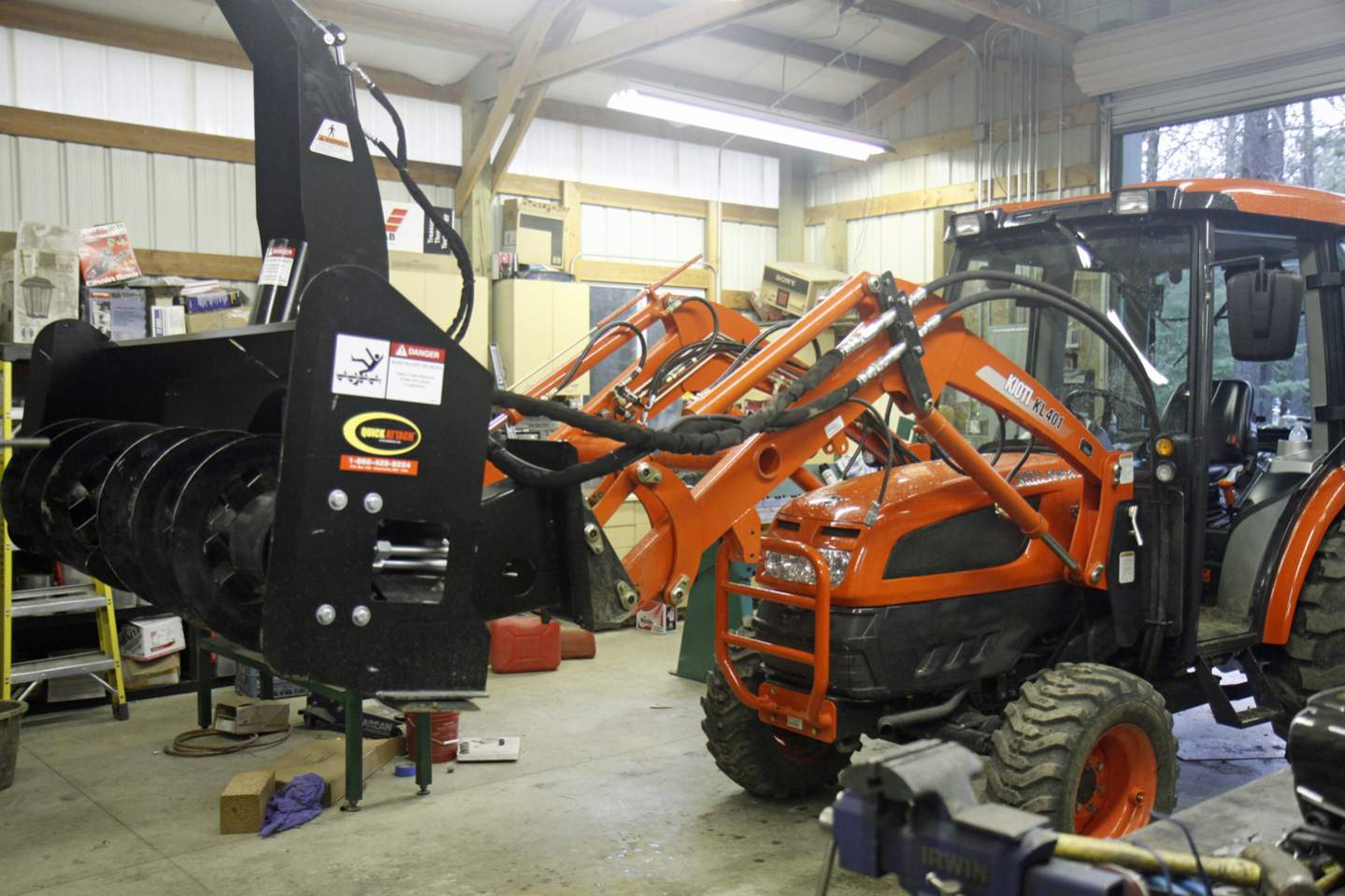

its a rear powerpack. puts out 15 GPM at 3000 psi. Holds about 27 gal of hydraulic fluid including whats in hoses. Here are some pics. the brackets arnt power coated yet. have some minor electrical work to still do
