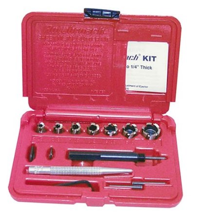

Easiest and fastest way to drill horizontal holes is with the annular type bits such as Blair / Hougen. They are like holesaws, they are fast because they don't have to turn the whole plug into chips. Great for battery drills, they cut faster and with less power.
Among the best $63 I've spent on bits was this kit by Blair, but this kit doesn't have 1/4". It has 5/16, 3/8, 7/16, 1/2, 9/16, 5/8, and 3/4. Maybe you can use 5/16" holes for your project.
