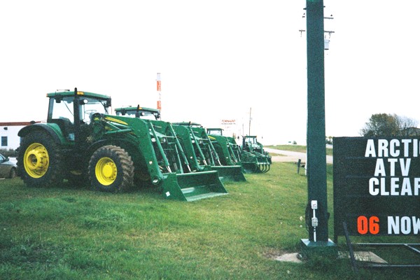

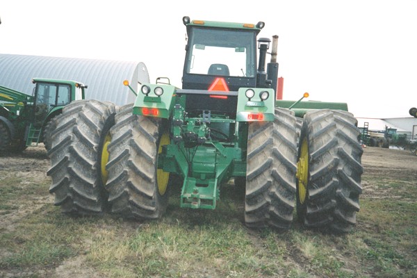

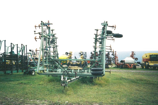

Attached are some picture taken at a an Implement dealership from the area where I grew up. In this area the smaller used tractors are not readily available. In fact some dealerships with tractors that will max out in the hundred horsepower range have trouble surviving despite the fact they offer an excellent piece of machinery.:D
First picture would show a typical chores tractor. many are much larger.
The second picture shows some typical cultivating implements.
The third picture is a typical pulling tractor. Note the lack of three point hitch. When this fellow gets a proper seed train hooked up it may take him ten acres to turn around!
