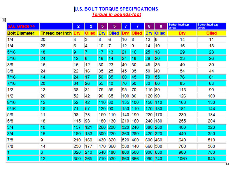

please advise the torque for 5/16 bolts that hold the timing gear to injector pump on perkins A3 152 on a massy 235

Don't know about that particular engine but here is the standard for SAE bolts.
