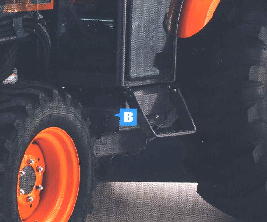

"Low fuel tank and and filler." The filler on the L5740 is on the hood which is a bear to fill with a 5 gallon can. The fuel tank on the 60 Series is mounted under the platform and fuel filler is down there too; sorry.

I went and priced a L6060 today. What does "fuel tan and filter low" mean?
Is that a fuel tank?
It would make sense to design a tractor that was easy to refill with Diesel (or gasoline). Some of the smaller tractors locate the tank just under the hood. This would be an ever bigger pain with a cab tractor.
From the PDF, it shows the fuel tank below the step, although the filler neck isn't clear.
I can't find the link, but someone posted one in which it showed the filler under the right side of the platform and the right side step has been eliminated. we work in the woods quite a bit and the steps on our 5030 and M8540 as well as our previous Case CX80 have been bent, so I personally don't care for the low mounted tank. We use an above ground tank to fill, so it is not a problem with the filler up high, but it sure was when we were using five gallon containers. The tanks are suppose to be rupture resistant, so time will tell.
