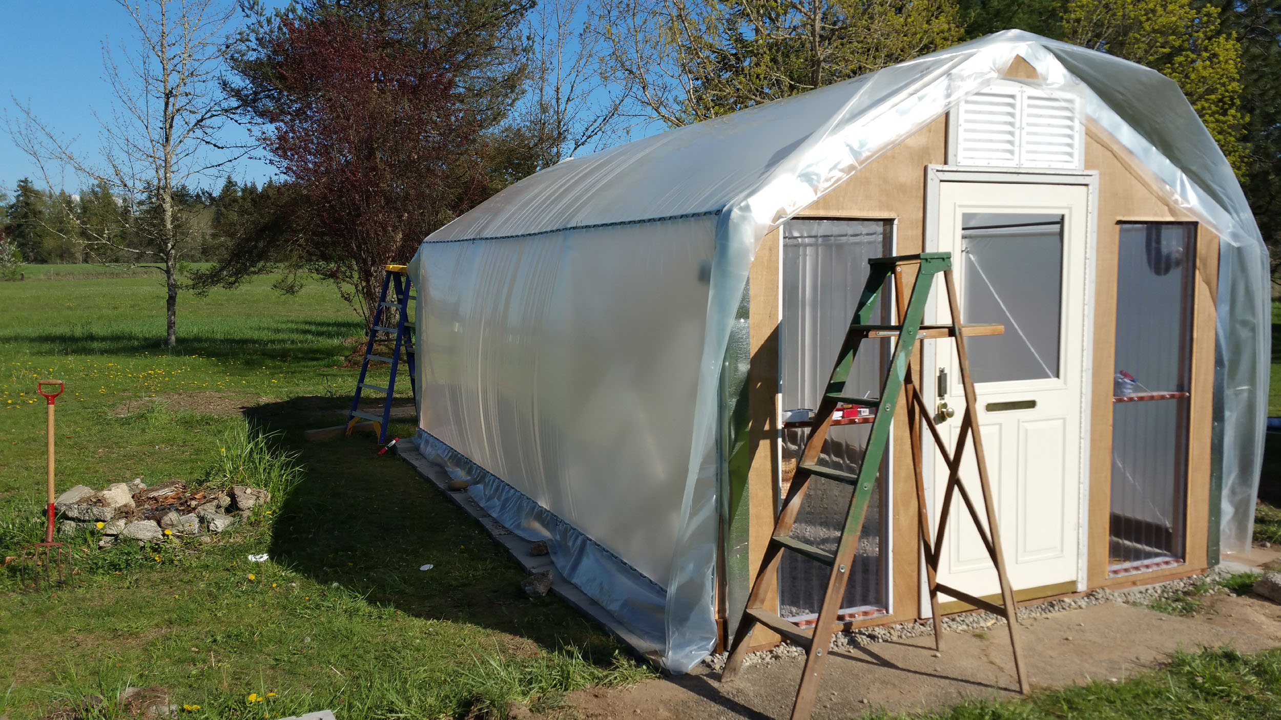

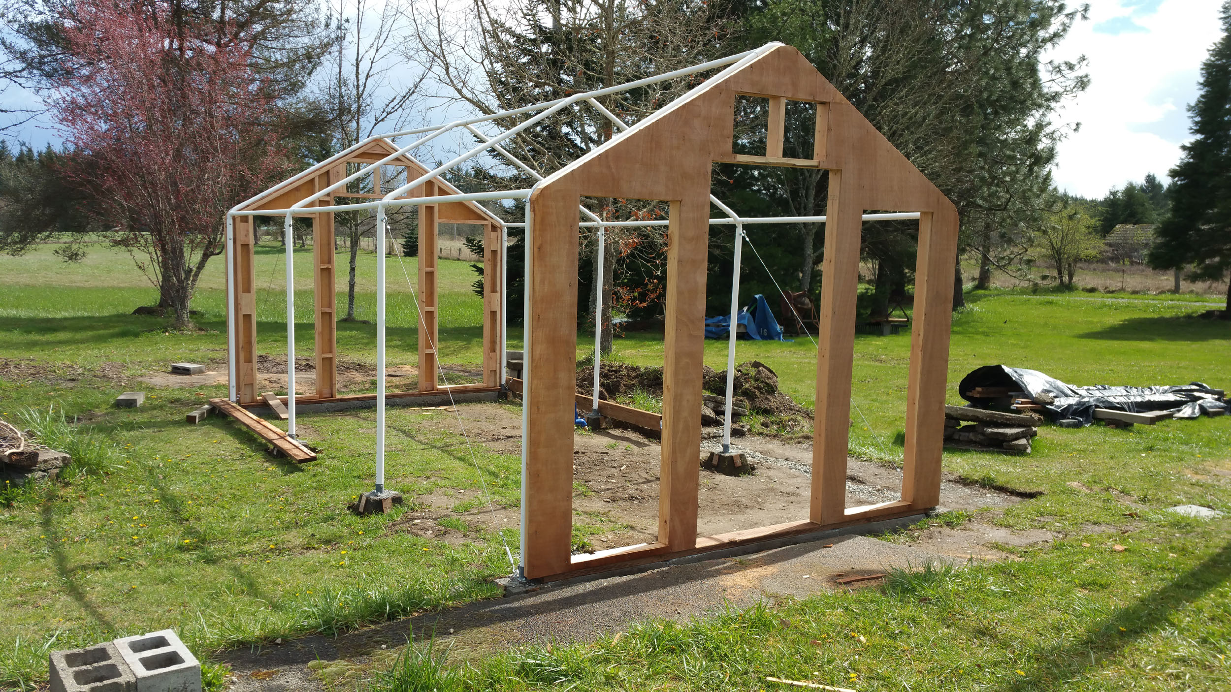

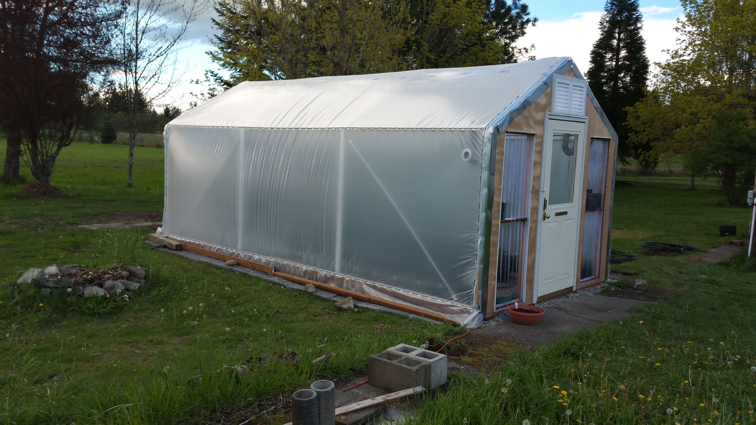

Mapper, would love to see your greenhouse, I've thought of doing the same thing.
Here some photos from the construction last spring:
Plastic on and inflated, note blower and jumpers to the sides from the top.

Frame up and ends on
Attaching the plastic, plastic is attached using aluminium "U" channel and wiggle wire.
Turns out that I planted way too many tomatoes, by the end of summer I almost needed a machete to get down the aisle. Cutting back to a single double row this year.
The tomatoes are grown on a string suspended from overhead cables, as the plants grow and reach the cable the string is let down and the stem is played down along the pots.
I also added a fan and vent controlled by a thermostat.
