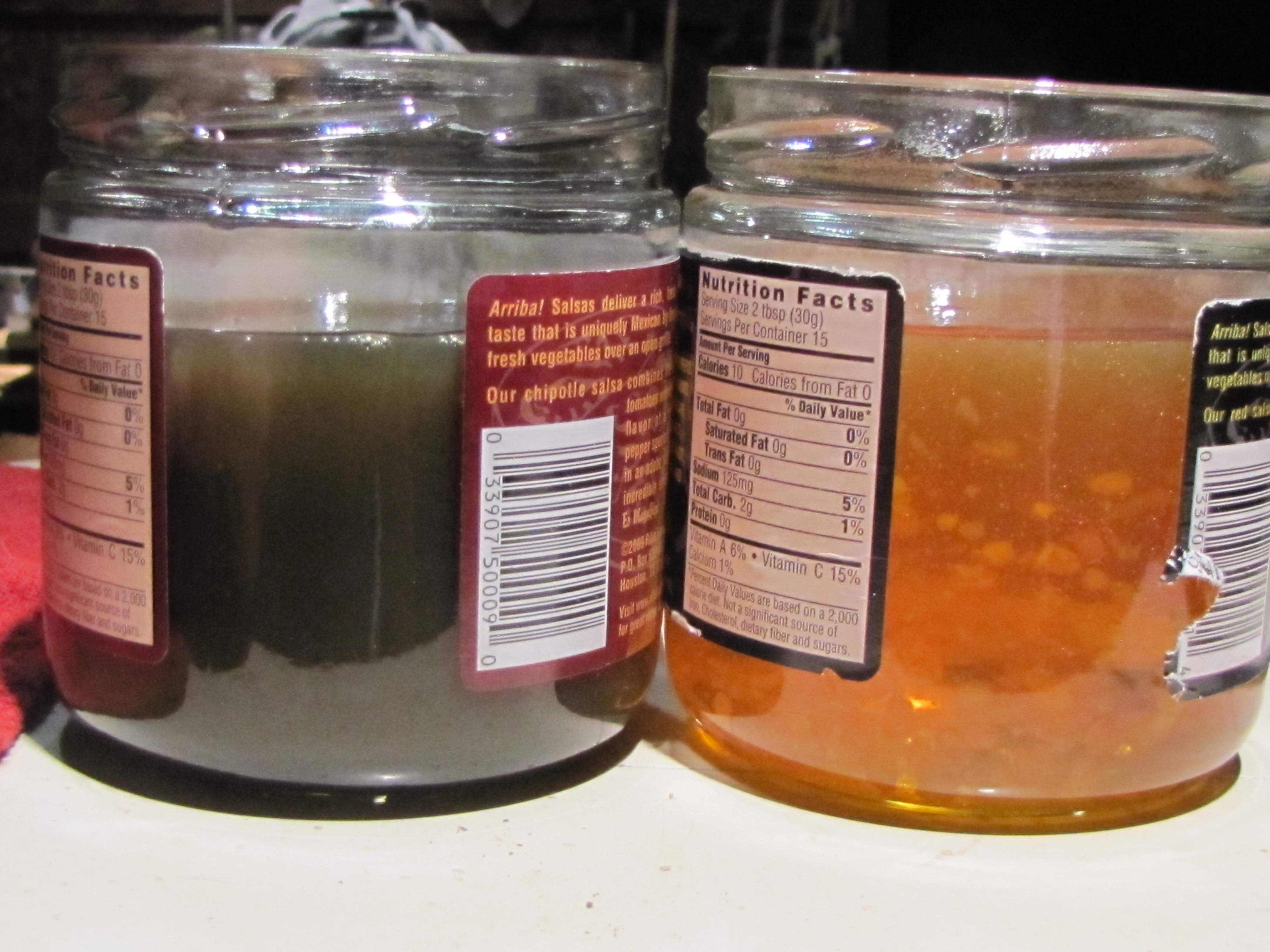

So I have a Mitsubishi 372D. Today while running my brush hog it started spewing the gear oil (80w90) out of the boot around the shifter. It was under a lot of pressure and I probably lost several quarts before making it back to the barn. The night before i had topped it off so the level was full.
Someone suggested that there might be water in the oil causing this problem. I'm not sure how water would cause this condition but thought I would pull some out to take a look. I drained a bit of fluid out of the case and found this.
The nasty brown stuff is on the left, with some fresh oil on the right for comparison. There is only about 40 hrs on this oil, although it sat all winter, under cover.
Is something coming apart in my gear case? there is a bit of metallic material in the goo but not much more than I would expect. The filter has a bit of particulate matter but isn't clogged.
So any thoughts on what would cause this? Should I clean out the case with Diesel or Kerosene (or something else)before refilling?

I recently changed my hydraulic/gear oil on my TC45A with 186 hours. I was also surpised how nasty it looked with just that many few hours. I also noticed a very, very slight silver sheen near the bottom of the container when pouring it out but my NH mechanic said this is normal.
Your tractor even though covered might be getting water from normal condensation. Do you have a dipstick to check the oil level or a plug on the side of the case? When you said you topped it off, these cases are not supposed to be full to the top of the case.

yep.. looks like water emulsion to me.
water will fall tot he bottom of the sump, displacing the oil upwards.
thus if a sump was at the correct level of oil, then had 'x' amount of water added.. it would be overfull.
oil on most metal surfaces is hygroscopic, and will attrat water. in a vented sump that gets hot and cools.. that invites condensation for the atmosphere.. that or you had a leaky boot somewhere.
i'd add a quart of diesel, a quart of atf, and 2 pints of 91% rubbing alcohol, run the machine for a couple minutes to mix well, then drain.. then refill with fresh oil. you will get the bulk of the water out that way. way more than just a drain and refill.

Thanks Soundguy...some of this sounds familiar, as chemistry class was a long time ago.
My local Mitsu guys suggested 2 gallons of straight diesel, but your recipe sounds good. He also informed me that I should be running Universal tractor fluid or something similar (30w trans/hydro fluid). My manual had me put the 80w gear oil in it.
Sweep, by topping off I didn't mean the case was full, but I was still likely overfilled anyway. I was just eyballing it through the filler plug, but I did find it has a plug on the side of the case...which gives the correct level. Everyday that I learn something new is a good day I guess.

Something that wasn't mentioned. With water in the oil when it gets hot it will expand. That could be another reason you were blowing it out.

Does anybody think the "fresh oil" on the right in the pictures looks funny? It looks like it has globs of stuff in it. It doesn't look right to me.
