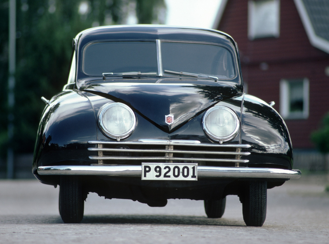

I like my skinny ags! :thumbsup:
Yeah. They dig in real good.
I will admit to being heartbroken when I first saw them when my tractor was delivered.
The tractor that I drove at the dealership had R4s on it and the difference in appearance is immediately apparent.
Like the difference between the aggressive stance of a Wide Track Pontiac GTO and a SAAB 92.
Two guesses which one's better in the snow.
View attachment 278536View attachment 278537
Ah man, it don't look that bad... ;)
Think more like an old Ford 4wd 3/4 ton pickup with tall skinny mud grips. :D
