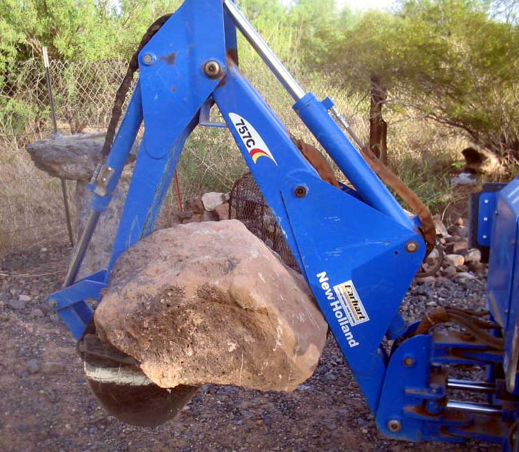

I'm a firm believer in "Useful" ballast. Keep my back hoe on 98.3% of the time. Several advantages to using a BH. At times I have picked up a large rock for more weight. When crossing a side slope, BH can be turned to the up hill side. A foot put down on the low side just in case.
I hate filled tires, but that is a whole nother story. :laughing:
