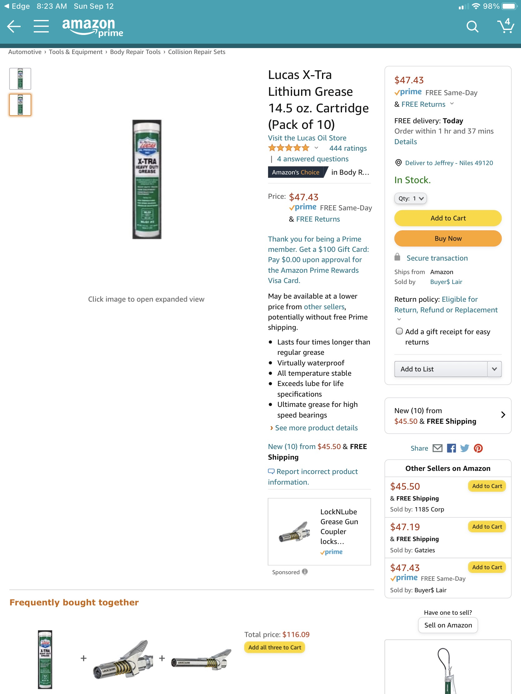

I’ve had good luck with this Lucas product.
