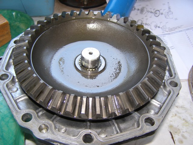

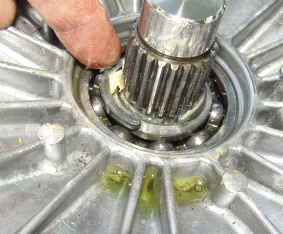

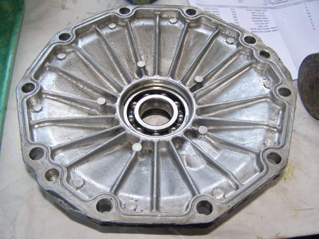

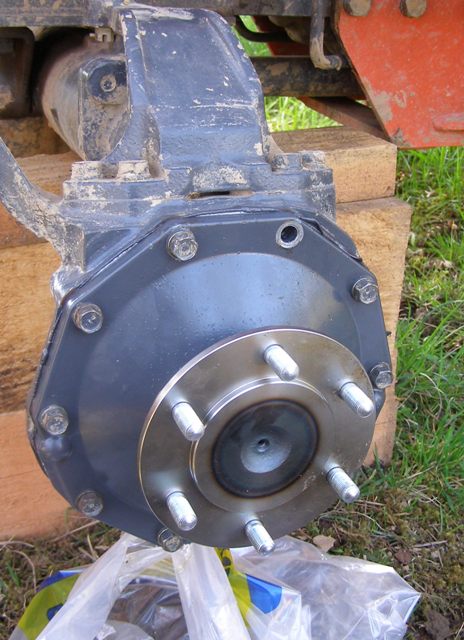

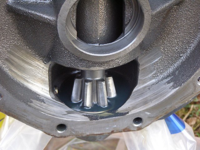

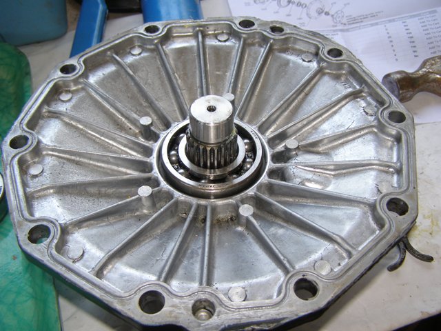

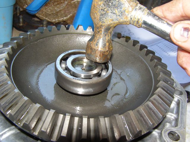

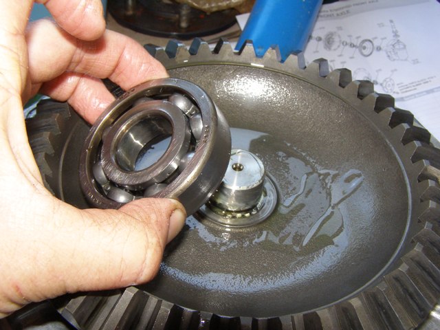

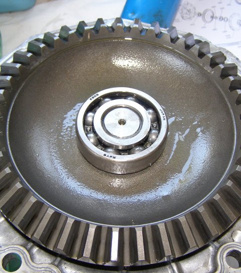

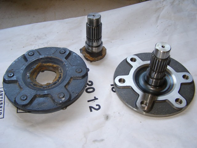

Well, it's over a year later, but I wanted to post the photos of my repair, since the thread that helped me most (http://www.tractorbynet.com/forums/kubota-owning-operating/214500-b2910-front-wheel-snapped-off.html) was so great with the pictures, and I figure one more example of a repair is always helpful.
I'll probably post in a couple different posts, as there are a lot of photos. I'm doing an B7800 axle repair for dummies here.....
OK, this is a bit awkward, and let's hope the thumbnails stay in order.
1) the broken part(s) and the new hub, shown without studs in yet
2) cleaning the old sealant off--why not do it in the comfort of a warm kitchen
3) outer plate
4) hub seated through plate
5) seating the C rings--the guy at the tractor place said to put them in with lots of grease, like gluing them in so they stick tight
6) seating the gear (yeah, getting that off originally was tough--used a 3 prong gear puller)
7) placing the bearing
8) seating the bearing, tiny taps
9) oh, go to the next post

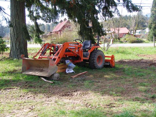

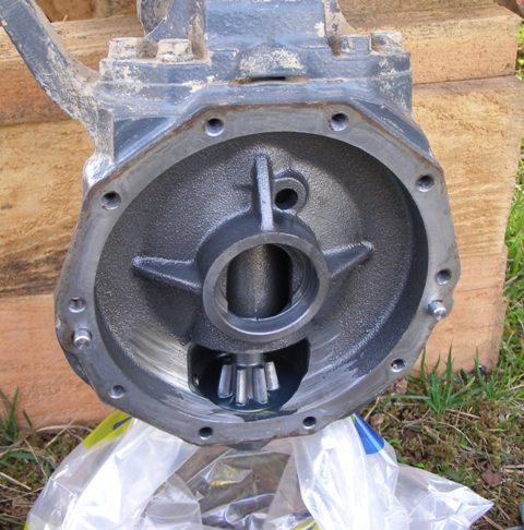

To continue B7800 Axle Repair for Dummies:
1) Everything back, hopefully, in place, ready to re-attach
2) Waiting tractor, great place to break down, couldn't have planned that one better
3) Uncovered
4) Close up
5) Applying the sealant into groove--I don't get manicures
6) Almost completely attached. Will fill with about a gallon of oil after this....
7) Tractor, back in service !!

It looks like that old one had already been welded before you got it? Did it take this long to get the parts or just this long to get it posted?
   / Wheel broke off !
#19
It took only about a week to get the part--the photos are from last year and they've been hanging around awhile. And it's possible it had previously been welded, yes, but I'm the 2nd owner.
