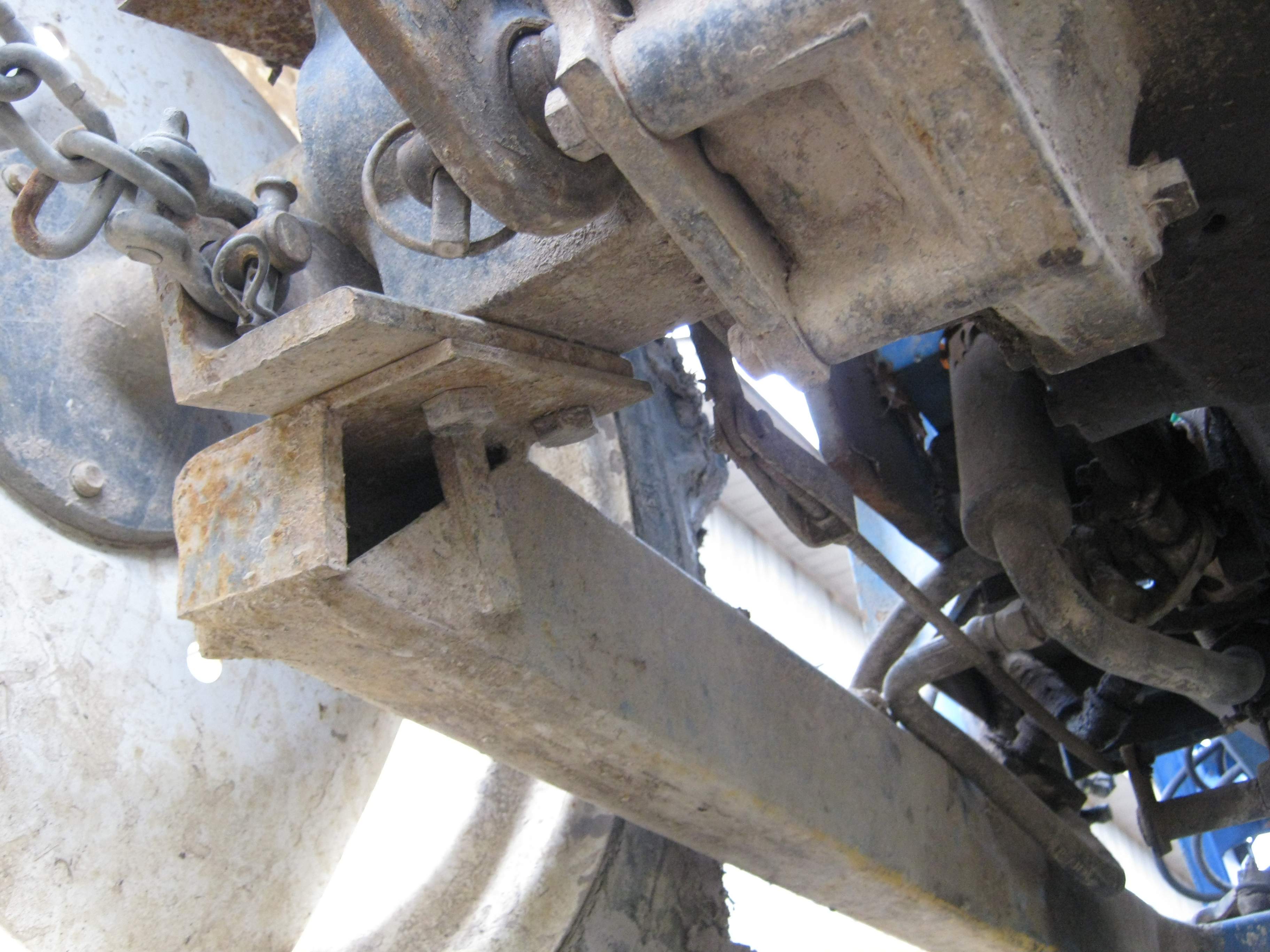

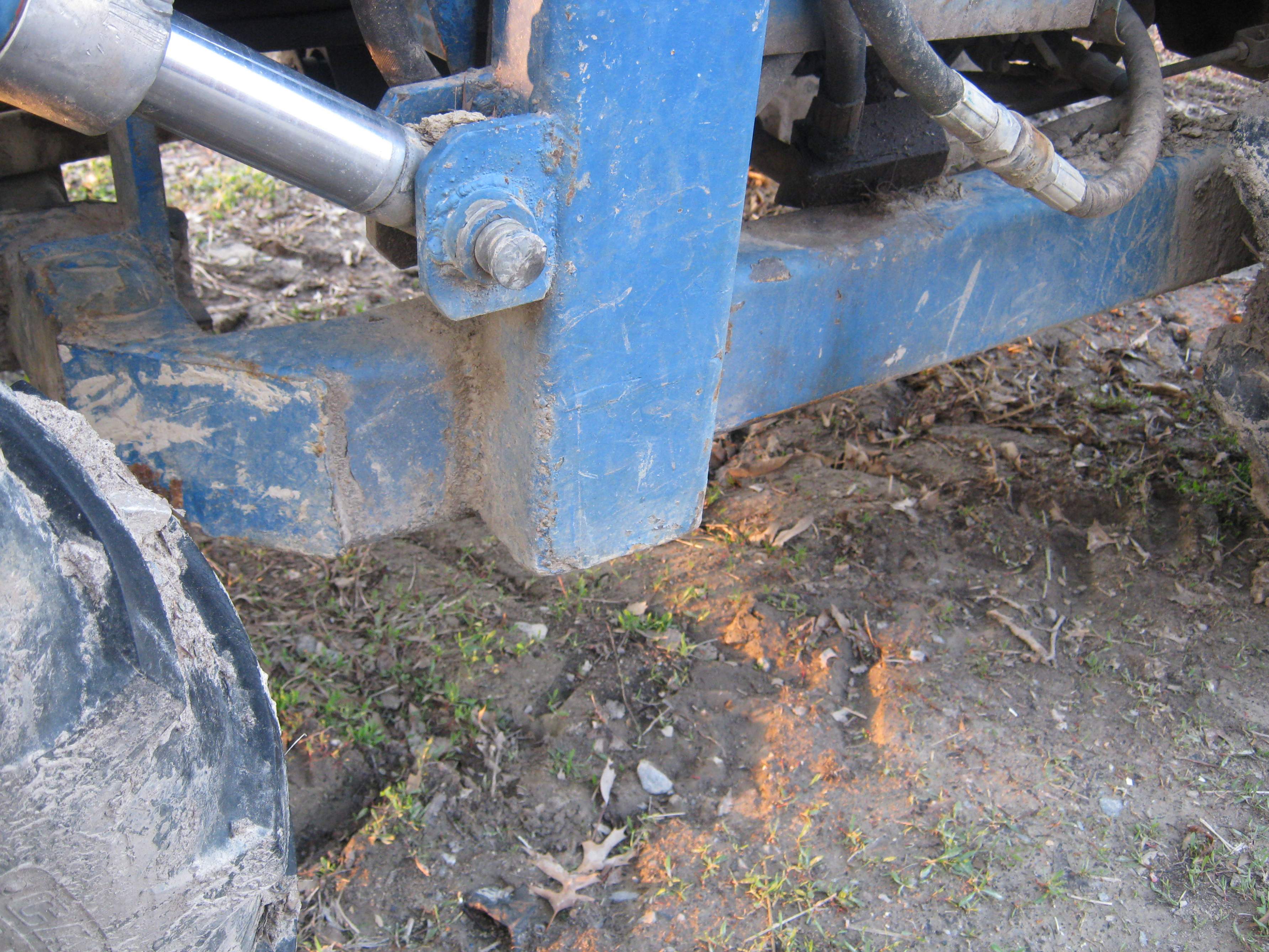

I too built my loader, bucket and subframe. This is mounted on my Mitsubishi MTE2000D.......it's been pretty muddy here. I'm a little embarrassed to show these pics but I'll take the hit for the cause.:ashamed:
Here are two pics of the subframe, the first shows how I crossed over under the drive shaft. The short transition from 2x4x1/8" to smaller, heavier walled stock is how I was able to keep the subframe high on the tractor but still cross under the drive shaft. The second pic shows the side rails running to the rear axles. My design is obviously different than your needs since my loader arm uprights are actually welded to the subframe rails but you get the idea. With my subframe, it is a 2 piece unit. On each side there are two bolts at the rear axle, 4 bolts on the engine housing and then two bolts (shown) under the drive shaft....take those out and the subframe comes off and is in two identical pieces. The loader itself can be taken off by taking the 2 loader arm pins and 2 lift cylinder pins out and disconnecting 4 hydraulic quick connects and backing out away from the loader....leaving the subframe/uprights/joystick on the tractor. Everything is made out of 2x4x1/8 and is WAY heavier than needed for this design. I've had it on for 4-5 years now and had no issues whatsoever.

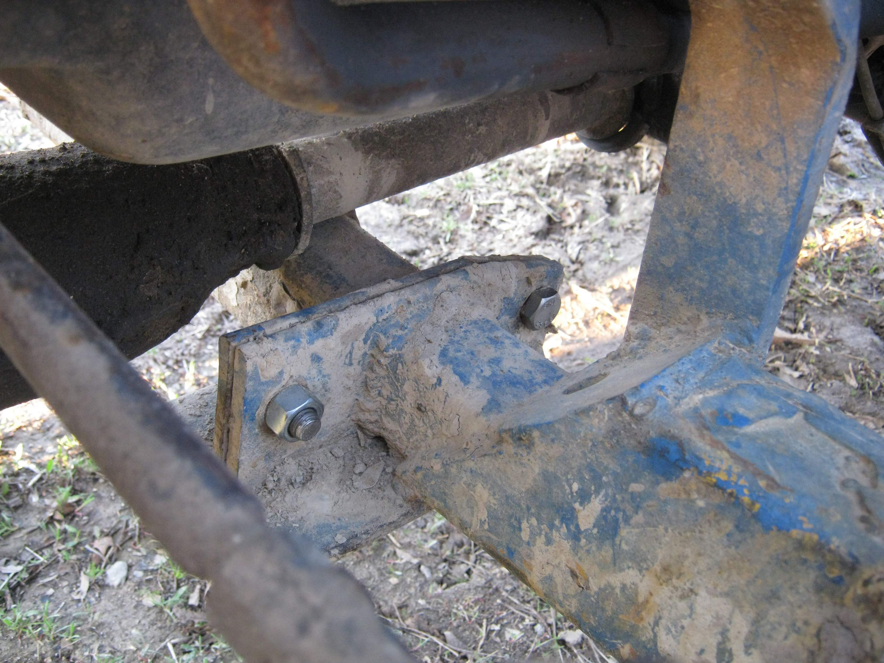

Thanks for the pics, if you get a chance I would like to see how you mounted your frame to the rear of the tractor.
Here ya go. Man, I've got to break out the pressure washer soon, I'm flat ashamed of how dirty and scraped up she is right now!
Thanks for the pic, gives me a good view of how I might attach mine.
