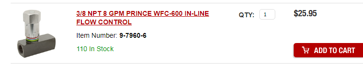

You could install an adjustable flow control valve in boom hose circuit. I did just yrs back that on a Kubota frt end loader for handling large rd bales.
   / wheel loader lift high speed only #18
I also did that on a homemade loader on a garden tractor. Made a big difference in how much control I had of the machine.
#19
Thanks for that tip, I think I will do that. Seems simple enough.
