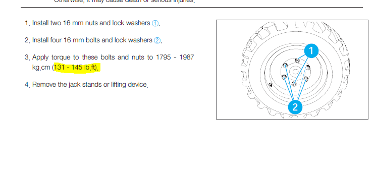

Unless the search function missed it, I see no place on the forum that anyone has listed the torque for the wheel lug nuts and bolts. I have an XR 4140 and would like to retorque the wheels correctly. If anyone has these numbers, I'd appreciate them.

I found mine in the service manual. I looked at the owners manual too, but that only says to 'check the torque.' which is helpful.
The service manual is 131-145lbft for both front and rear for my tractor (which is probably going to be the same as yours)
I just put a bar on the end of my beaker bar, and do the 'German Torque setting' of Goodtntite
Awesome! thank you!!
