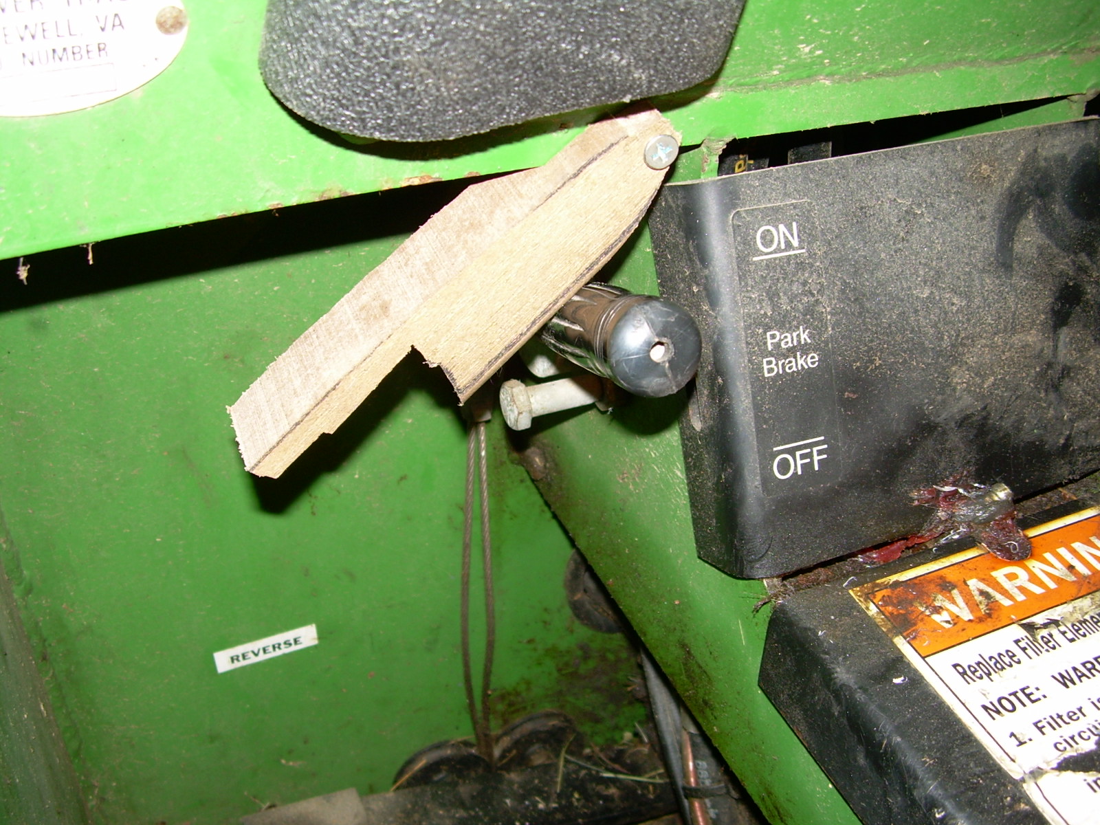

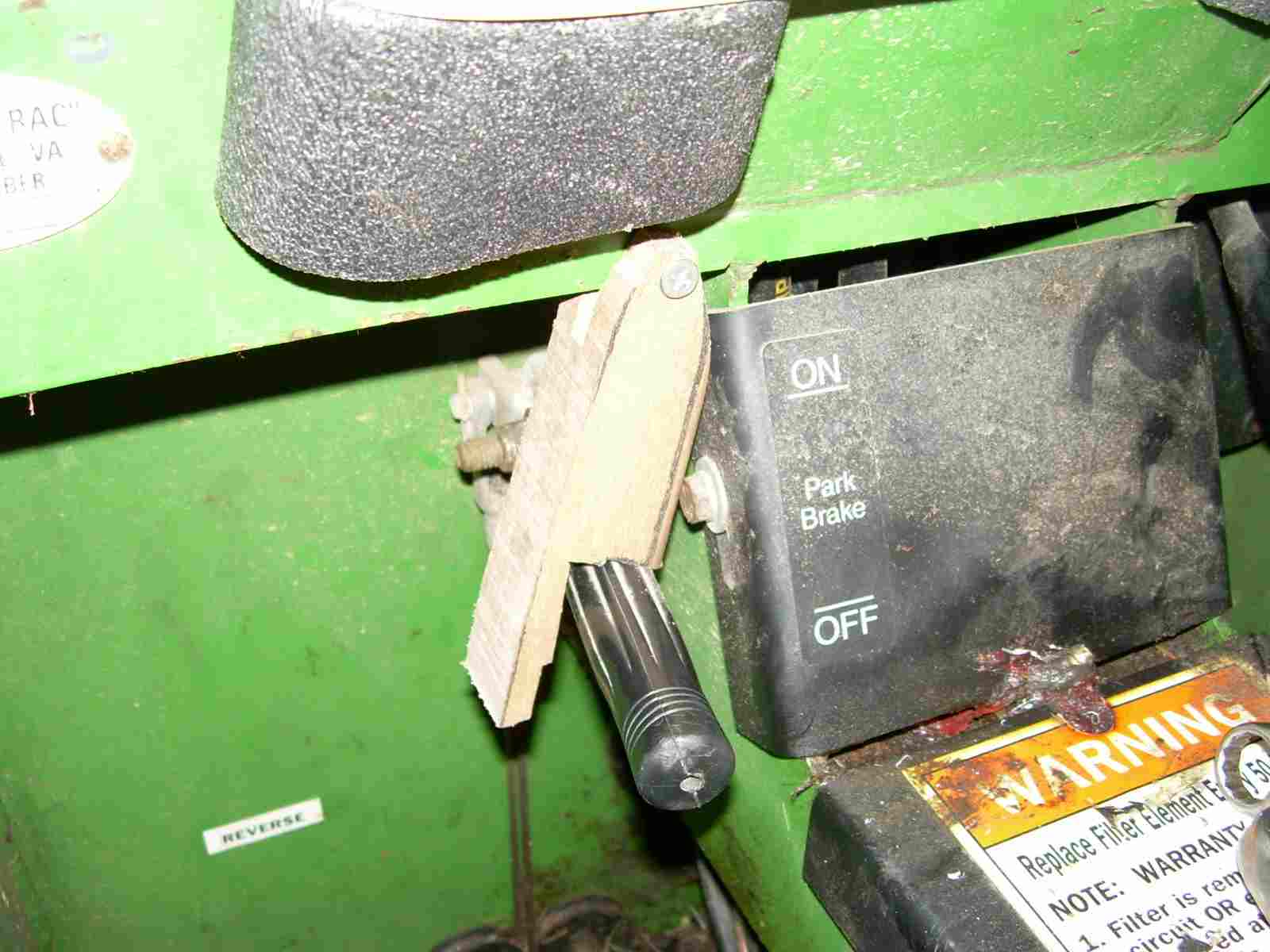

My problem isn't the pin and slot. The problem is the handle. If I make it loose enough to operate without straining my arm, it will not stay disengaged. If I tighten it up enough to stay disengaged, I have trouble setting and releasing it. It is just not a well designed handle. It is really about the only thing I dislike on the tractor.
/ Wheel Motor Cross Reference? #14

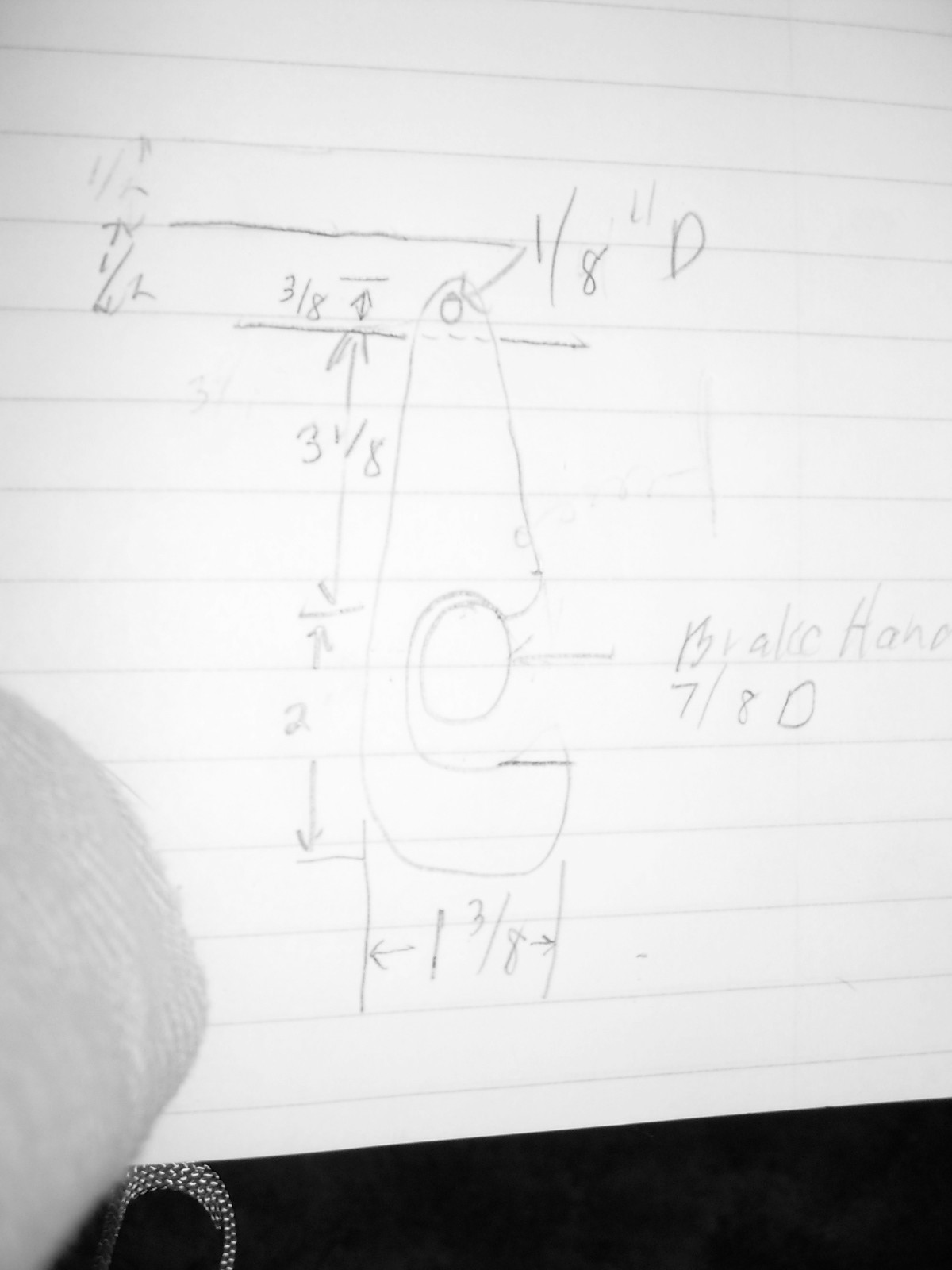

Moss, I know you have seen this before, but here it is again. I have been using this for several years and it works great. I loosed the friction nut, so that problem is gone. It is self latching from gravity. It can be easily released with one hand. Very simple to make. It is made of that plastic/wood decking board.

Honestly, I do not remember that at all. Very simple. Very elegant. :thumbsup:
