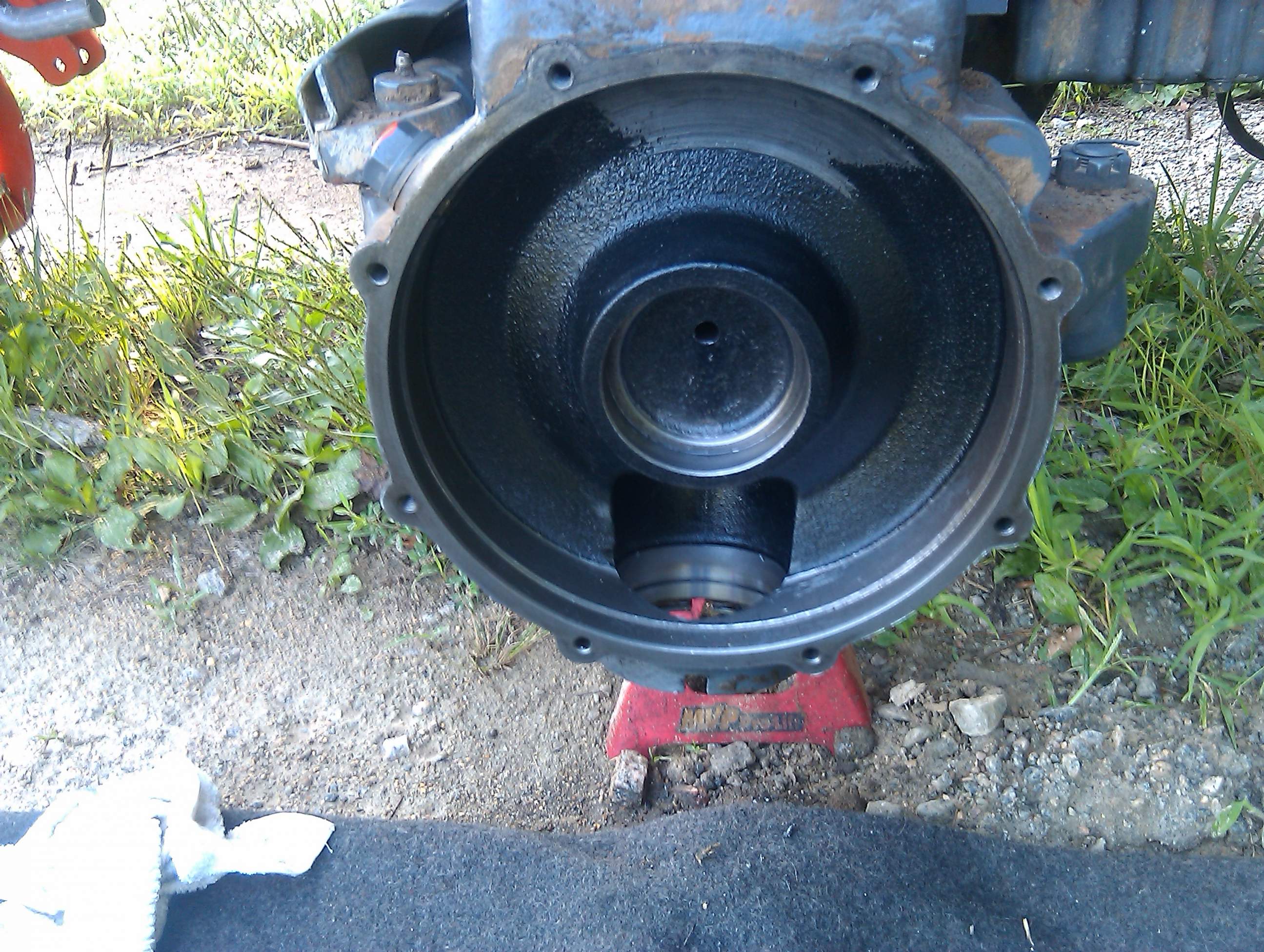

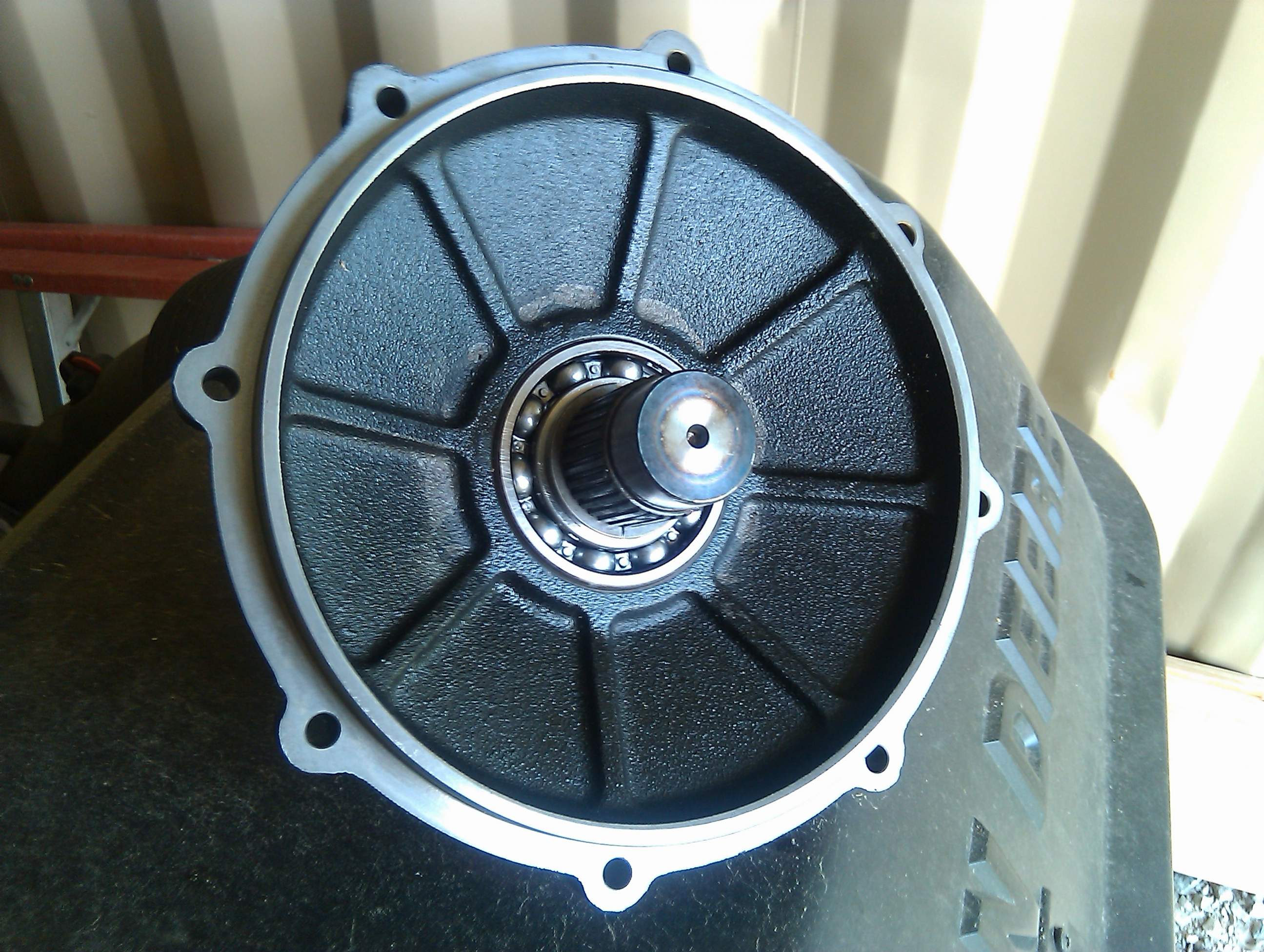

Thanks everybody for the links, diagrams and help.
Here is the update:
I was able to get the axle components assembled and mounted back on the tractor. Better yet, I was able to drive it back to the barn and give my re-assembly a better once over.
After looking at the service manual and getting all of the parts, it was a fairly straight forward project. Not easy, but pretty straight forward.
The hardest part was having to drop the lower gear and shaft in order to allow the larger bevel gear to be reinstalled in the axle case. This would have been an easier task if the tractor would not have been in the field. (It has also been hot as **** here lately).
Here are a couple of pictures of the re-assembled parts (minus the bevel gear and a bearing- I added those after taking the picture). No hydro oil on the lens this time.
The smudge in the axle case is just where I wiped it with a rag. I had an area that looked like there may have been a gouge, but it was nothing.
In putting everything back together, I believe my original issue was with the retaining clip/snap ring that goes around the axle. I am not sure if it failed or broke/popped off. Once that goes - there is nothing holding all of the axle components from getting out of line and torn up.
