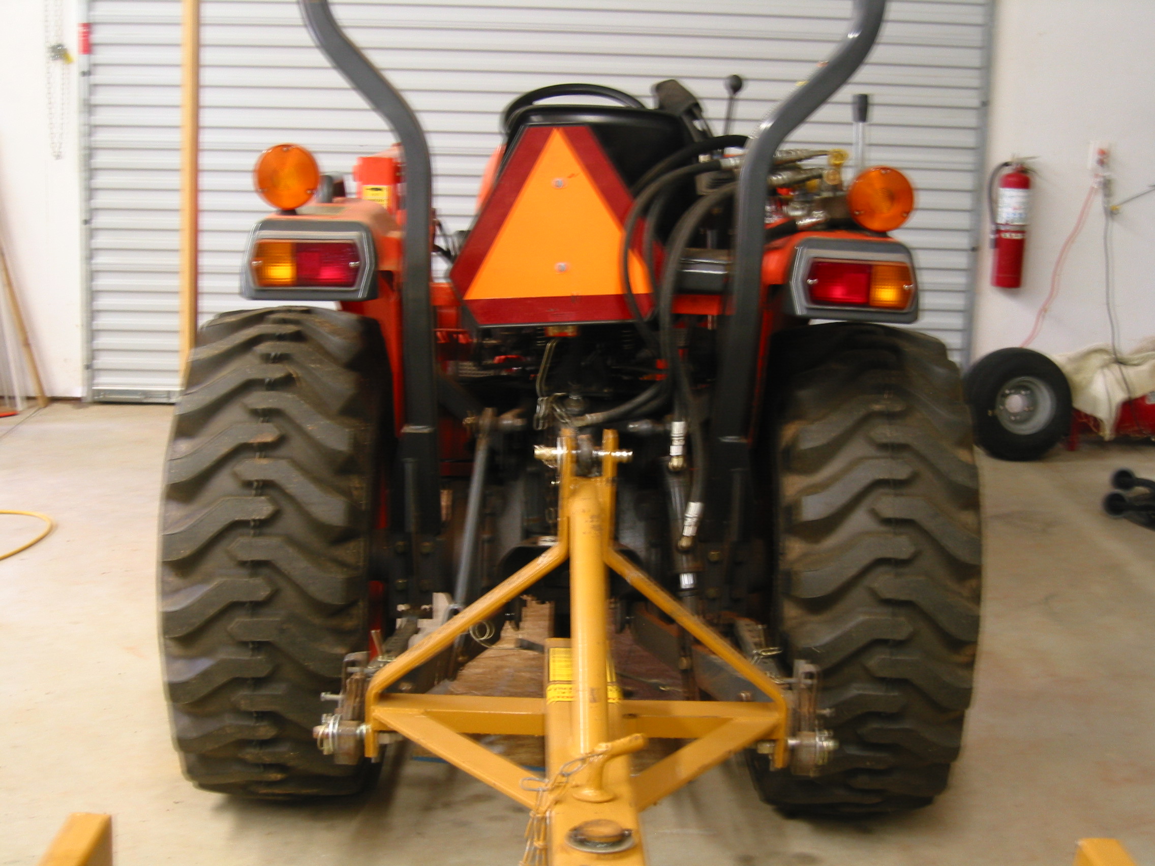

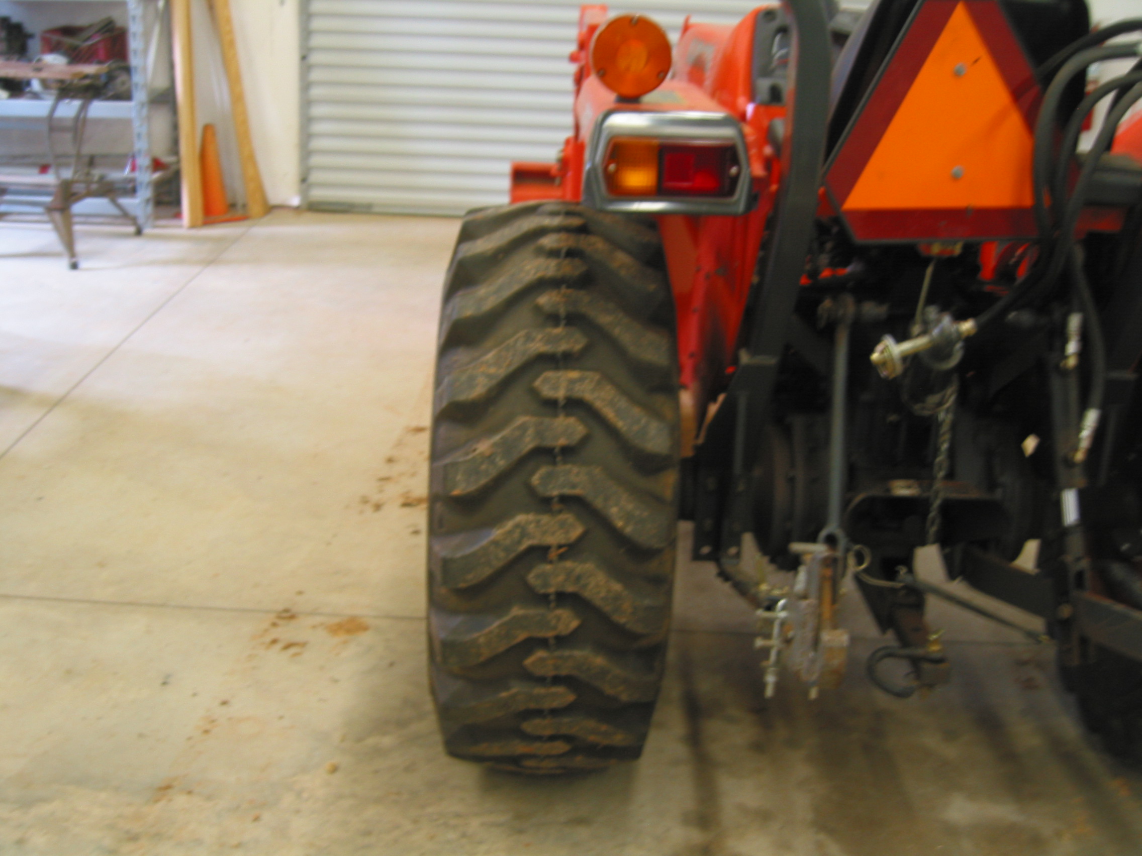

Well - I got the 2" spacers on. Dealer only charged me ~$40; money well spent for me. Here's a pix before and after.

Money well spent indeed. Good deal! My dealer wants $100 just to pick up and deliver not including any work.
