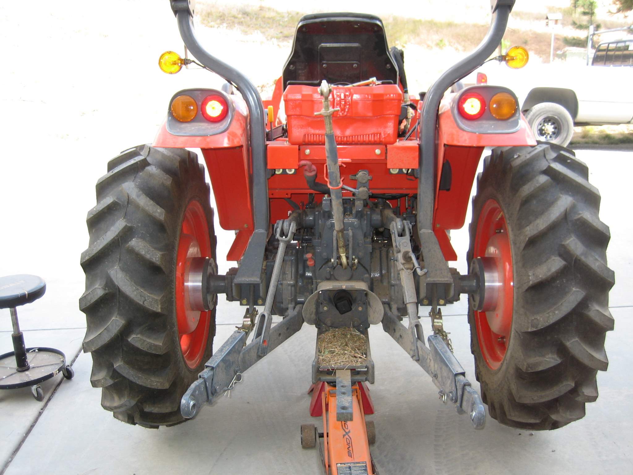

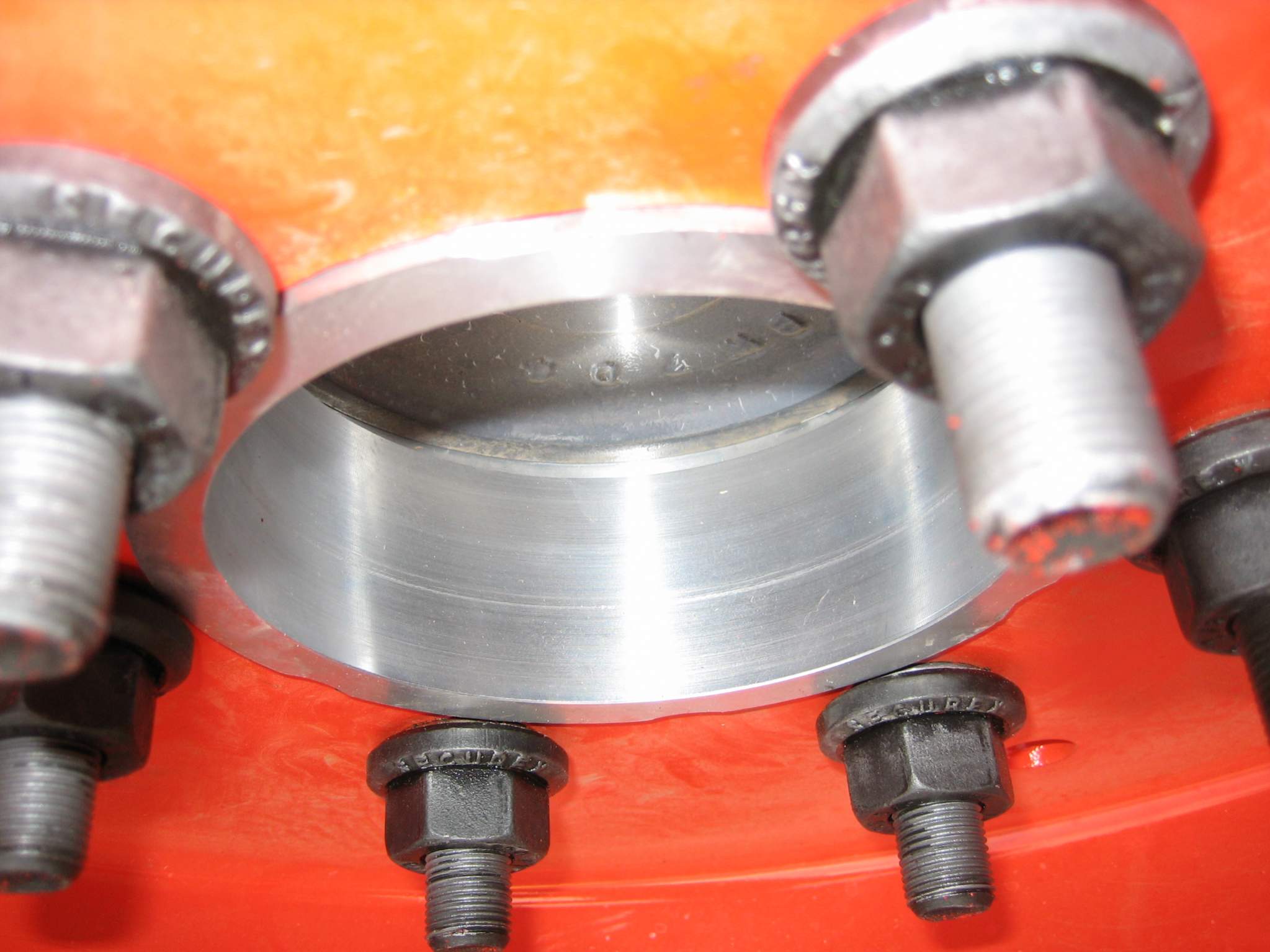

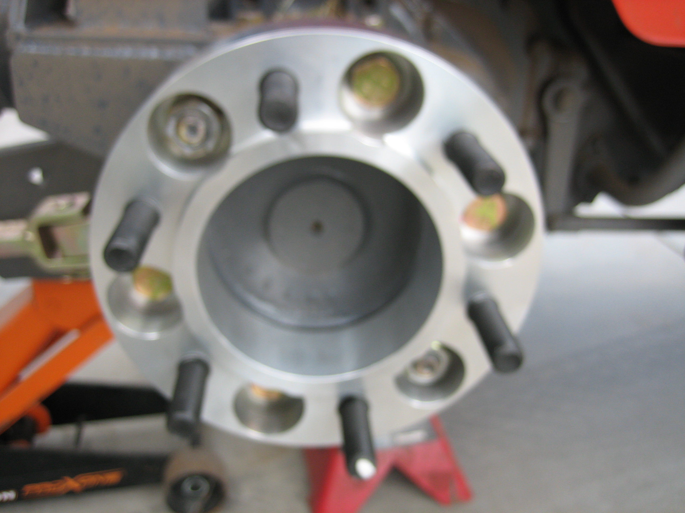

I just installed my 2" rear aluminum wheel spacers and I can't be more pleased. I got them from wheeladapter.com for $400 incl shipping. You just bolt them on and then bolt the wheel to the new spacers. No studs to remove. Kioti hubs have two male studs and four female "holes". You wind up with six male studs. They had never made a set for a Kioti so I measured everything and hoped for the best. Very nice guy to deal with.
I also checked out bro-tek.biz. He also seemed like a good guy but he wanted $570 incl shipping to make them out of steel.
Now I can get the tires filled.

Will you post a picture from the side showing the rim and hub (the full rim)
   / Wheel spacers on a Kioti
Do you mean the Kioti hub or the wheel spacer hub?
   / Wheel spacers on a Kioti #5
one of the whole wheel tire hub and then one of the hub, please
These are the best I can do with the wheel mounted. Taking it off will require me to charge you for a hernia operation. :D

Don't put spacers on the front. To hard on the bearings.
My owners manual says not to even reverse the tires on the front.
Nice job on the back wheels the tractor will much more stable.
