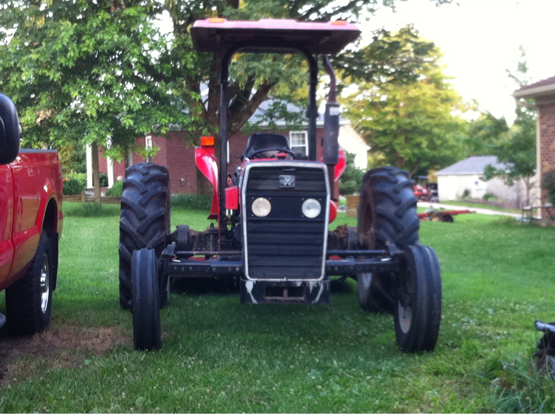

I put the spread on mine. Just need some Massey suitcases.
