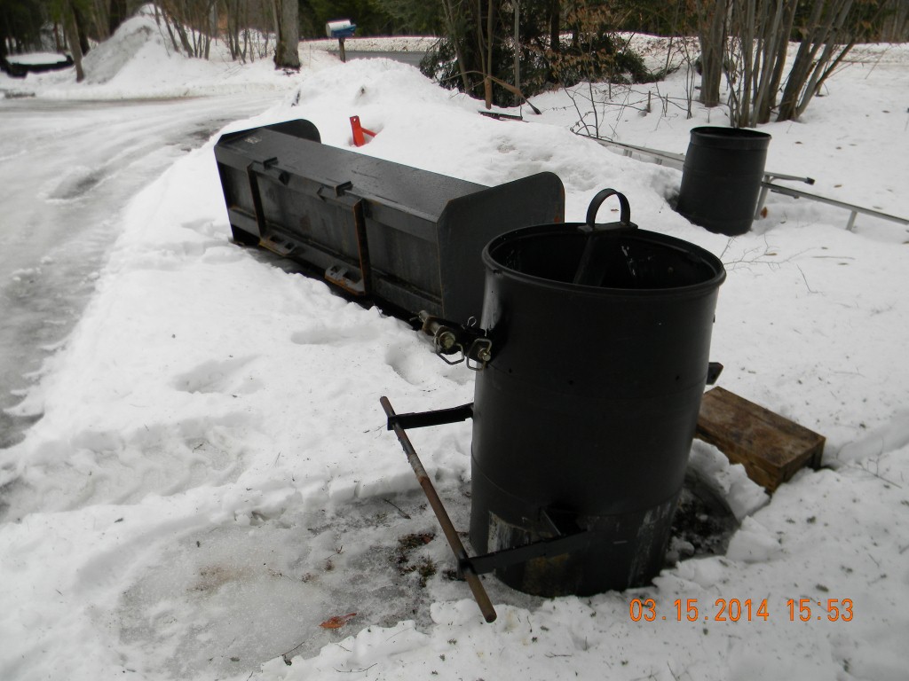

i HAVE A TC 29D AND WAS WUNDERING ANY KNOW WHAT SIZE WHEEL SPACERS I SHOULD USE/? ALSO BUILDING A COUNTER WEIGHT BOX FOR LOADER WHAT WEIGHT SHOULD I SHOOT FOR? THANKS:confused2:

Tractordata list your rear lift at 1625 lb. Your TC29 is about the size of my Mahindra 2615. I made a rear ballast out of a plastic 55 gallon barrel (attached) and filled it 3/4 full of redi-mix. Estimat its between 850-950 Lbs and it worked well for me. My loader lift was about 1200 lb.
