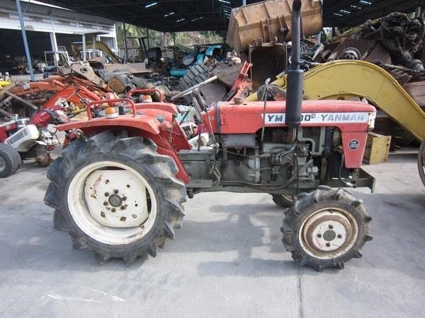

I'm probably not using the correct term. I'm referring to the square plate in the rear wheel. I've heard it called a dish as well.
It can be removed & flipped. Don't know the exact measurements, but I think it gained 4+/- inches of stance. 85379298.jpeg
/ wheel spacers? #23
You just talking about the rims then. Just swap tires from one side to the other. I think we all run ours in the wide stance already. There still pretty narrow.
