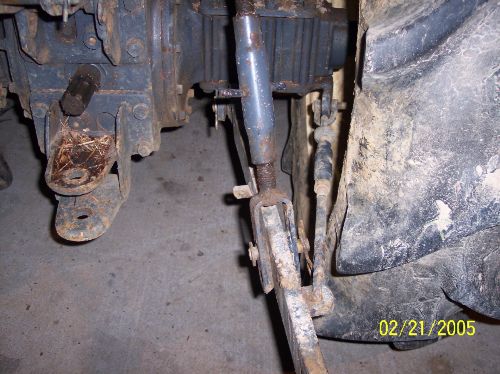

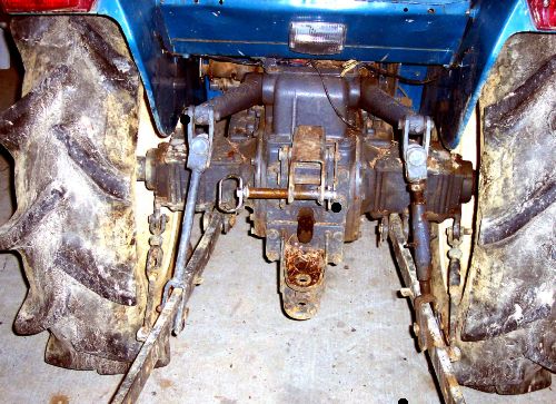

Has anyone ever heard of placing a spacer on the tractor before mounting the wheels to create a little wider foot print? I wonered if this might be a cure to my problem of the lift-arm braces rubbing against the tires.

   / Wheel Spacers?
See if this works.

   / Wheel Spacers?
Close up picture

   / Wheel Spacers? #7
Swap your tires side for side. That will put the the wheels to a wide position.
   / Wheel Spacers? #8
Those arms are atraight. I have heated them just past the tires and put a slight bend. That can give you some clearance.
   / Wheel Spacers? #9
It looks like your turnbuckles are a lot longer then mine and mounted further down the lifting arms
