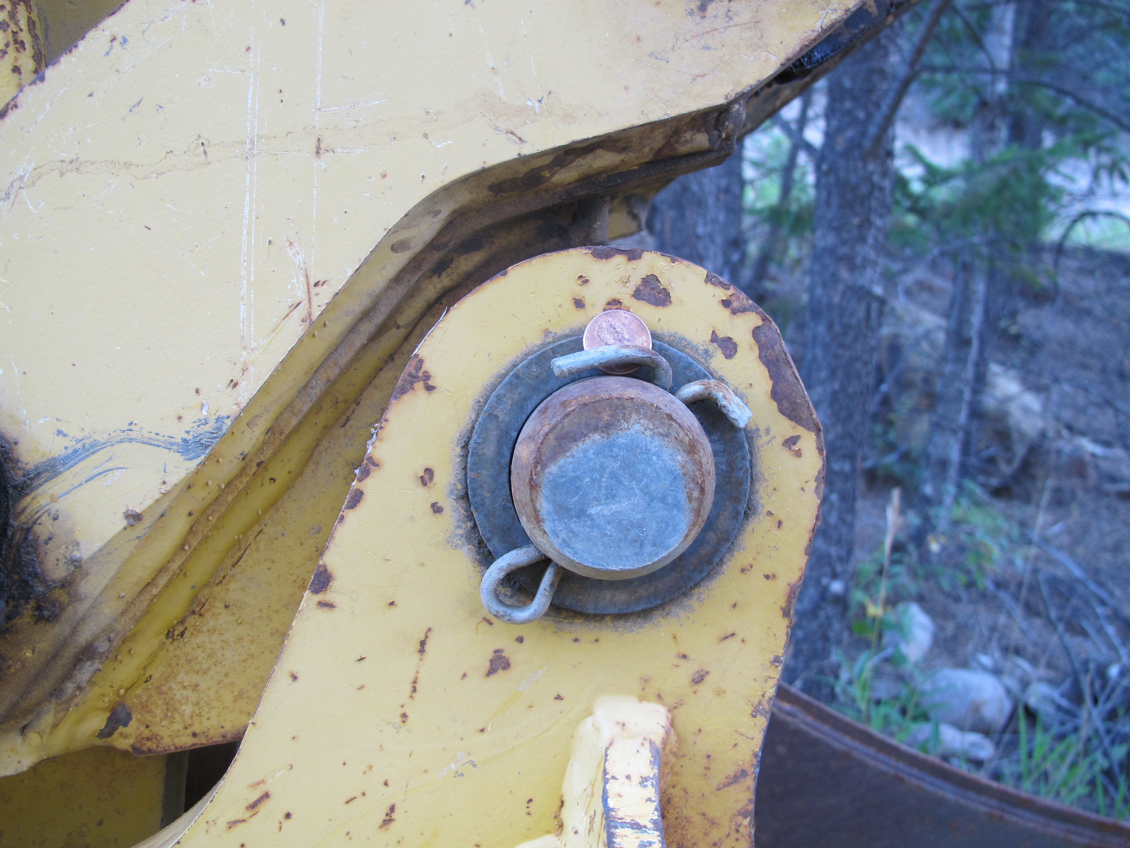

But you've put your finger on it....the thing that really stands out between utility tractor or TLB and a commercial duty machine like the JD310 is that the parts and pieces on the commercial machines are just hugely massive. The HP isn't all that different, both worlds run the same hydraulic pressures, and they have the same controls - so the stresses iin the parts are bigger but still understandable.
The big difference is in the way they are built. The shear size of the parts, of things like axles, backhoe pivots, loader pins, and bucket wall thickness, metal for steps, just everything. Even cotter pins are too big to bend with pliers, they must hammer the legs over. I've no idea how to undo one. See photo below.....
The radiator on the 310 has enough steel on the sides alone that I doubt a person could lift it out by himself. Taking a leaky cylinder off to rebuild it is easy - exactly the same procedure as with any tractor - but does require a small crane to lift it into place.
The front end suitcase weights are one more example of this extreme overbuilding for commercial duty that dwarfs big 100+ hp tractors, or Kubotas own TLBs.
rScotty

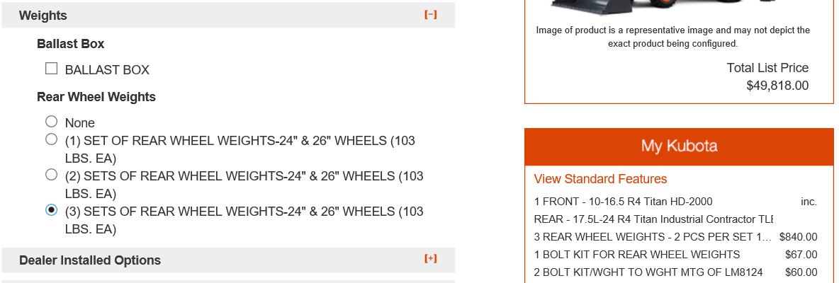

I was looking to see if the brush guard & hood protector parts for the Kubota's big TLB were available as accessories in Kubota's "Build it yourself" website (they aren't) ....
when I noticed that the kits for adding steel wheel weights are still listed.
Some people prefer wheel weights over loading the tires, and it's nice to know there's an option available. The price seems not too unreasonable at $280/set + $60 for bolts.
rScotty
That's interesting. I need to add weight to the rear of my 3301 as every time that I use it I feel like I'm on a carnival ride; I've never had the rears come off the ground on a tractor as much as I have in the last two years. Yet all that I can find are sets of 1000 lbs, at a buck per pound.
One thing that I didn't see though is how heavy the weights are; if I can get them for my existing tractor for close to what they would be on a new tractor
3 REAR WHEEL WEIGHT$378.00
1 BOLT KIT FOR REAR WHEEL WEIGHTS$33.00
I am going to pick up a set.
