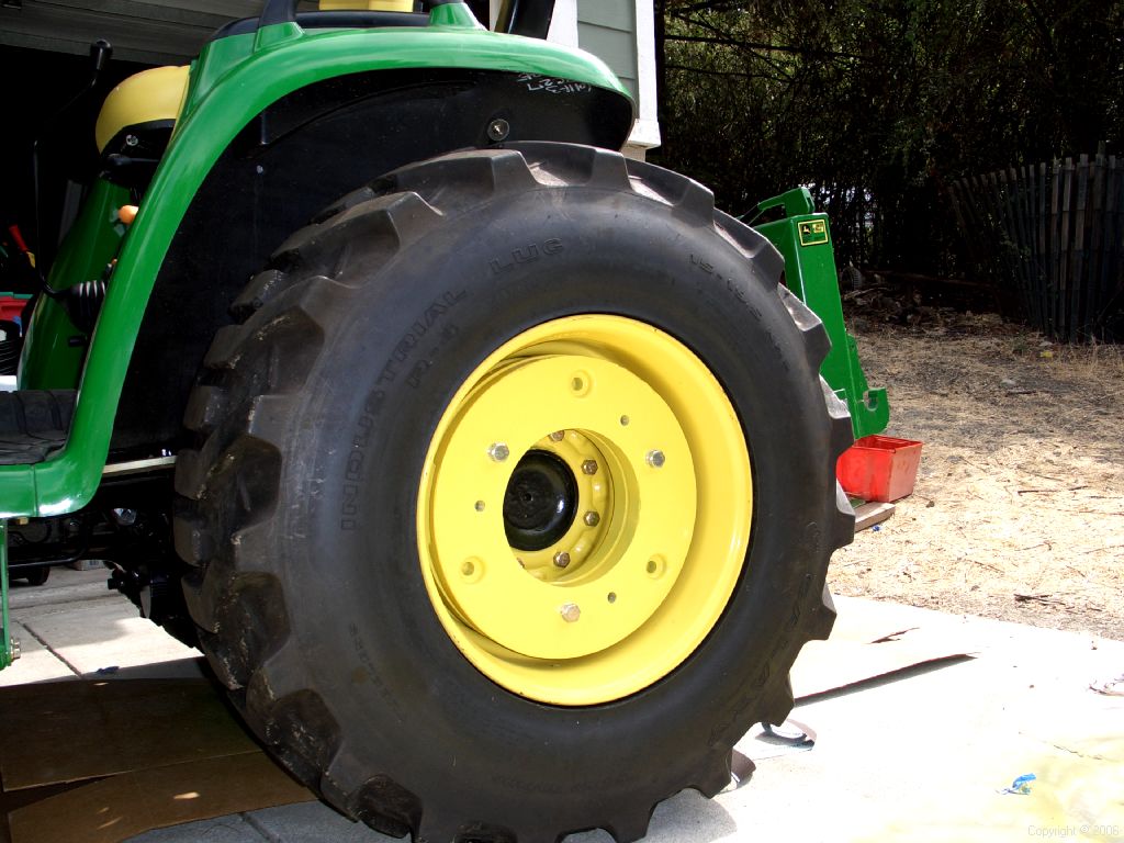

NYBOB, I hope you have better luck than I did with trying to get weights for my 3520. I'd have to look to see what I ended up with total per side. It takes one starter weight and then you can stack as many additional weights as you desire. After two though you will be getting out past the edges of the tires. I went with the starter and two additional weights per side and then another custom weight to give a finished look. I've been told by some that these are not the correct weights for my wheels. Who knows???
If you have any questions feel free to ask. I'll help as best I can. Oh, one more thing....... no one seemed to know how the weights mated up to each other or what bolts I needed either. I finally figured it out, it was like a puzzle.
Sincerely, Dirt
Here are some pics of the 3520 in several stages of adding weights.
Below pic: starter weight install.
starterweightinstall.jpg - Image - Photobucket - Video and Image Hosting
Below pic: starter weight installed
wheelwithstarterweight.jpg - Image - Photobucket - Video and Image Hosting
Below pic: starter weight and two add on weights
JDcompleteweights.jpg - Image - Photobucket - Video and Image Hosting
Below pic: Custom center weight
customcenterweight.jpg - Image - Photobucket - Video and Image Hosting

Dirt, the starter weight you have are the correct weights for your tractor. The starter and additional weights are the same so the "extra" weights that you have probably aren't standard fare. Deere manual does state that 3 weights per side is MAX but I don't know if that is due to them protruding from wheel edge or from excessive weight hanging on rim as the prescribed method of install involves spacers between first weight and rim to allow access to wheel bolts for torque checking or removing wheels with weights on, although the combined weight may make the process overwhelming unless you have a wheel dolly. The installation hardware needed for the R-4 installation is quite simple: M16 x 110mm bolts/nuts/washer (6) for the starter weight to bolt onto rim, LVU10300 spacers (6) to fit between weight and wheel, and M16 x 65mm bolts (3) for each additional weight to be installed. Cost is high, no question but unlike liquid ballast, which is cheaper, can be recaptured and easily removed or moved to another tractor. Two pictures below shows: (1) first weight installed with spacer, which allows access to lug bolts, and (2) second weight installed. I have 3 per side but don't have picture of 3rd weight installed but it looks the same except is flush with sides of rim.
You can see that there are numerous holes in the weights. The recessed holes on the outer edge are for mounting the weights onto rim. This gives a good flat edge to stack the additional weights to. Look closely and you'll see that on each weight, there are three holes tapped for M16-2.0 threads. These holes are intended to receive bolts which mount additional weights. Finally, the 3 holes without the recess that are not threaded are the holes for the bolts that will then bolt onto the threaded portion of the previous weight. Even though they protrude, you will notice that the bolts fit nicely into another recess on the flip side of the weight. Sounds confusing, it really isn't when you have the weights in front of you.

Superduper, thanks for the explaination and pics. It looks like maybe the only thing I missed out on is the spacers between the starter weights and the wheels. I understand how the recesses and bolts line up and everything after doing my install. I'm OK with the weights I ended up with.................I like my stuff a little different than norm.
Sincerely, Dirt
