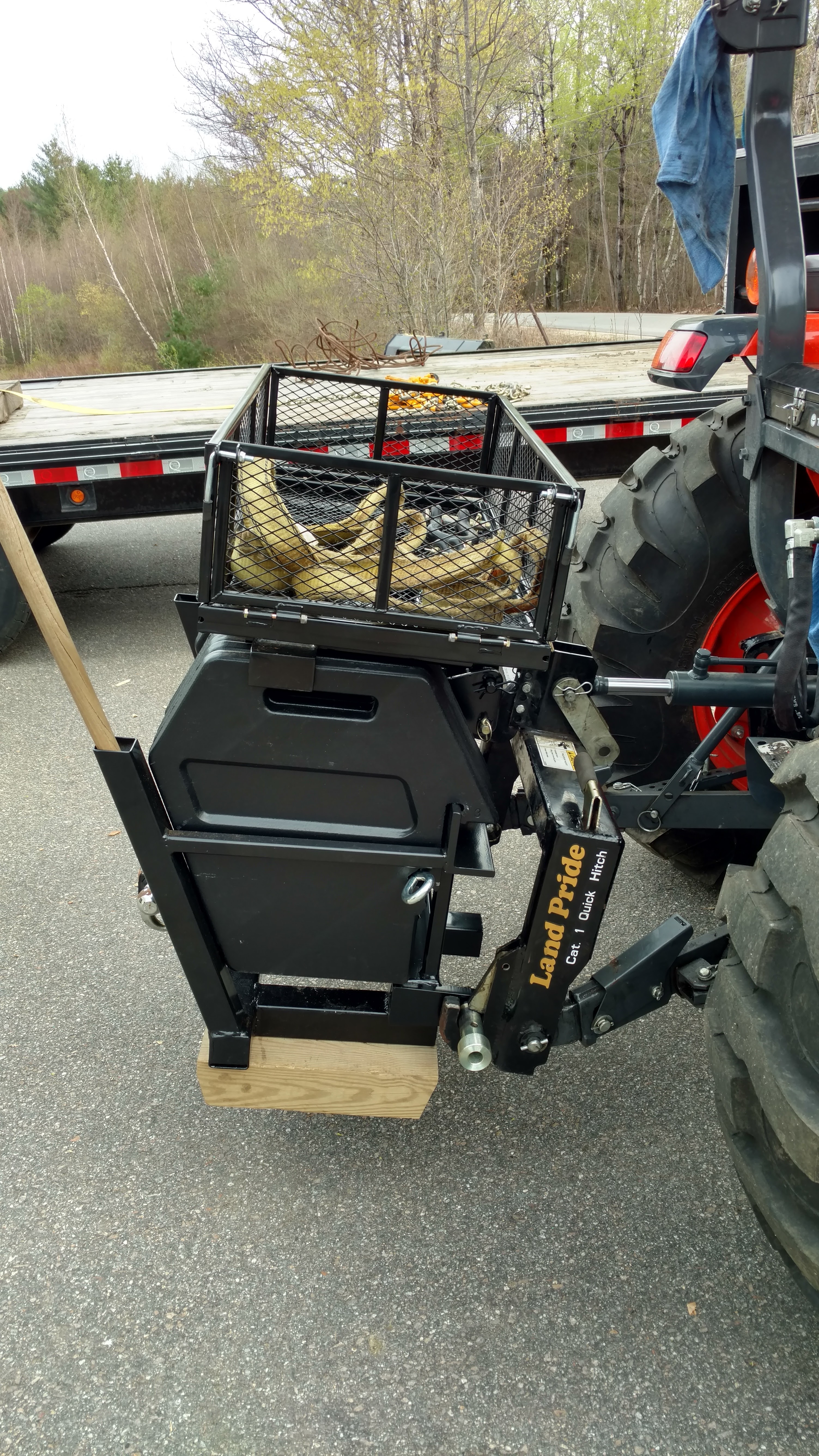

I have rim guard, one set of wheel weights, and 1200lbs of 3pth ballast. My 3pt ballast is QH compatible so it's easy on/off and compact since I'm in the woods a lot. Something big like a box blade would never work for me.
Might consider a compact ballast box as it can be removed when you want you tractor to be lighter... :2cents:
Here is my build thread: http://www.tractorbynet.com/forums/...-poorly-planned.html?highlight=Fraken-ballast
   / Wheel weights for a Kubota MX5800 #8
Good stuff Luke. My QH ballast box doubles as my suitcase weight storage rack. Very handy for those projects that only need ballast for a few minutes or all day. :)
