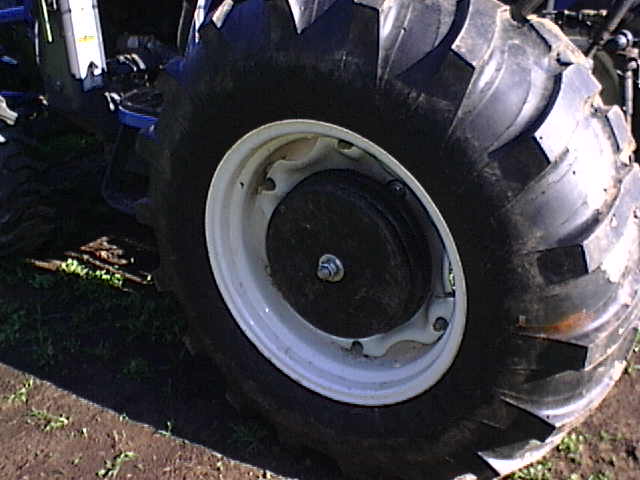

Make some of these to put on it.

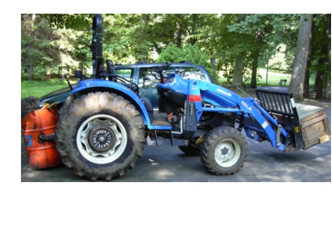

If you are like me (can't weld), try buying EZ Weights. The brackets cost less than $40 for the pair and you can buy new or used weight plates locally. They are very easy to take off and put on, well thought out, and well supported. They make brackets for everything from lawn tractors on up. Picture of mine attached.
Mark

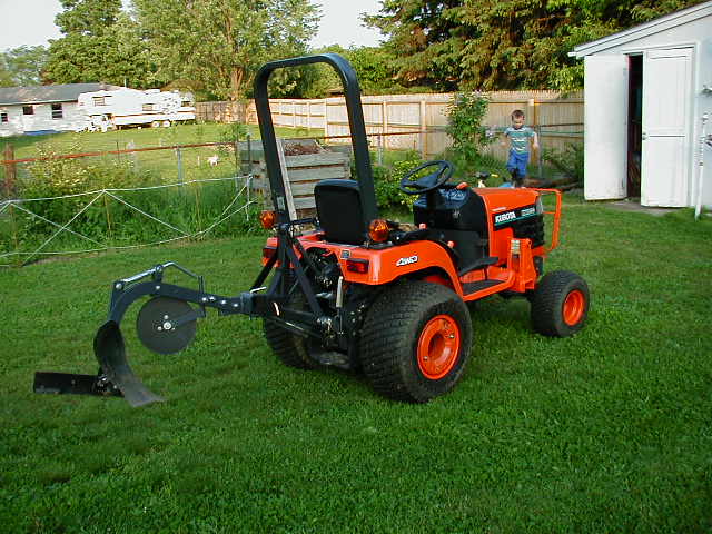

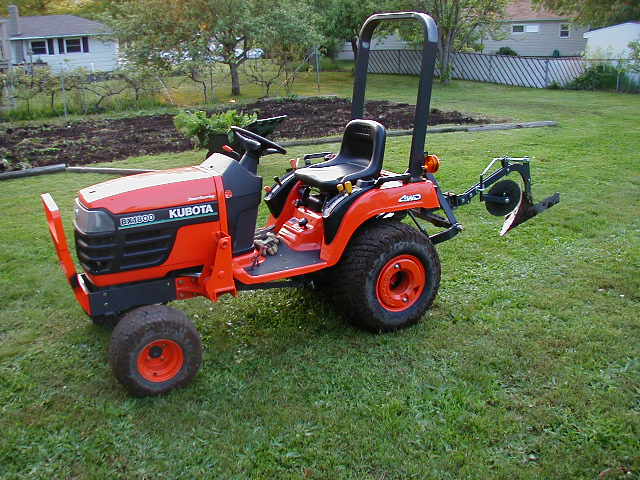

I actually did exactly what you are contemplating. I took my old Bolens weights off my Cub Cadet 1811 re-painted them from white to Kubota Orange, bought slightly longer carriage bolts and bolted them on my BX1800.
I like having them on for a little extra traction. I did not have my tires loaded, so this gives me some extra traction. I also have a rear ballast box for loader work, but when plowing, I can't use that so these help.
You can't read it in the picture, and my camera no longer works since my son accidentally dropped it, so I can't get a better picture but for what it's worth, here is what they would look like.
   / Wheel weights on a BX #8
Here is one more view. If you don't get too close, you can't tell the difference!
