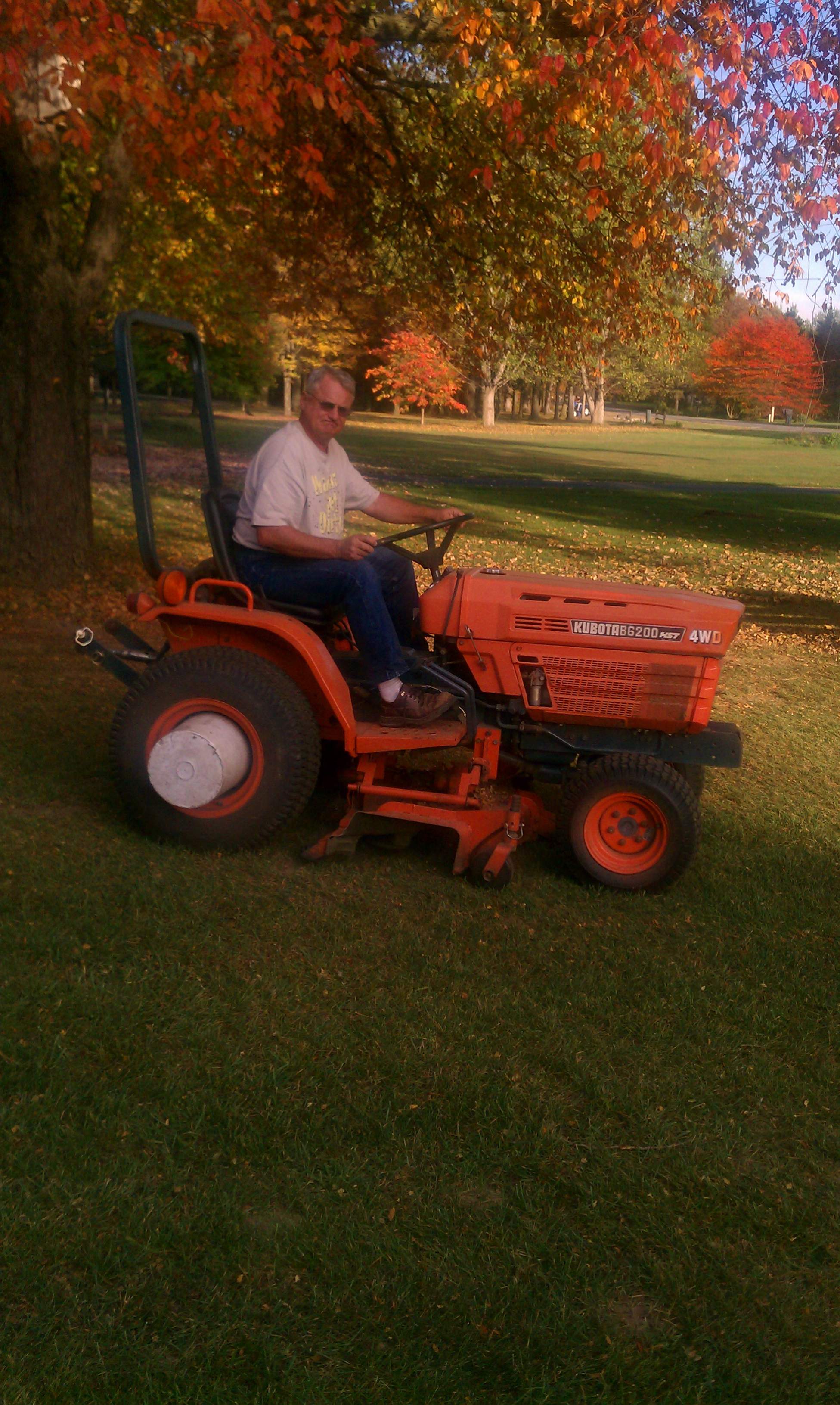

For anyone wanting to add weight on the cheap, here's what I did on my old B6200.
The rear wheel center disc is just the right size to fit a plastic 5 gallon pail onto if you cut the plastic lip off. And there are three 9/16" holes in the wheel rim that are not lug nut holes.
So I took a wheel off and made a 1/4" plywood pattern to match the center hole for the axle and the three holes. Then I used 1/2" threaded rod through the pattern, and welded some scrap steel on the other end that would be inside the bucket so the rods wouldn't turn when I torqued the bolts onto the wheel.
Each 5 gallon pail takes a 80# bag of redi mix. I poured the concrete and imbedded the threaded rod with the plywood pattern attached and let them cure for 3 days.
It is practically impossible for me to mount the 80# weights by myself but it is easy when you remove the tire/wheel and mount it on top of the weights, then mount the weighted wheel back on the tractor.
Not as good as Rim guard or store bought weights but I was able to add 160# of weight to my rear axle for about $20 and some time. The buckets can later be removed but I left them on. They do stick out to much for mowing but work great during the winter. If you wanted it to stick out less and willing to go a little less weight, you could put a dead space on the bottom of the bucket before you pour concrete and then remove the buckets after the cure.
