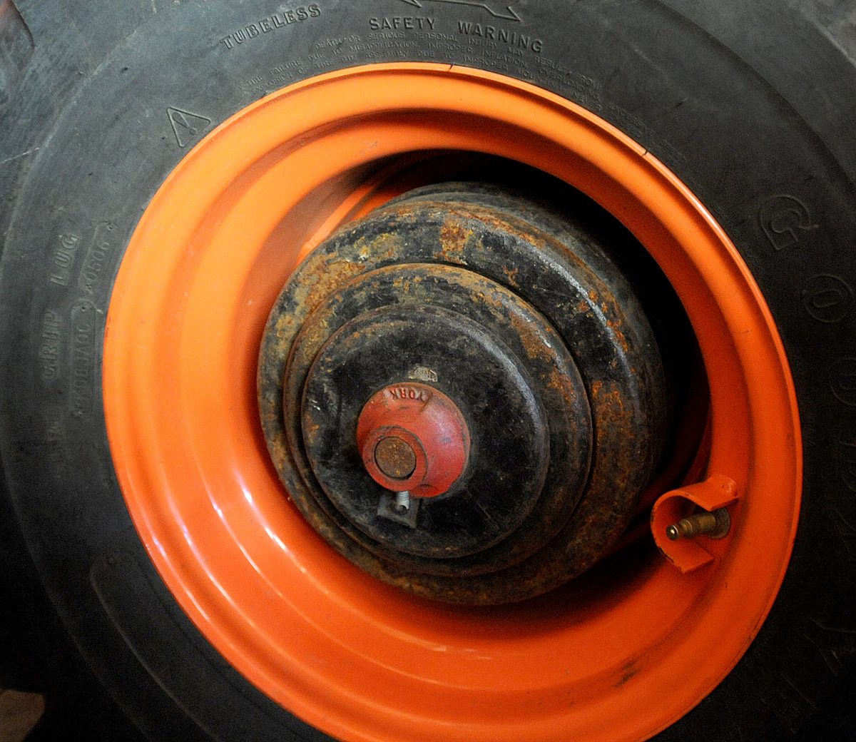

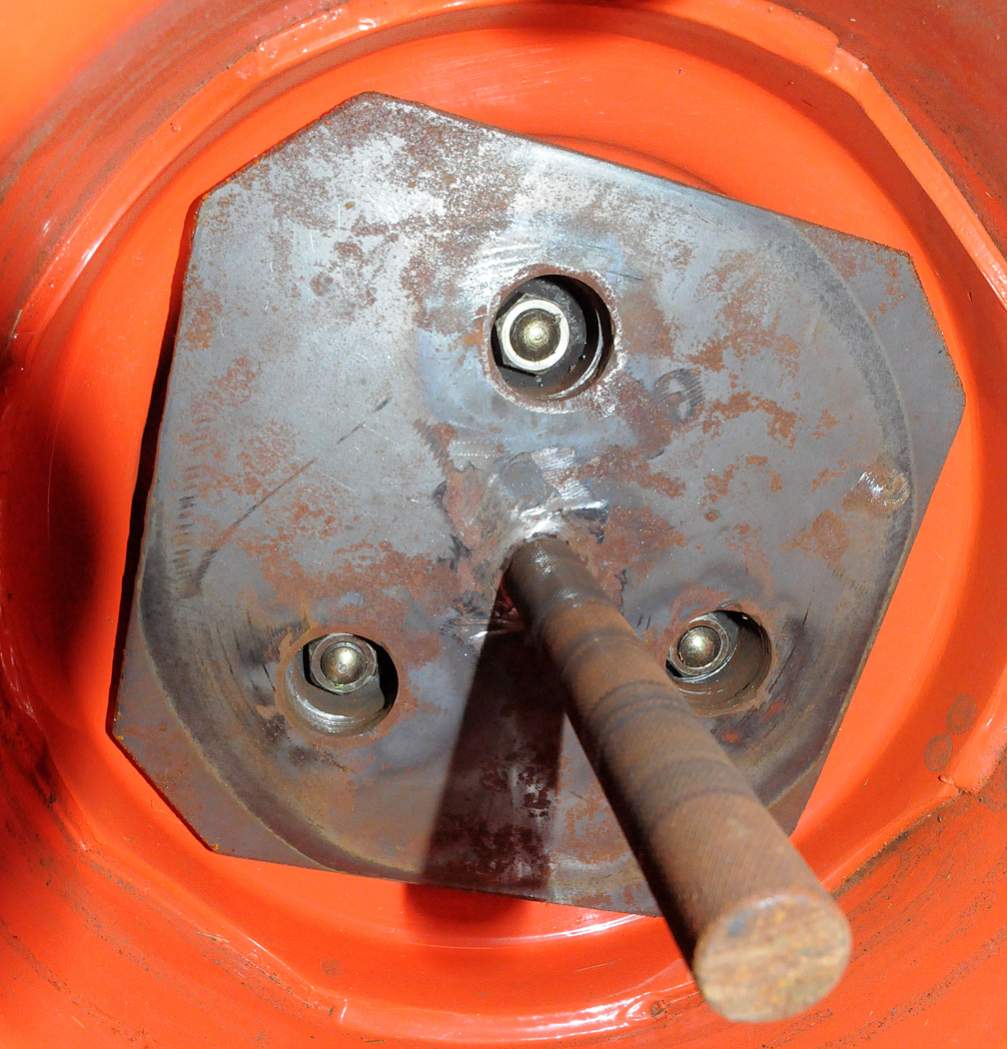

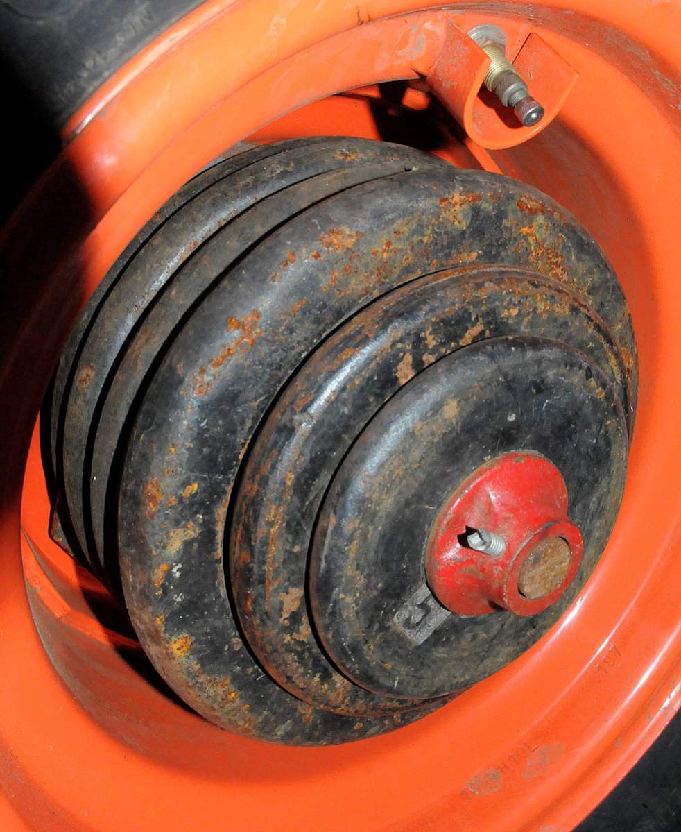

Here is the picture of the wheel weight holder I came up with. The piece of flat plate with the holes is 1/4" a well as the pipe you see the studs in. The rod in the center is 1". The rod goes through the plate in the center and is braced in the back with more 1/4" plate. I wanted to make "room" behind the plate to clear the other wheel bolts and also to make room in the back of the plate to brace the 1" rod. I will have to come up with a better way to secure the weights onto the rod as the clamp is from the weight set that I bought at a yard sale and I'm worried it might get loose some day. Hope this helps. When I take the thing off the wheel during my next hydraulic filter change I will take more pictures.
Very nice job!
I wasn't able to find the plates used otherwise I was thinking along those lines myself.
Wonder if by drilling a hole part way in the shaft where your end clamp bolt goes you would feel better about them staying put or a bolt clear through with a nut or cotter key?

You could buy the plate at a local steel place. If I remember right they were 11"x11"x1/4" and I cut the corners off with the angle grinder and a cutoff blade. The holes were cut with a hole saw in the drill and the pipe I used was 1 1/2" ID 1/4" wall mechanic's pipe. I should have used 2" ID so the socket would fit in there easy instead of barely.
I have thought of trying to drill the hole in the shaft you mentioned. Either part way or all the way through and use a pin. Will do that as soon as I run into some problems with current (lazy) setup.
edit: I forgot to add that if I had filled tires that would be 230lbs of juice per tire. Now I only have 115lbs of weights per side and if I had custom cut steel It could probably reach about 200lbs.
