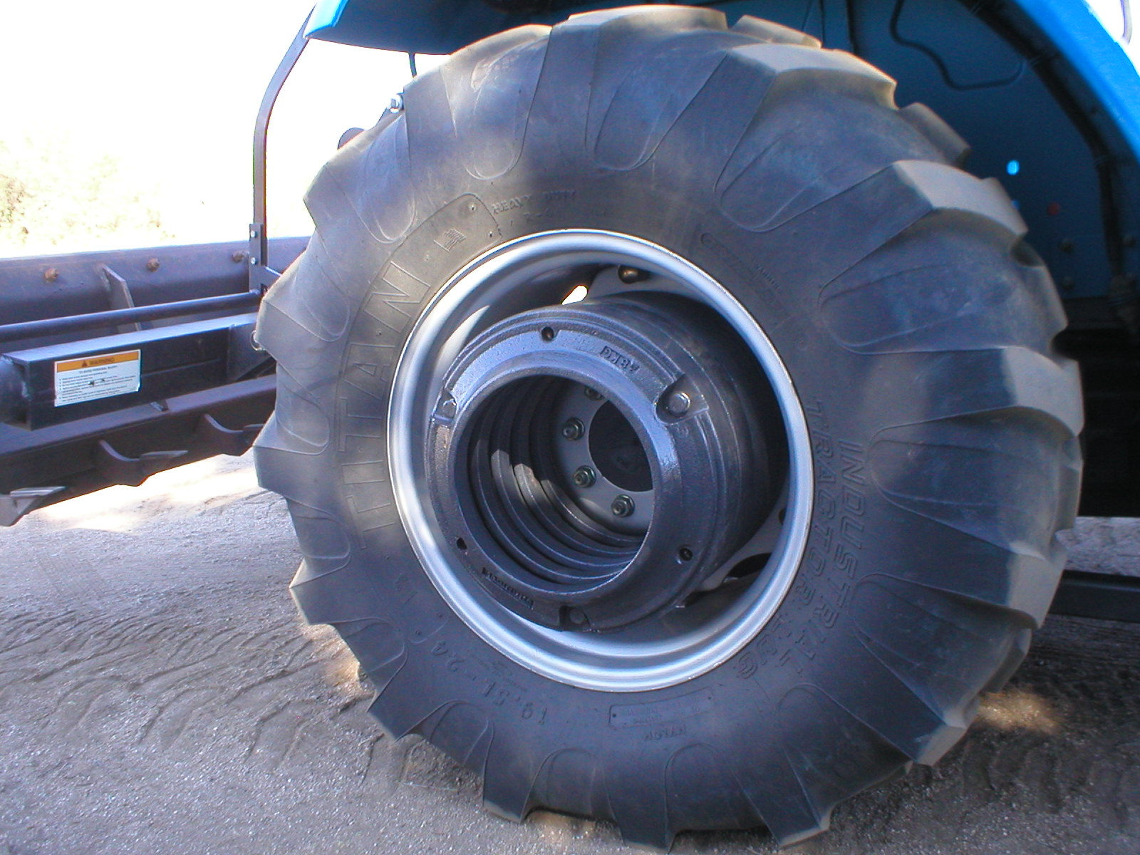

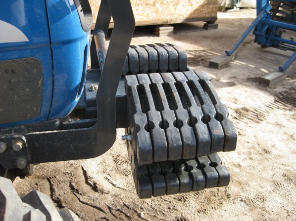

Any reason not to fill the tires? :confused3: A lot less $$$ than iron and heavier. :thumbsup:
On my 75hp tractor I have filled tires and 6 sets of weights to be able to get the maximum capabilities out of it.
I doubled up on front weights as well. Much nicer vs having the loader on for field work.

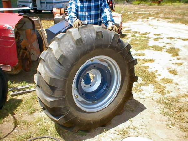

No I have 2 300# weights on each rear wheel on a Branson 8050, 65 pto hp, I have considered getting at least one more for each side.
I do not like filled tires, over the years I have decided that they are not worth the problem's and associated costs, also if you do any road work
liquid filled tires suck up a lot of horsepower and in rough fields the ride is terrible and then the problem's with flats and the cost and time for repairs.

I guess it depends on your conditions-situation. In my opinion, the tractor rides by far better with filled tires vs just air and the wheel weights. I have never had a flat in the 17 years I've been running filled tires, so not familiar with those problems, but then I'm running R4s so that I don't have those kinds of problems.
So you have actual wheel weights that weigh 300lbs each?? Are they industrial weights? I've never seen AG weights that weighed that much. Any pictures of those?

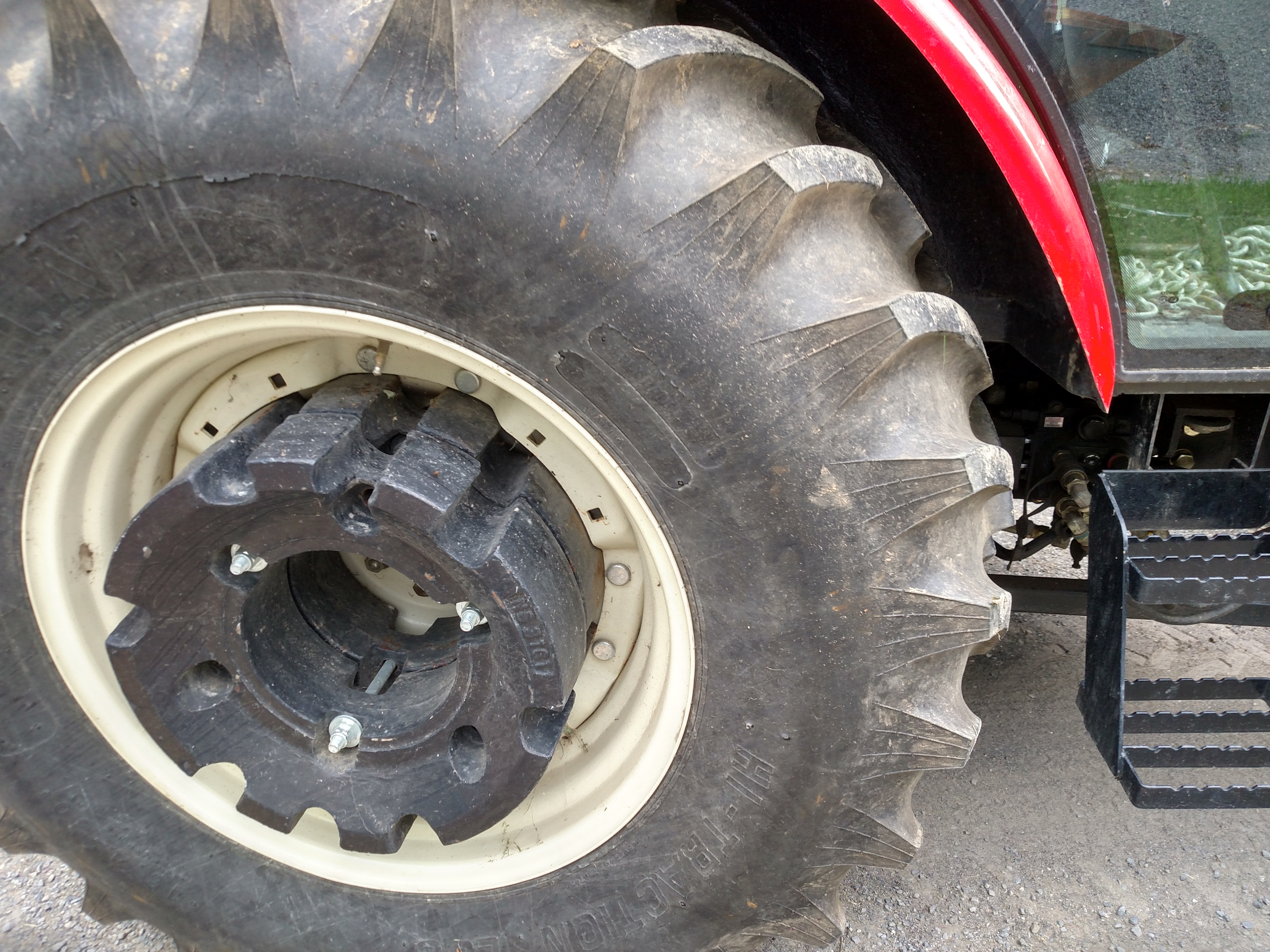

This is a picture of my 8050 with 2, 300# weights looking at the chart it seems that they are the same that would fit your tractor
Product Details - Lonestar Weights
this is my first attempt at a link it is to Lonestar weights, they list weights of over a 1000# the largest I have seen is 500#
As I mentioned I am seriously considering adding another 600-1200# to her, either one or two more weights per side, likely putting one on the inside of the wheel.

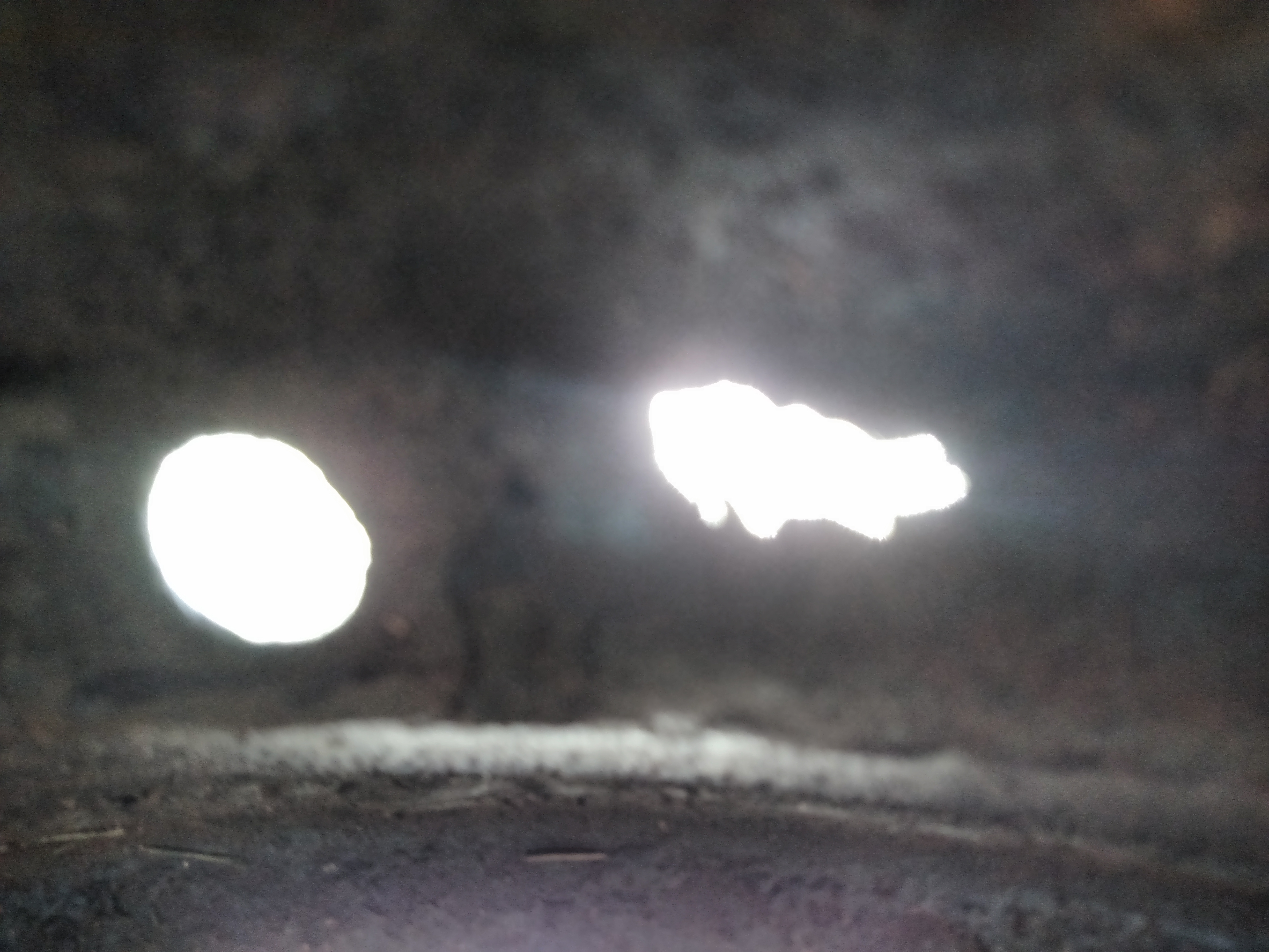

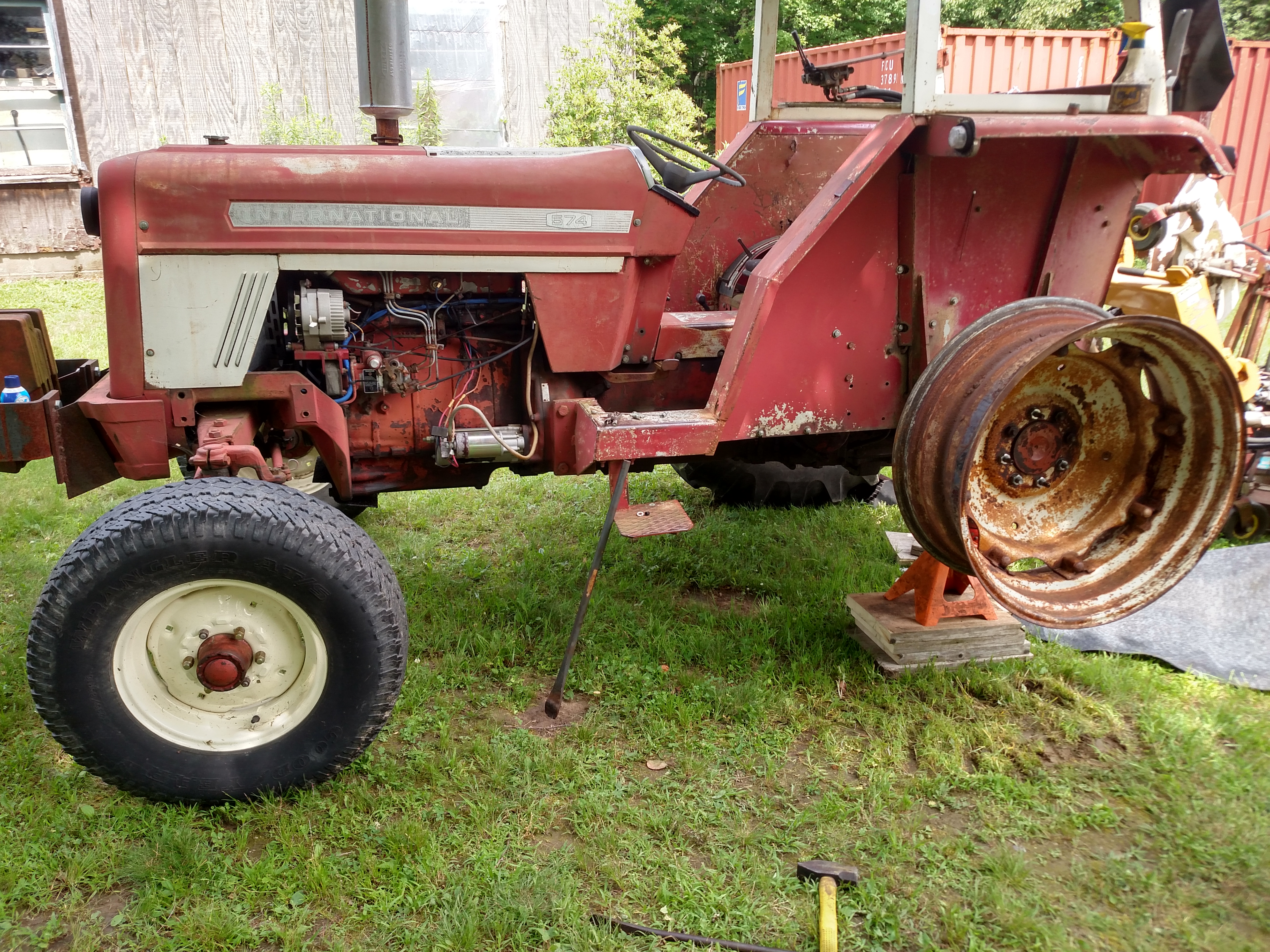

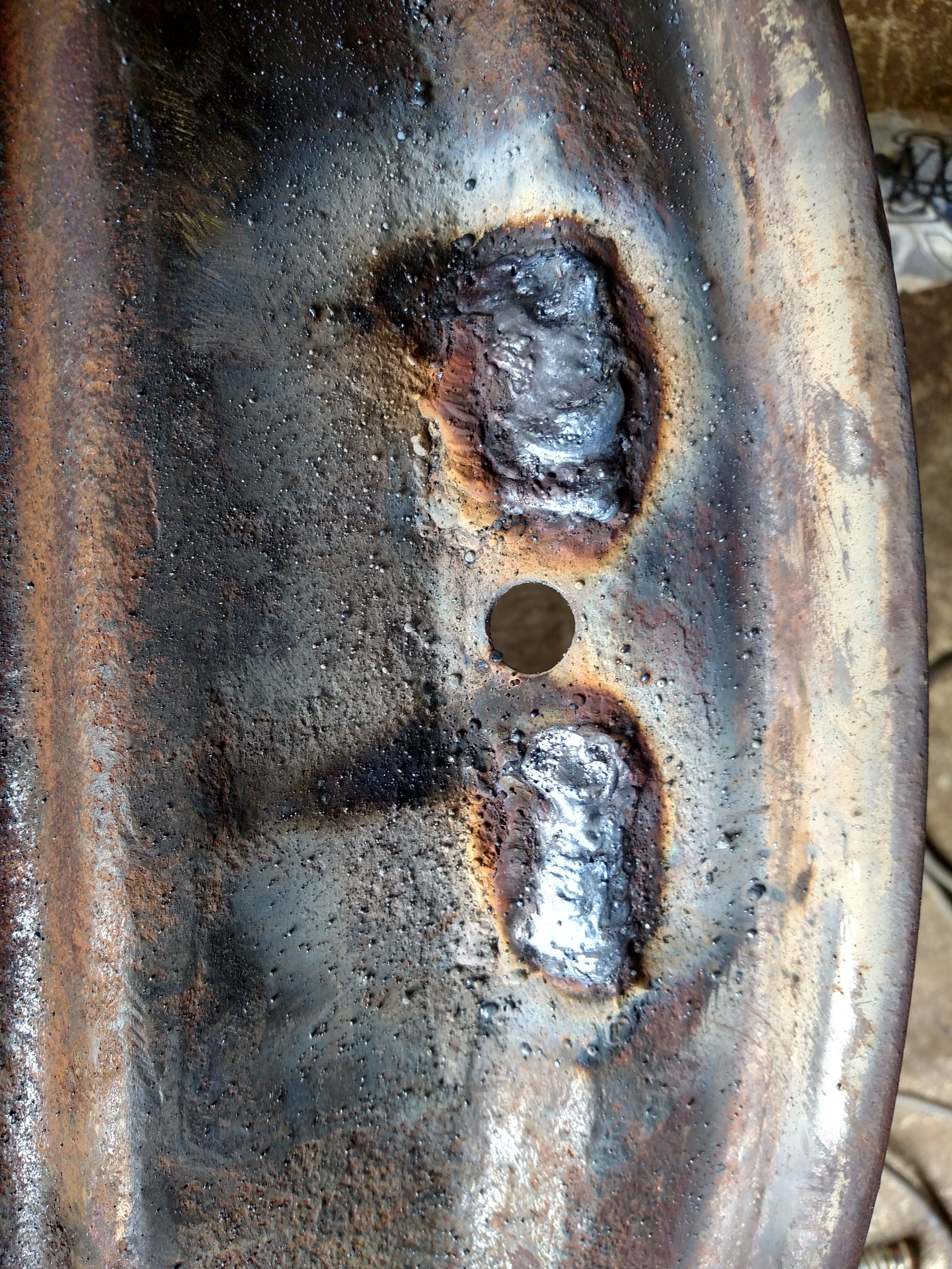

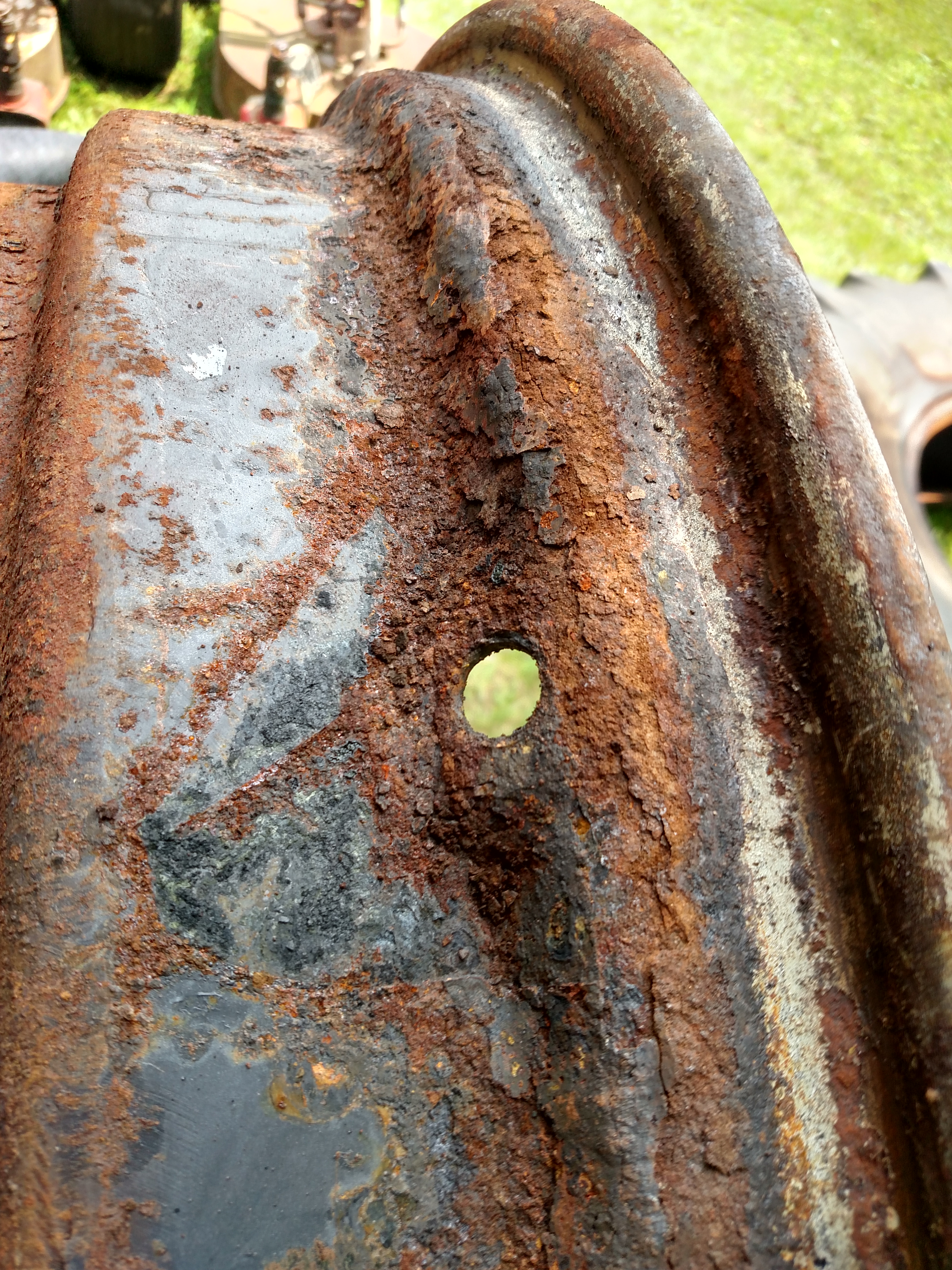

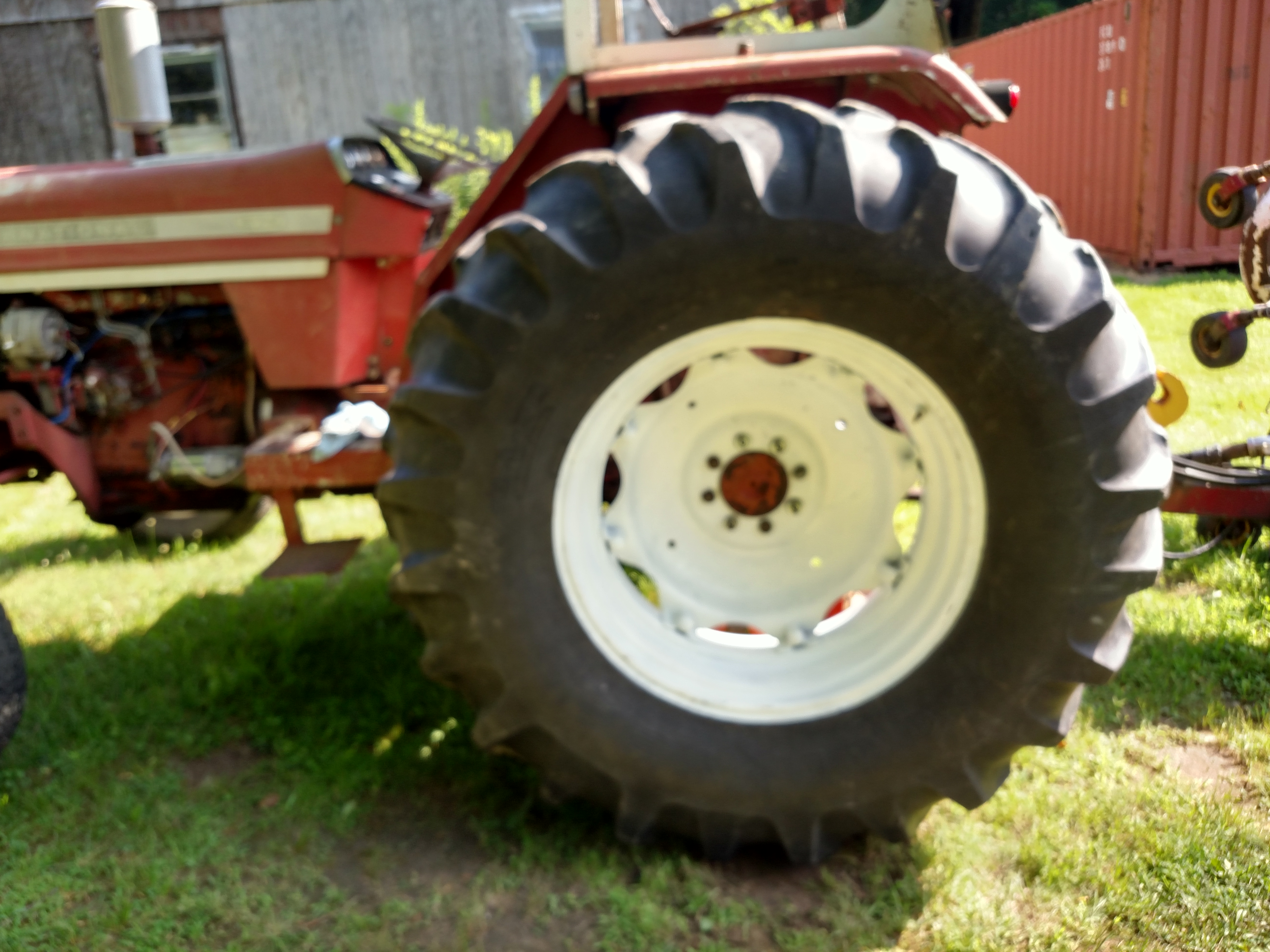

OK, I've had two flats on my yard tractors.
Did the repairs myself and went back with liquid on one (calcium chloride flake and water)
Of course it only took 4 days of wire brushing, welding up rust holes, grinding them back down, weld washers in for the valve stem holes, painting then remounting.
part of the repairs, this rim had been drained a long time ago and went back dry, it is a 18.4 x 30
View attachment rim 1.jpg View attachment rim 2.jpg View attachment rim 3.jpg View attachment rim 4.jpg View attachment rim 5.jpg View attachment rim 6.jpg
Over on the farm, 13 tractors some with liquid filled most not, a few flats every year. Usually slow leakers, if need be air it and get it moved or even go ahead and use it after its aired up.
Some times a gallon or 2 of slime and not even down an hour in time, if it's a liquid filled it may have dosed everything around with the fill fluid, or when you try to air it up the valve stem screws up, you end up being down for a day or two and now do you refill with liquid $$$$ again, the new tubes are half the weight of old and they don't last as long. Some of the older ones as soon as you start to work on them the rim is going to require repair or replacement so there is several hundred more $$.
So if low hours, not along old hedgerows and fences, never going to pick up any junk to flatten a tire, why go ahead and use liquid, any time I can possibly afford it I will use iron.
It is up to the owner what they want, there is almost no way that I would ever recommend liquid ballast for a tractor that has to be ready to work most every day. If it was mine and was going to mow my lawn or till a garden I might go liquid, because that isn't time critical. Others may feel differently they are certainly entitled to their opinions, I can certainly disagree and I've been around farm tractors for all my life and I'm 66 and I know what I believe in.

And I would NEVER recommend Calcium Chloride for fluid. Bad idea. No long term gain at all. I use WW. No tubes. This allows you to "plug" the tire if it has a slow leaker.
I've been around farm tractors for all my life. I'm 66 and I know what's practical and cost effective. :D
Lastly, your CC filled example lasted how many years before the disaster pictured? ;)
