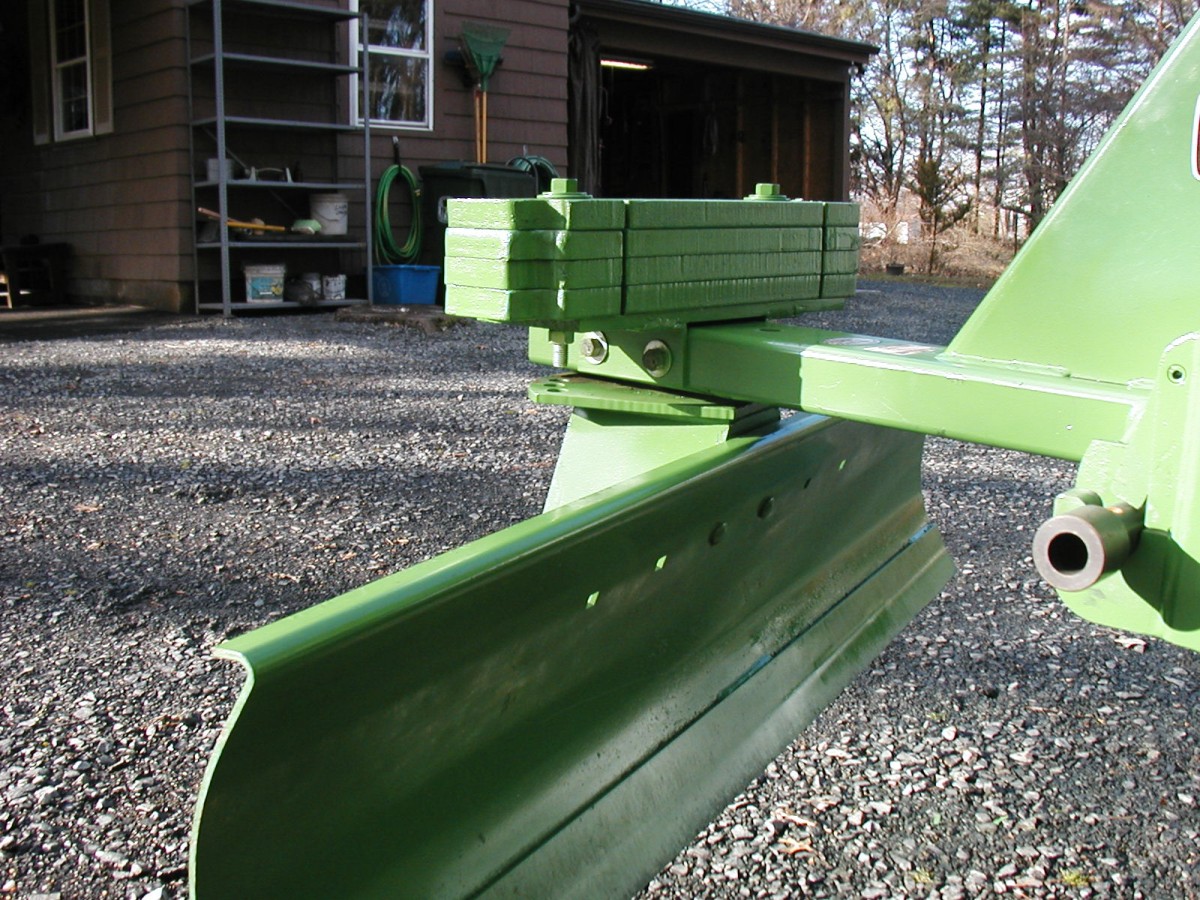

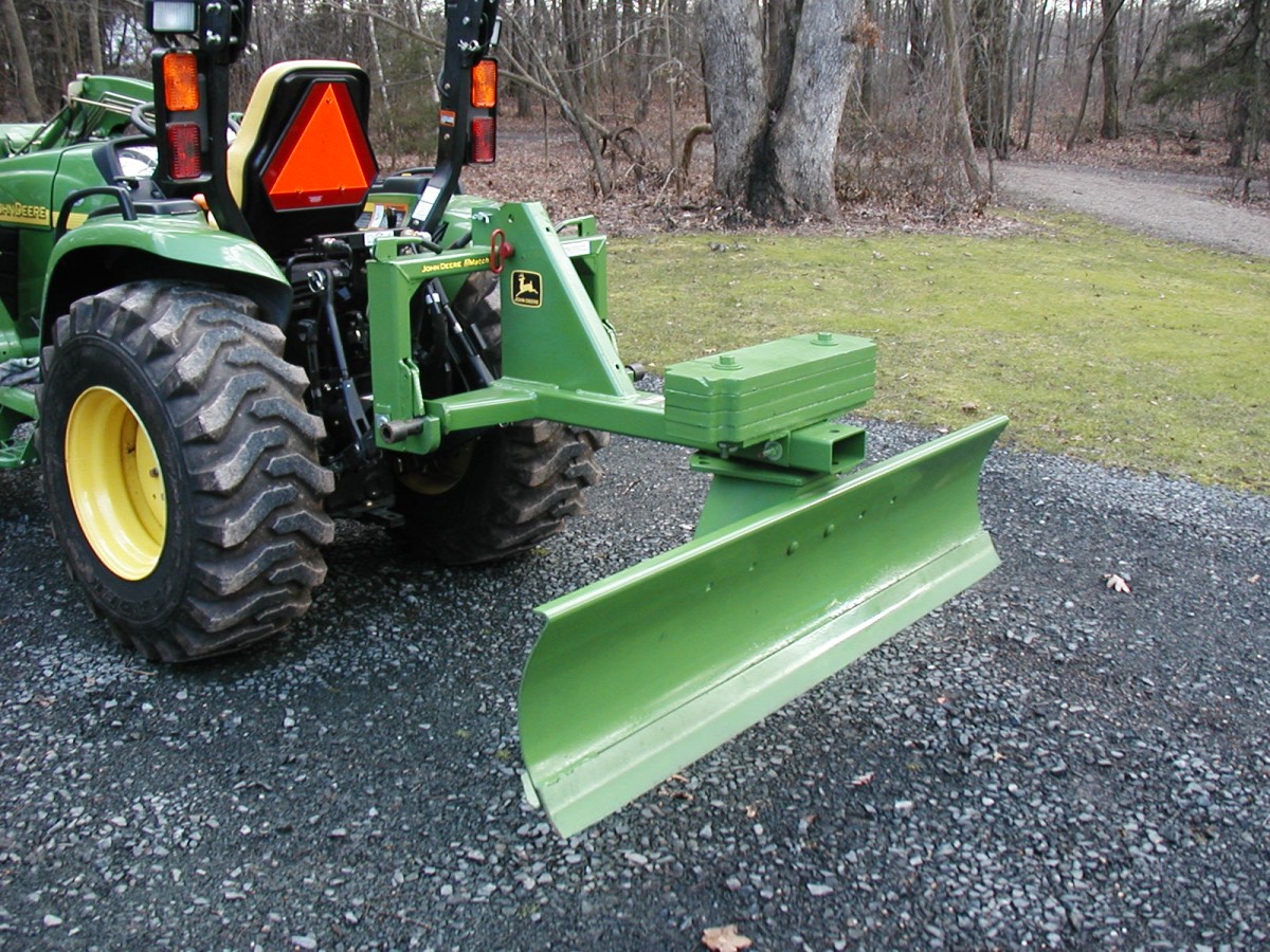

Maybe that ain't such a bad idea since I do a lot of plowing on gravel surfaces and thus a lot of raking in the spring.
Do you have any pictures of yours, this is what my 60" plow looks like with some extra weight on it to scrape better when back dragging trying not to dig in.

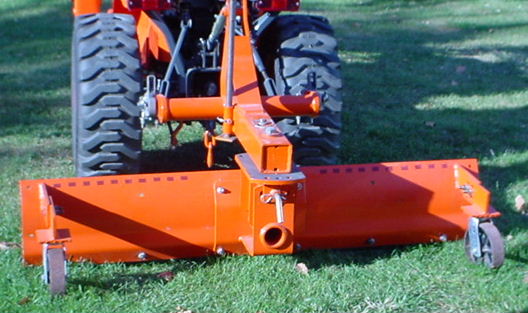

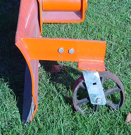

JB4310,
Here you go.... I think I got the wheels at TSC. I welded a bracket to the back of the blade then put a slotted bracket on the top of the castor so to make it adjustable up and down. I float the blade all the way down for weight and let the wheels carry it. Adjust the top link for a level blade.
I have a tendency to over build so it probably looks pretty heavy. Works!
BD
