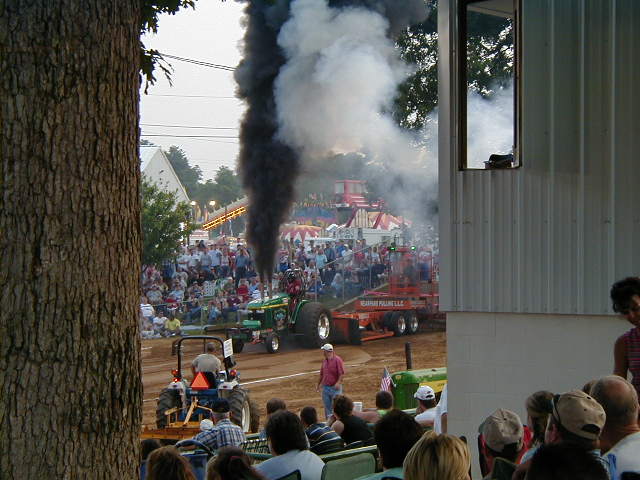

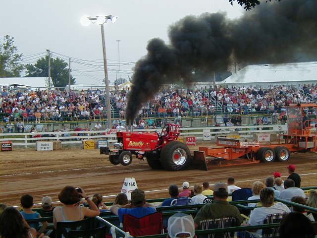

And someone may have mentioned it already (think they did) that when you get lots of black exhaust you're pushing your engine pretty hard (hadda pretend to reply to the topic /forums/images/graemlins/smirk.gif).
   / When am I pushing my little tractor too hard? #18
Is this what you mean by smoke?
