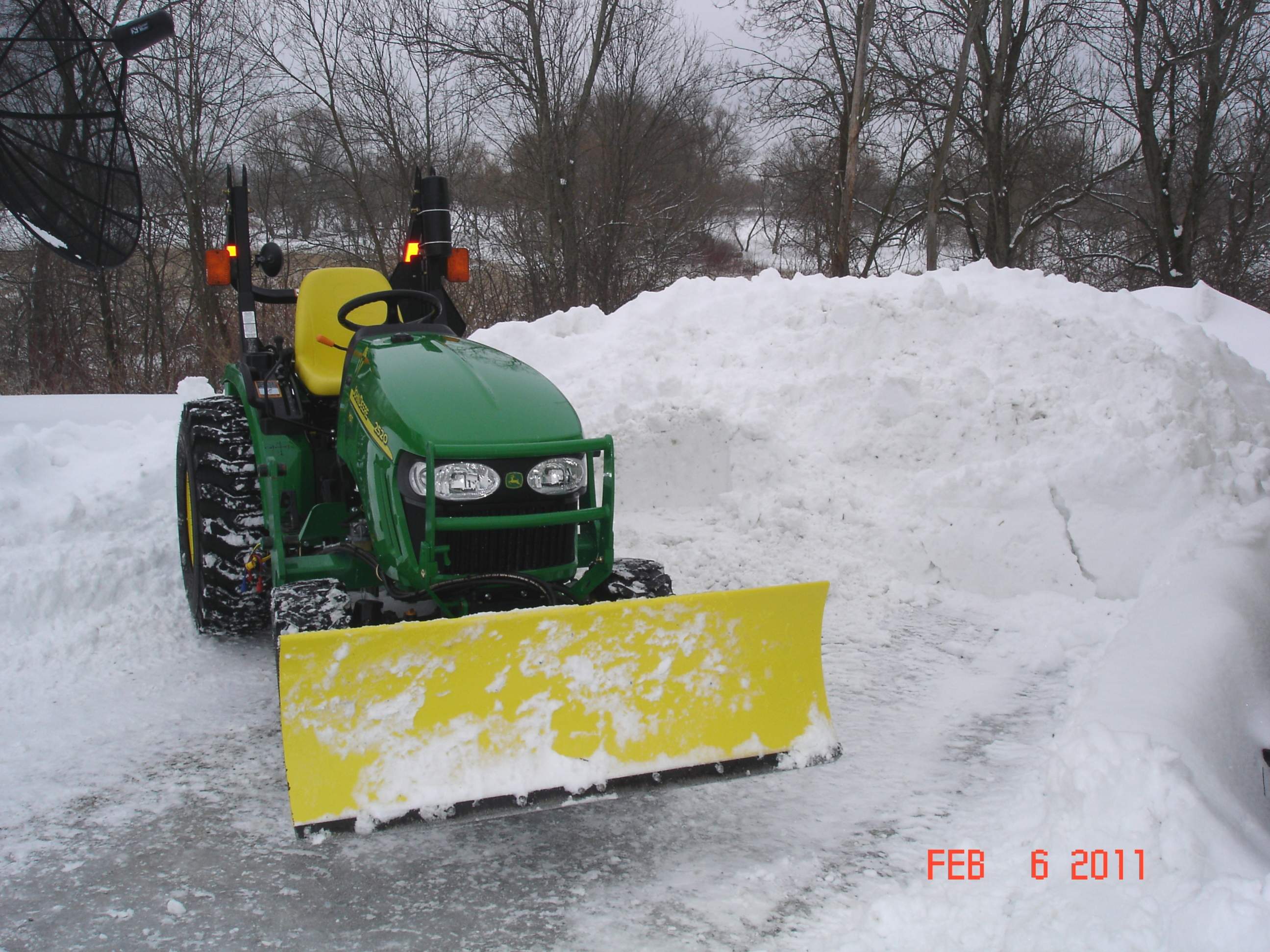

Great video beenthere. I have a 2520, and she pretty much works the same way, although I don't have the driveway length you do. I'm sure the length wouldn't matter, she'd just keep on truckin'.
She's some kinda' lawnmower let me tell you.
By the way, to the OP, if you plan on using rear attachments, get the "I" match. The only thing I use on the 3pth is the ballast box, but the "I" match makes hooking it on and taking it off a breeze. REV
