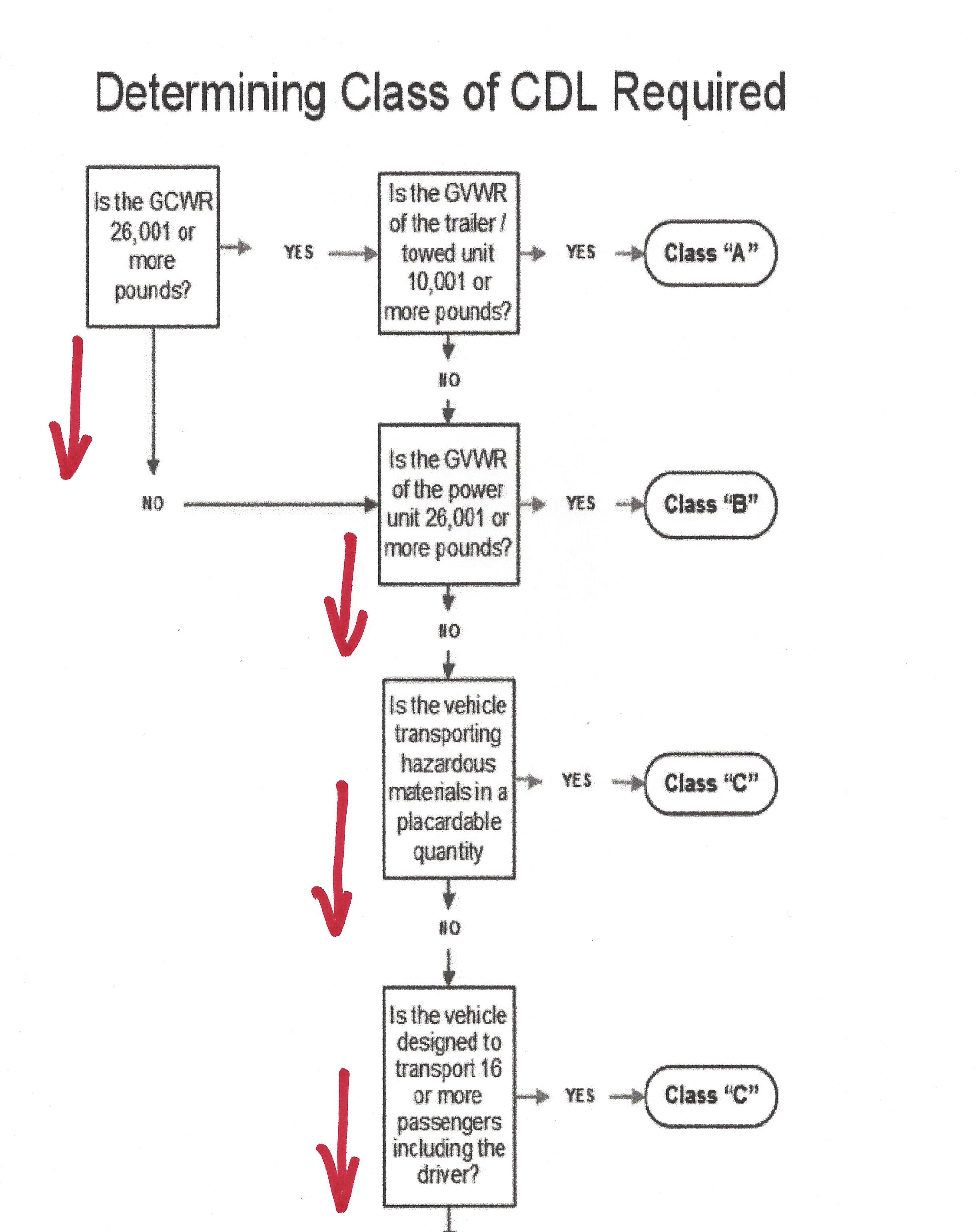

Paying particular attention to your statement that CDL laws are essentially universal across state lines I hereby submit a link to the Texas Commercial Motor Vehicle Drivers Handbook. Figure 1-1 on Page 1-1 has a flow chart indicating that towing a trailer of 10,001 lbs or more requires a CDL when involved in interstate commerce. So a driver of a 12,000 GVW truck towing a 12,000 GVW trailer DOES need a CDL if he crosses a state line. So if the laws are universal across the states as you state the Handbook is correct in specifying that a Class A CDL is required to tow a 10,001 GVW trailer across the state line. The handbook does not specify that the trailer has to actually be carrying weight.
I could risk taking my 14,400 lb trailer across state lines with a light load and probably would not be stopped. May not even be cited if I was stopped. Maybe if I was hauling multiple 4 wheelers I might convince the officer I was non-commercial. There are more than enough out of compliance 18 wheelers to keep DOT officials busy which might preclude one from being stopped. But if you go through a state that has all trucks, even pickup trucks with trailers, stop at the weigh station I would think you want your ducks in a row.
Here is the link you requested. I am betting you will NOT take it at face value and try to split hairs over something you have a different opinion about. Just saying.
http://www.txdps.state.tx.us/internetforms/Forms/DL-7C.pdf

These are the universal rules, nothing different here. And in both cases, a 12K truck towing a 12K trailer does not require a CDL
