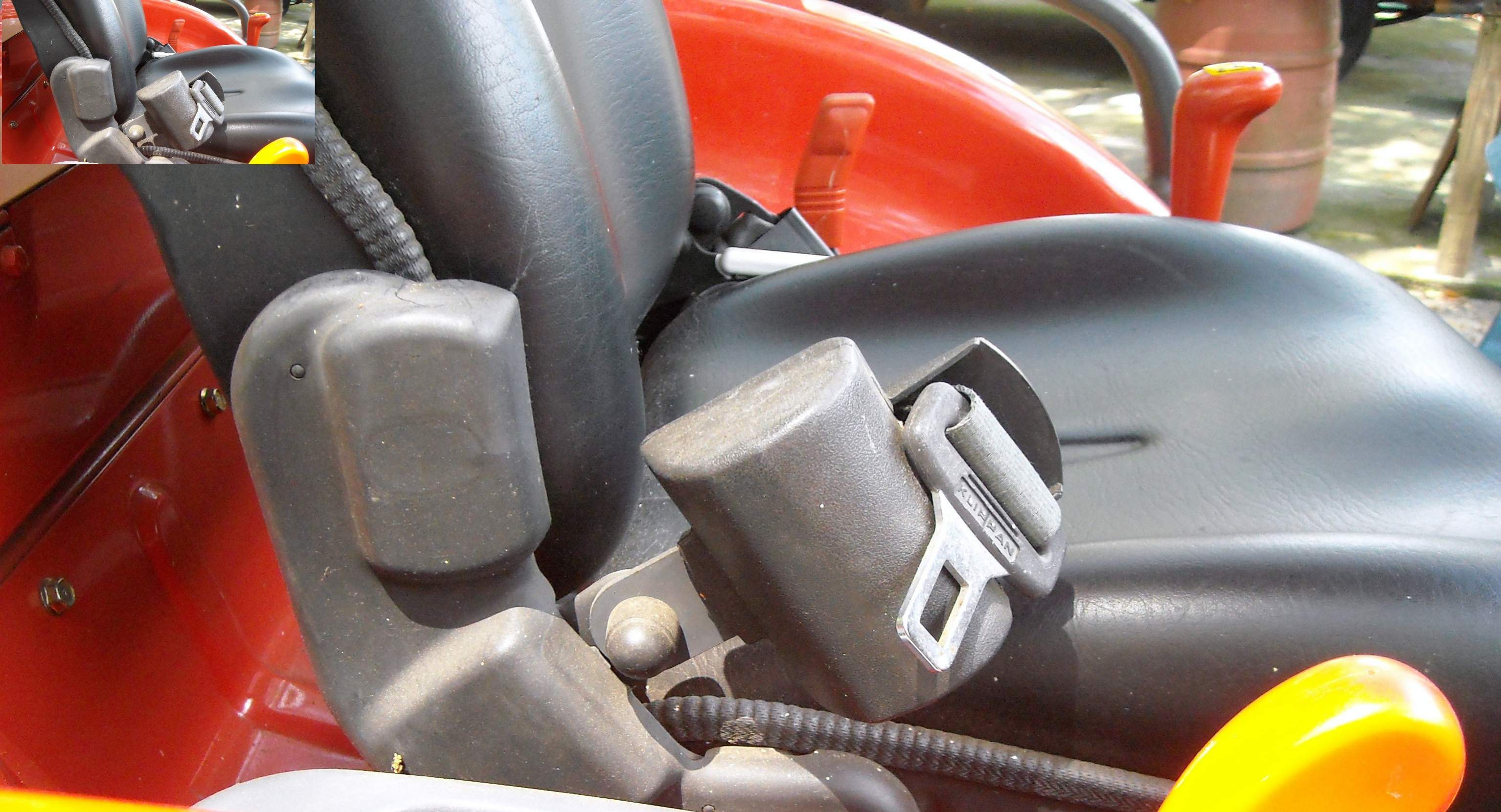

I recently bought a 2006 Kioti DK35. I didn't realize until I got home that it doesn't have a seat belt! (I test drove it before purchase, but it was on flat ground and didn't even think of looking for a belt). It has a ROPS, but what good is ROPS without a belt? I don't see any holes or anything that look like a belt was removed.
So, does anyone know did the 2006 Kiotis have belts from the factory?
If yes, could someone post pics so I can see how/where they were installed?
If no, are aftermarket belts available?
I have a steep, hilly property, and reading threads about rollovers has gotten me worried.

I have never owned a Kioti, but My 2002 Kubota B7500 had a belt, my 1999 New Holland TC33DA had a belt, and my 1992 Long 2360 had a belt, I am thinking every tractor made since ROPS came out had a belt, and I bet you 2006 Kioti had one too, and someone took it off and threw it away. Like you, I would be looking into getting one back on it.

Here's the spec sheet for a 2006 DK35, look down where it say's "With your safety in mind", as kuoa stated, I would be looking at getting it replaced.

My 2004 came with a belt. Sounds to me like someone took them off.

/ When did they start putting seat belts in? #7
Here ya go, this is a 2008 DK35, should be the same if they haven't replaced the seat.

Thanks for the pic - that's very helpful. I just went and checked and my seat is a slightly different design, but I think I can see how it hooked up.

I received my belt, but due to vacation and other distractions, I am just now installing it. Does the belt just attach to the seat? This seems odd, as my seat can flip forward to the steering wheel, with no latch. It seems to me that if I rolled, that seat would be flopping forward, with me attached. But I can see no way to bolt the belt to the tractor itself, and in the picture someone posted above, it appears to be bolted just to the seat. Anyone have a 2006 that they could post pictures of?
/ When did they start putting seat belts in? #20
There are usually unused holes in the bracket that holds the seat. If not you have to drill some and use large washers for backing underneath. They should have come with the seat belt.
