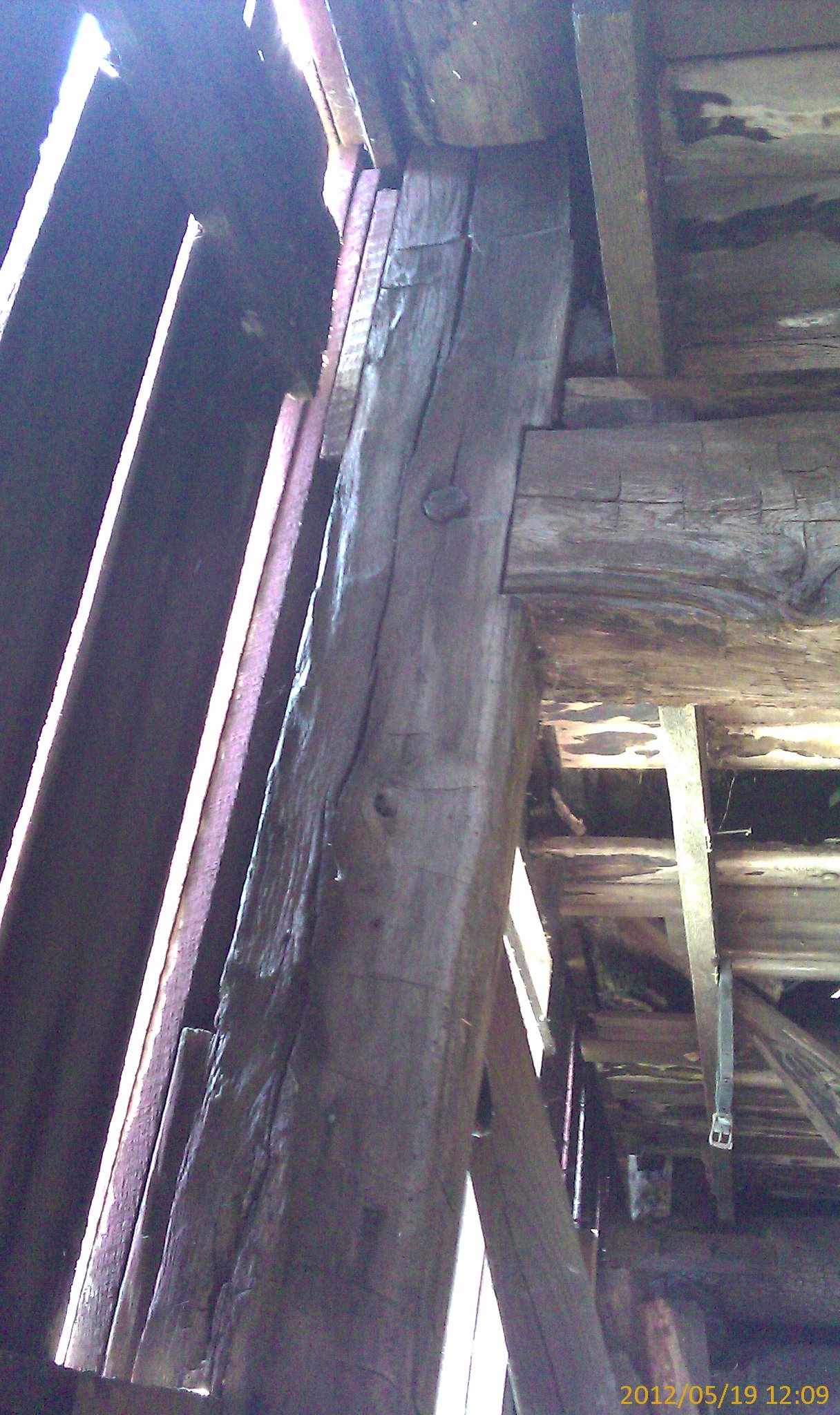

IMAG0403.jpg Supports such as this are difficult to beat and all this supports is the hayloft.

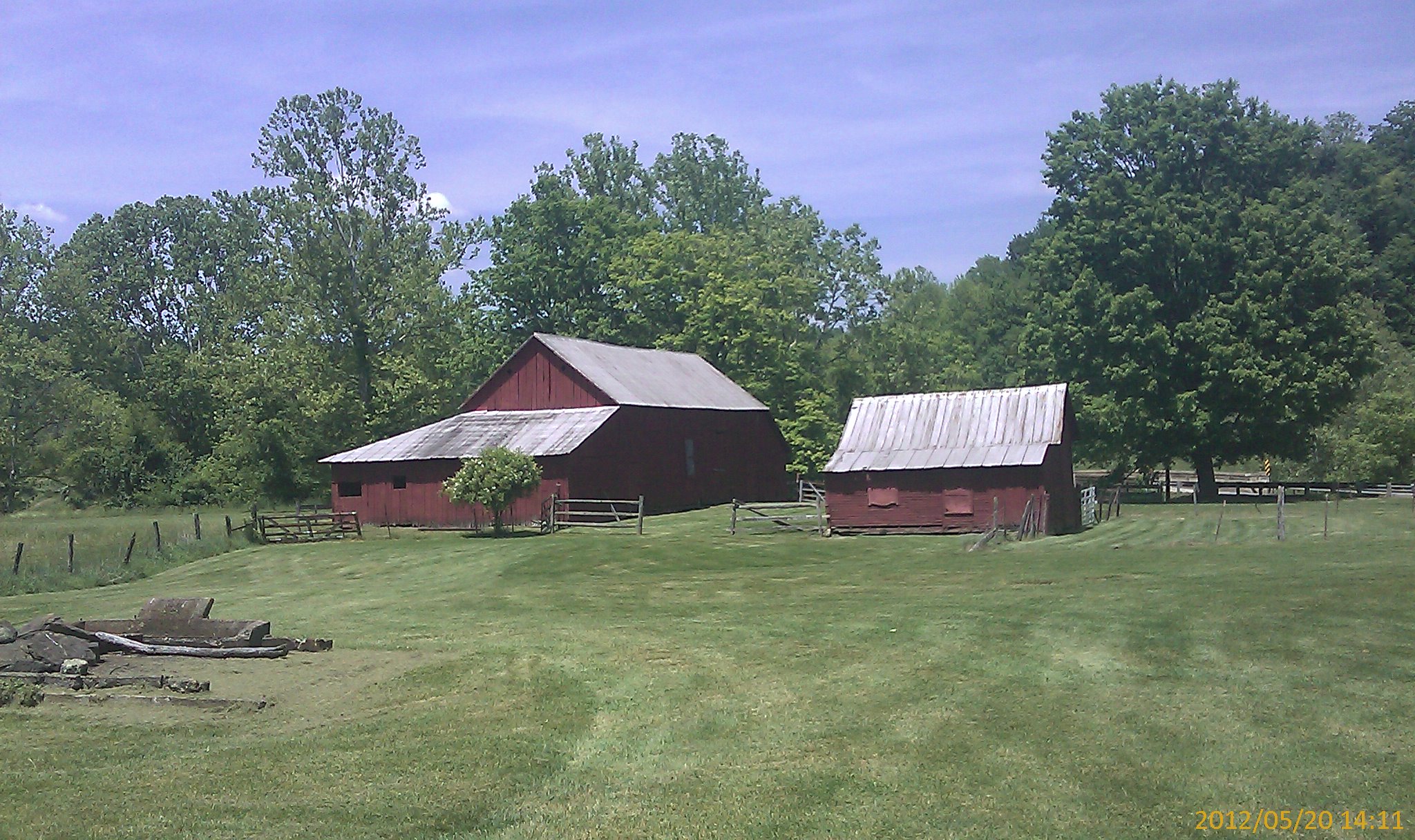

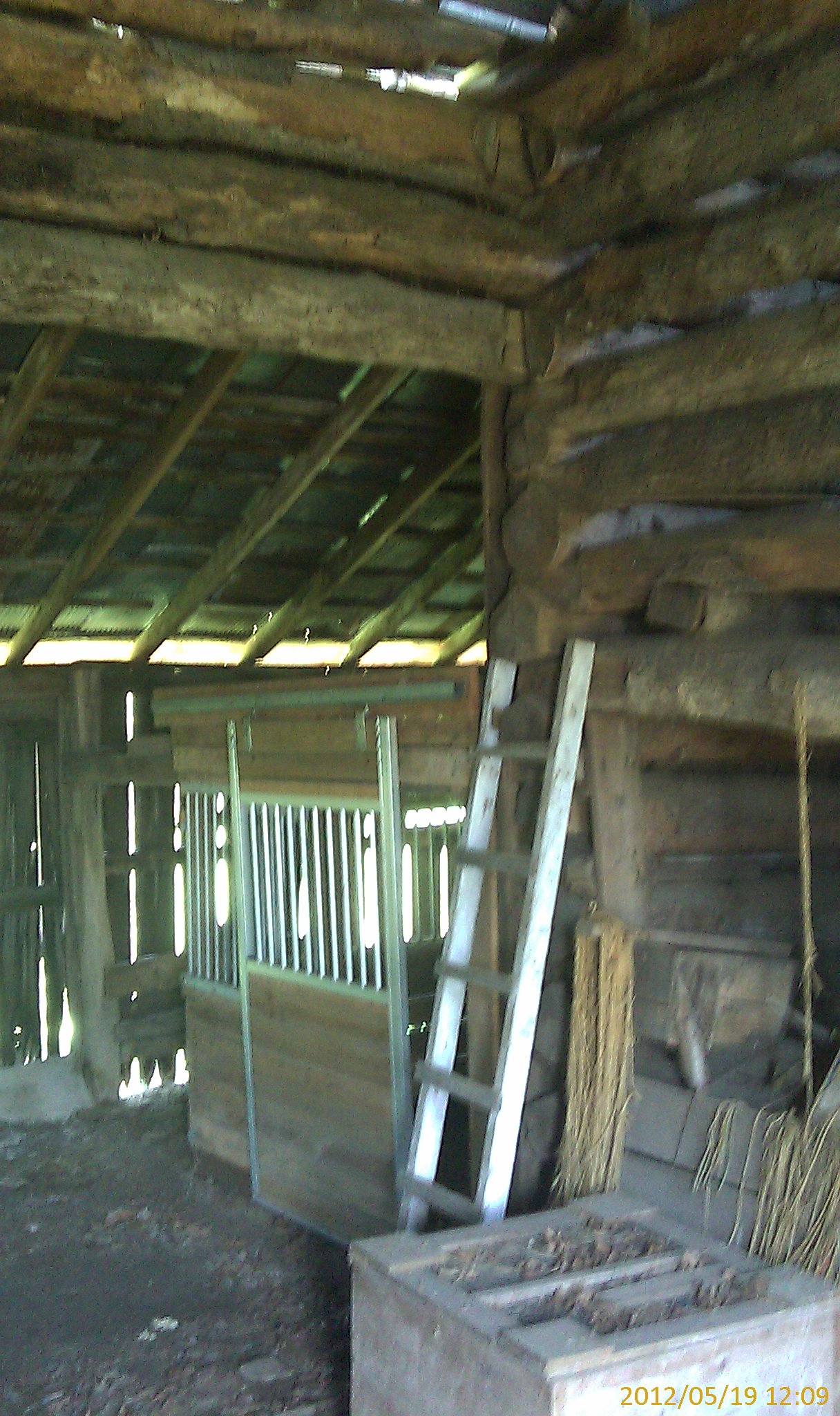

We are emotionally attached to it which is why I ask. I don't want the emotional attachment clouding the choice to be made. This farm has been in the family since 1763, the barn which was complete in 1850 sets right across the creek from one of the original Shawnee Indian villages. The confederates attempted to burn it during the civil war but it was a rainy day and the logs were mostly still green, so it never burned. After some minor repairs it was still usable.
Don't have any good pictures, just some random ones. First is inside one of the main sections of the barn. Second shows the wagon shed and barn from the rear paddock out by where the outhouse sets. The last of those three was just after the new farm house was completed in 1873.
