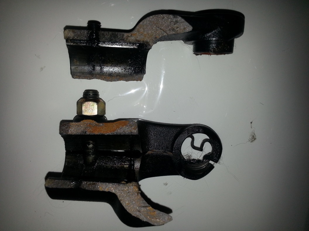

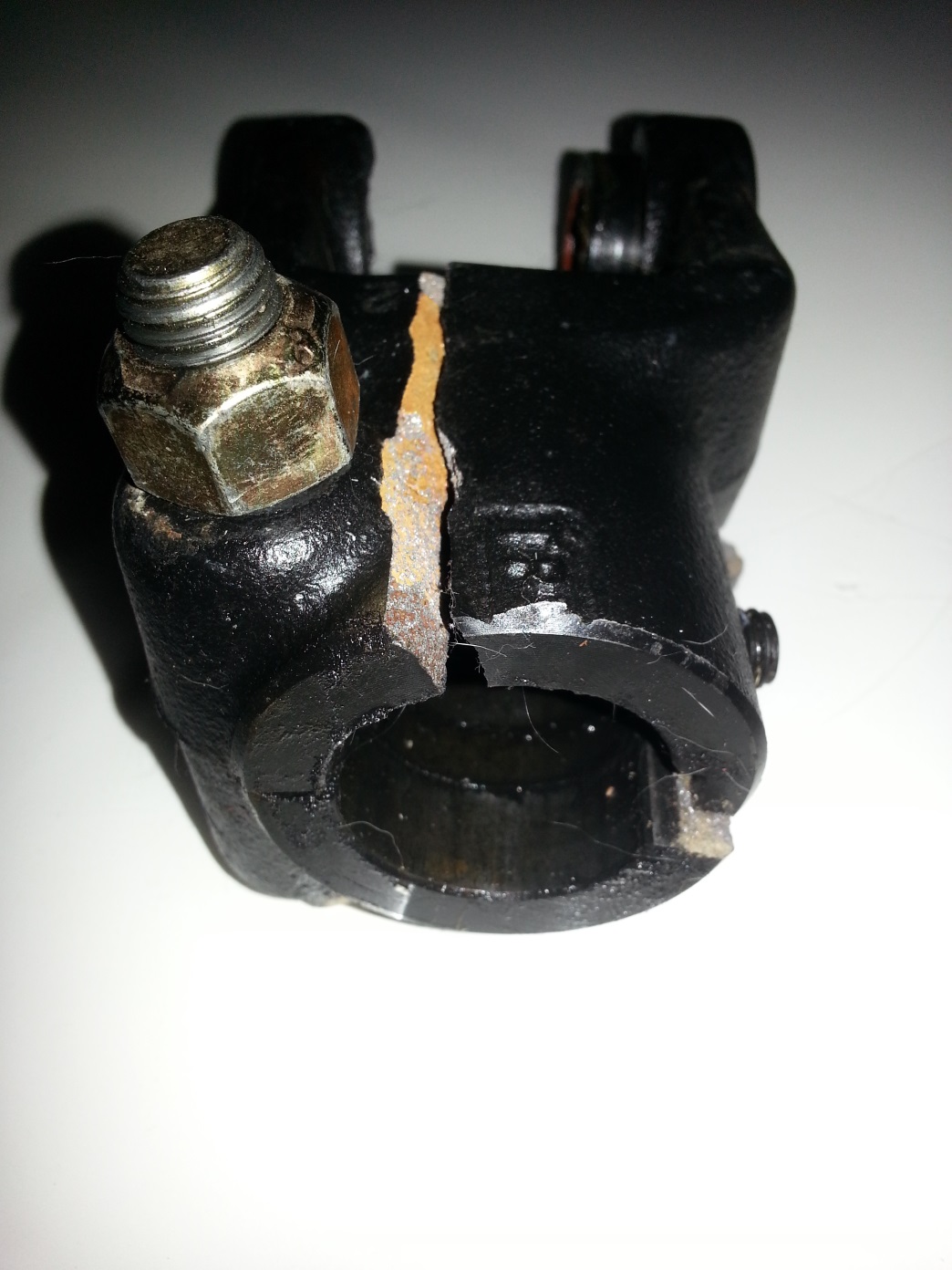

I hit a rock with my Allied Buhler 60" snowblower. Not the first time, and the shear bolt has always done it's job. But not this time, even though it is the same grade of bolt. Something had to give. I guess I'm lucky It wasn't worse. Pictures are of the yoke that connects the driveshaft to the blower, it's what was sacrificed. The u-joint is still intact. Anyone know where to get replacements? I'm starting to call dealers, but guessing they may be expensive, wondering if there is an alternate source for these. It is a single keyed shaft, not splined.

The dark discolorations on the second picture indicates that there was a fracture there for some time before the failure, probably from another shear incident. That's probably why the yolk failed before the pin.
Even when you get a replacement, I'd probably grind out and braze that one back together just as a backup, unless they're dirt cheap and you pick up one for a spare.

I believe Flyerdan has a good handle on the cause of this failure

The main challenge for brazing would be the loop for the u-joint that has been deformed and stretched open as can be seen in the second pic. I'm not an experienced welder/brazer though I've done a bit. The part being cast, I understand it would have to be preheated and slowly cooled to prevent cracking. Wouldn't hurt to try.
Interesting thought about it already being cracked, the rust discoloration does seem to indicate that.
