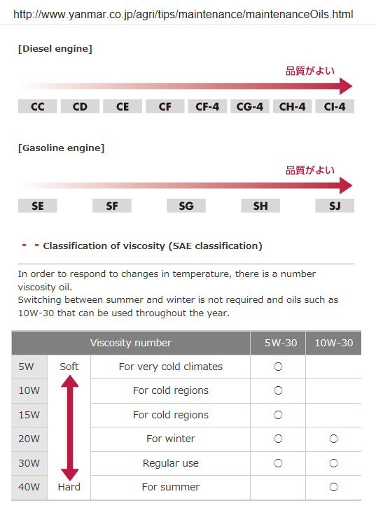

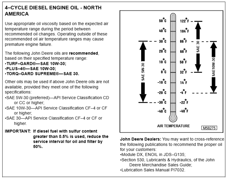

Engine oil for the Yanmar 2T, 3T and 4T engines per the Yanmar website.
John Deere for the 50 Series of Yanmar made machines.
