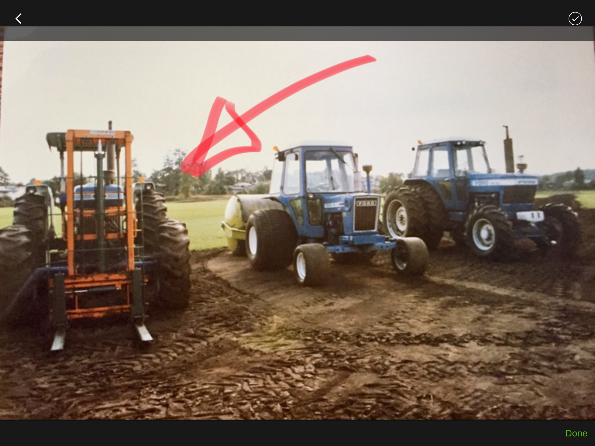

Thats interesting about the gear lever placement. I had a 5610 FWA with Dual Power. Duals front and rear. It was an awesome trouble free tractor. Good luck with your bid.
Post pics if you get it.
Edit. Just found a pic of mine with duals off.
