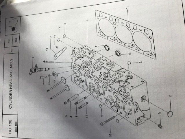

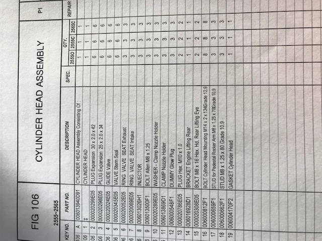

HI Sideskraft, allthingsdiy mike, i am sorry i accidentally deleted your comment and didnt know how to get back to you. attached are pics of where they are on the 2555. glow plug 1.jpgglow plug 2.jpg i think its #12 in the pic. dont know why it says DUMMY glow plug. I am sorry i could not gt back to you.

HI Sideskraft, allthingsdiy mike, i am sorry i accidentally deleted your comment and didnt know how to get back to you. attached are pics of where they are on the 2555. View attachment 634576View attachment 634577 i think its #12 in the pic. dont know why it says DUMMY glow plug. I am sorry i could not gt back to you.
Thanks Mikeman1, but your engine is a 3 cylinder and mine is a 4 cylinder. Turns out that mine does not have glow plugs. It only has the intake manifold heater element that warms the air going into the engine. Using a clamp multi meter, I measured the current that the element is pulling and it settled around 53 amps, so I assume that it's working as it should be.
