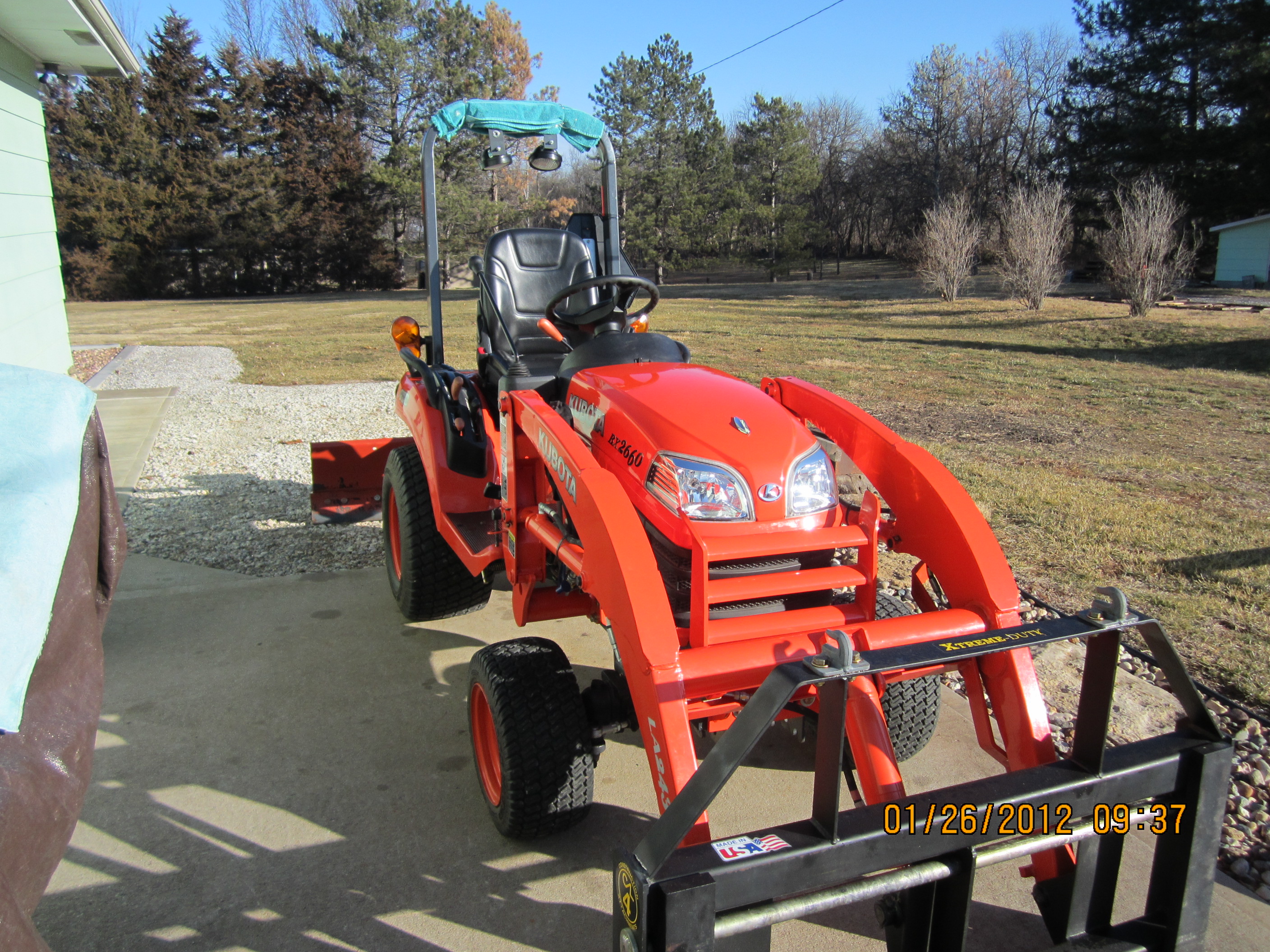

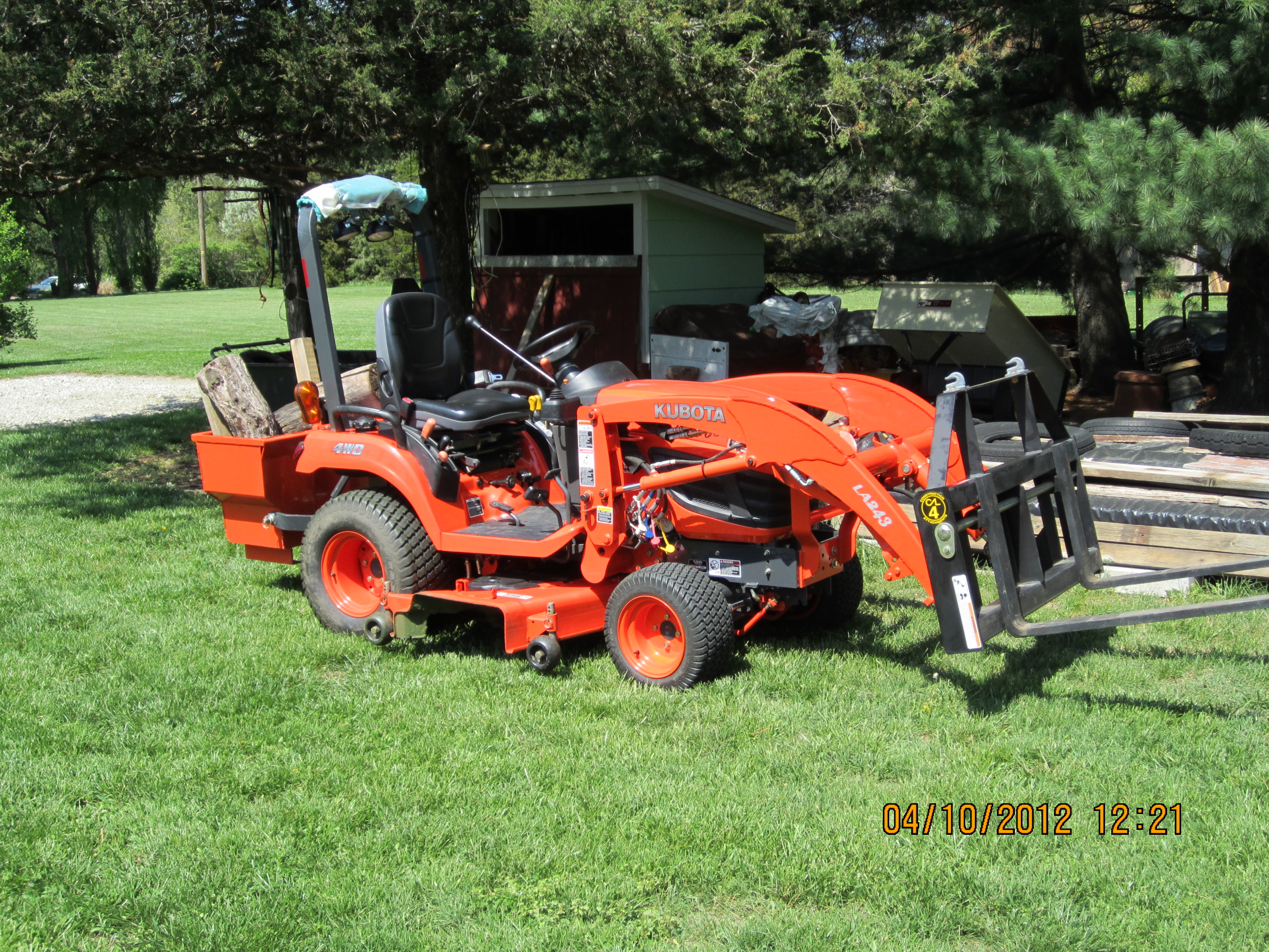

About 8 073.JPG years ago I bought pin on pallet forks for a BX2660 from Everything Attachments.039.JPG
Cheers,
Mike
