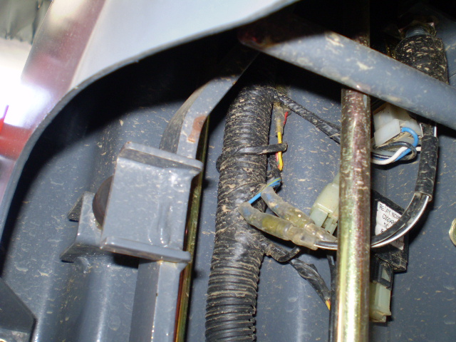

I've read a dozen wiring threads here, but am still trying to set up work lights from a good source. Where do the red and red/black wires from the 15A Customer Fuse come out at, so I can connect to them? (I'd rather use those than the black bayonet-terminal wires under the rear cowling. )

Rex, I am still searching for where the Customer Fused wire goes. I did find a connection to the 'Backup/Working light' fuse. The wires seem to be wrapped around the main bundle of wires coming from the fuse box. They are up behind the clutch pedal. I had to pull the lower 'dash' panel to aid in being able to see it. The RED/green wire comes from the fuse, the YELLOW wire is suppose to go the the Backup light. See attached photo. If photo does not attach correctly, it is also posted in my photo gallery.
Good morning Jim! You're up in Maine now? I was stationed in Winter Harbor, lived in Hancock. Beautiful state, just too darn cold and long winters. Hope your tractor hut is heated :)
I've been in the shop a couple of hours this morning looking for our wiring too. Your good find for the Backup/Work light bayonet connectors under the clutch. The Red/Green(Aqua?) wire is heavy enough for another light and shows 12V when the key is on/preheat. And it's in a handy position to run up my fabbed TOPS/ROPS structure to the lights.
The Customer Fuse block shows 12V when the key is on Accessory, that's the key position I want (or hot all the time would be fine too) so I'm heading back out to look for more red/black wires.
I checked under the center-dash panel, the harness just passes through. There are hydraulic connections and the steering linkage, which I hope never to have to mess with.

You didn't miss anything Virgil. I'd just rather use the existing Customer Fuse if I can find where the wires go to, and my lights have weatherproof switches on them already.
I've got a weatherproof switch and inline fuse for the lights directly off the battery if have to go that route. Tracking down wiring stinks, so that may happen.
