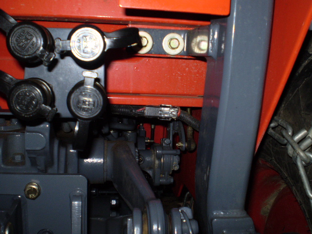

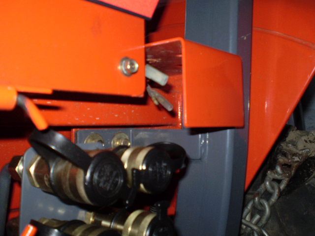

Rex..... looks like with help from my dealer... and some poking on my part.. I found the "Customer" fuse wires. They are in the back by the remote outlets. Actually I found 2 sources of power back there. There are two small wires, one black one red, with bullet connectors on them, tucked up above the remotes, a little to the right, wrapped around the harness, like the ones in front of the clutch pedal. These seem to be the extension of the wires found in front of the clutch pedal, as the same fuse powers them.
About 8-10 inches below them, is another wiring harness, it has 2 wires going into a 3 pin socket. One wire is red, the other black, these are heavier gauge than the others above. The power here is controlled by the 'Customer' fuse. :) Both of them seem to require the Ignition switch to be in the ON position, but I need to double check the 'Customer' as the schematic I have shows that it should have power in the ACC position.
First photo (425) should be the bullet connectors that go to the 7.5 amp 'Backup/Working lamp' fuse. The second photo (426) should be the 3 pin connector that goes to the 15 amp 'customer' fuse. Some day I will figure out how to post pictures in a post.

   / Where do the Custome Fuse wires go? #13
There are two sets of wires with bullet connectors have power in the acc position. The wires on the right side I connected to a power plug (aka cigarette lighter) I use that to plug in a magnetic base amber flasher that I stick on top or the ROPS. The set of wires on the left side switch with the headlights so I attached a magnetic base 55 watt work light there. No problems so far. Note that the male connector is ground on both sets.
