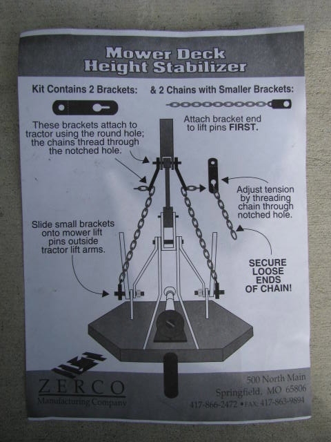

   / Where do These Chains on my Bush Hog go? #16
Check Chains:

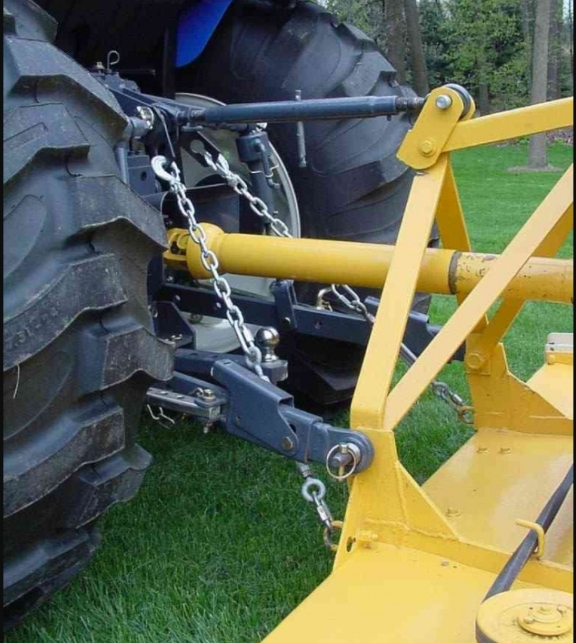

The ring I'm talking about is in the plastic stuff that covers the shaft. It's about 3/16" in cross section. No lube anywhere near it. I can't remember why I thought I had to pry it out, but I think it came from information I found on the web. I can upload a photo later.
Here's something important. Today, Youtube put something great in my feed: a video that showed that my bush hog is assembled incorrectly. Apparently, a huge percentage of them are put together wrong by ignorant owners and store employees. Sometimes you actually have to read the manual.
There is a U-shaped part that attaches to the top link. As you can see in my photo, this part is held in place rigidly on my attachment. Whoever assembled the cutter ran two bolts through it. This is wrong.
The U-shaped part is supposed to swing. It allows the bush hog to lift when the tractor hits a low place or the bush hog hits an obstacle. Yesterday I kept digging trenches with the rear wheel of the attachment because this part was not free to move.
If the part is in there wrong, the bush hog will dig into the ground, and the long support bars on top will bend, as mine have. It can cause the rear wheel to be torn off.
I'm going to remove it and put it back the way it should be. I don't think there will be any need for chains once the cutter is assembled the correct way.
It would be hard to use chains on my tractor because the shield that covers the PTO shaft is in the way. Not sure how the previous owner did it. The shield is missing some paint, so maybe he just bubba'd his way through.
The previous owner had this tractor for 14 years and never learned how to use the bush hog correctly. Amazing.
King Kutter still sells this bush hog, and it doesn't come with chains.
I'm also going to drill a few 1/2" holes in the deck, as King Kutter should have, to prevent rainwater from pooling on it.

Appears to be check chains to limit how far down cutter is allowed to drop.... I have check chains on my ballast box so I don't have to continually adjust the ballast up as it tends to drop on it own over time.....
