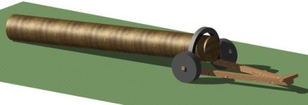

what is a logging arch? and what does it look like? /forums/images/graemlins/crazy.gif /forums/images/graemlins/confused.gif
   / where do you hook up skidding tongs ? #12
The arch I used was a home made job that I borrowed off someone here on the island. I've sketched the geometry of it which is attached. It's made from car wheels and some bent rhs, with the triangular frame in front made of 2 x 4" lumber, a simple device but very effective.
When the arch is offered over the log, lifting the front of the A frame vertically lowers the metal arch so it can be chain secured to the top of the log. Pulling down on the front of the A frame then raises the arch and so the log. I found that the best position for the arch was somewhere just in front of the centre point on the log so most of the weight was supported on the arch and wasn't being trailed.

thanks for the pic.thats a clever item. /forums/images/graemlins/cool.gif
   / where do you hook up skidding tongs ? #14
The guy who loaned it to me was a horse logger. I found that with the logging arch, we could get logs out from areas where the tractor couldn't go. Because most of the weight of the log is on the arch, two of us could use a come along to pull logs to where the logging arch could be wheeled then handball the logging arch with the log slung on it to a location where the tractor might be. This minimised the amount of tractor trails we needed to build in the woodland and also minimised the environmental impact of the logging.

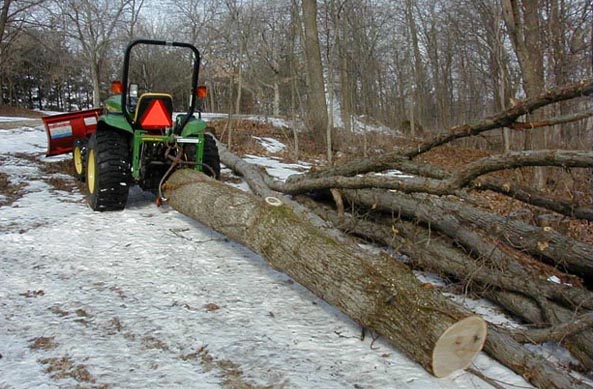

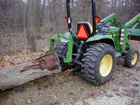

I've been skidding with the 3pt for many years, and while there is a danger, it (IMO) is not one of limiting nature if you keep your wits and do not go 'fast'. Low gear, steady pull, watching for any lifting of the front end, where the rear wheels want to walk out from under the tractor. Then stopping, and/or lowering the 3pt arms, will keep you out of trouble. The backward 'flip' of the tractor is not sudden. It takes enough time to react.
I now hook the logging tongs to the top iMatch (3pt quick hitch) and it works extremely well to pick up the front end of the log while dragging the tail end. No digging in, and plenty of weight on the rear wheels for traction.
Pic of doing it with my present setup.
   / where do you hook up skidding tongs ? #16
Here is a big white oak log that was pulled up hill out of my woods with the iMatch and tongs, and without chains. There was some slippage with the R4's, that I didn't used to get with my 2cyl 420 Deere that had R1's. This log will go into firewood (burns great after split and two years drying).
