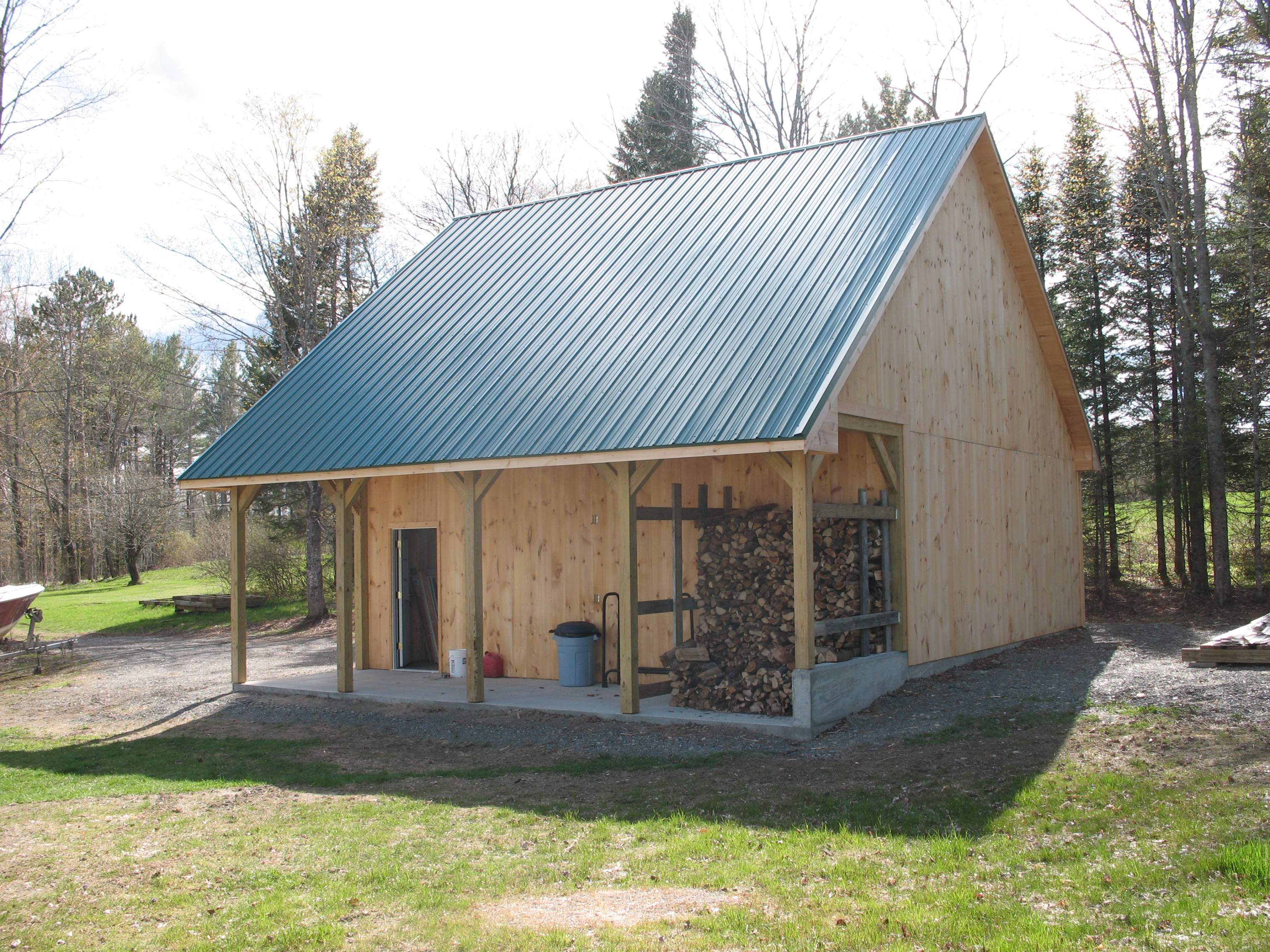

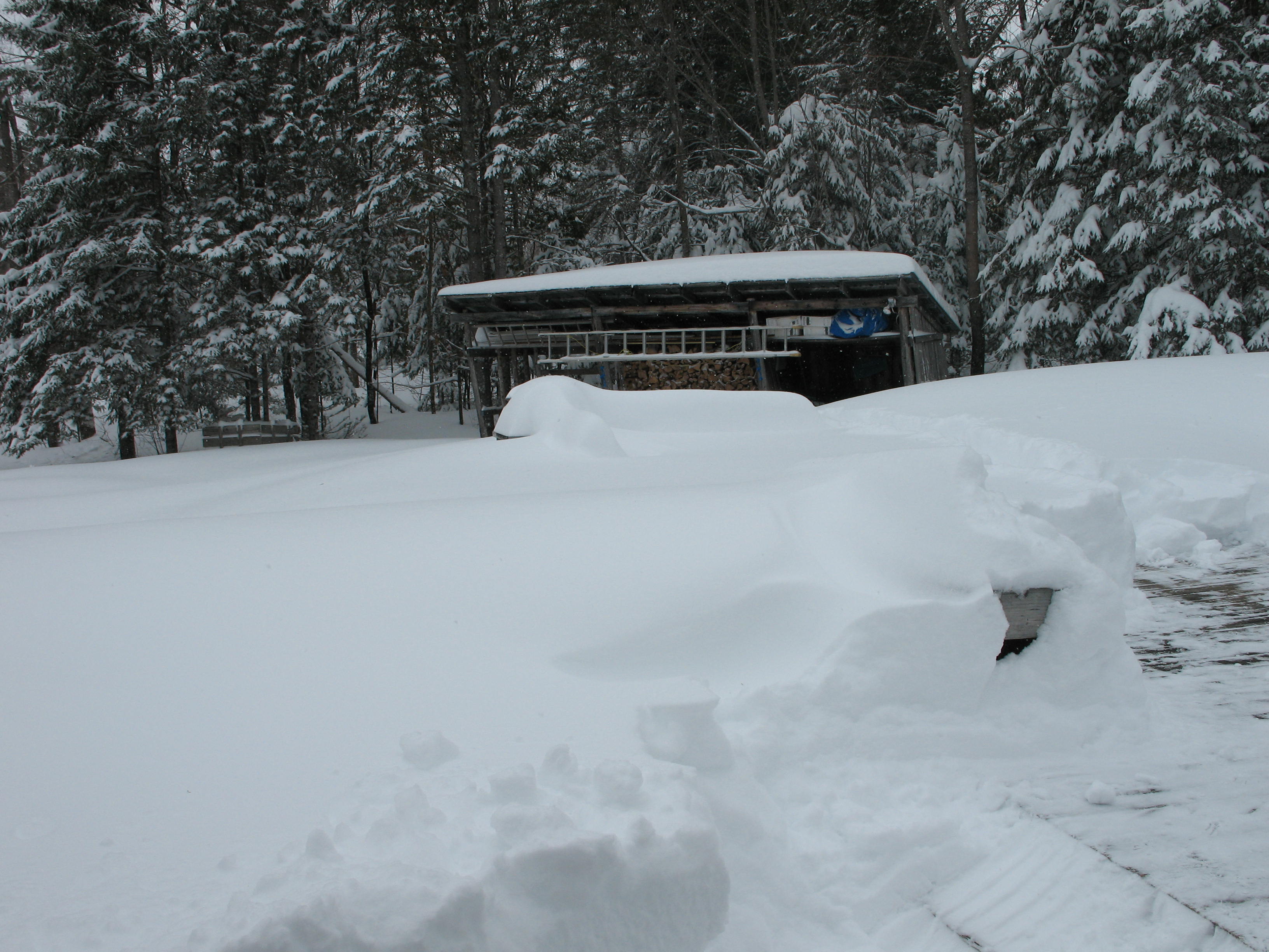

I built a three bay shed 23 years ago. Each section is 8 feet wide and 8 feet deep. 12 foot slanted metal roof sections, cedar poles in the ground - dipped in creosote at the time. This old war horse withstood over 4 feet of snow for several winters. I tore it down last summer and replaced it with a barn with an open baker on the side.
Considerations on wood storage:
proper ventilation
up off the ground
ability to rotate stock - fill one side while burning from the other - thus always having access to dry, seasoned wood
frost heaving
proximity to stove (tough to get mutha to go out when it gets 30 below)

I second the "nice barn" comment!
