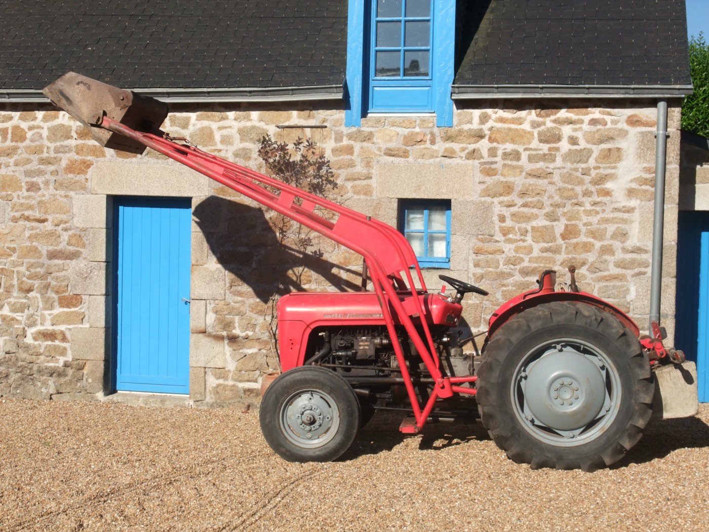

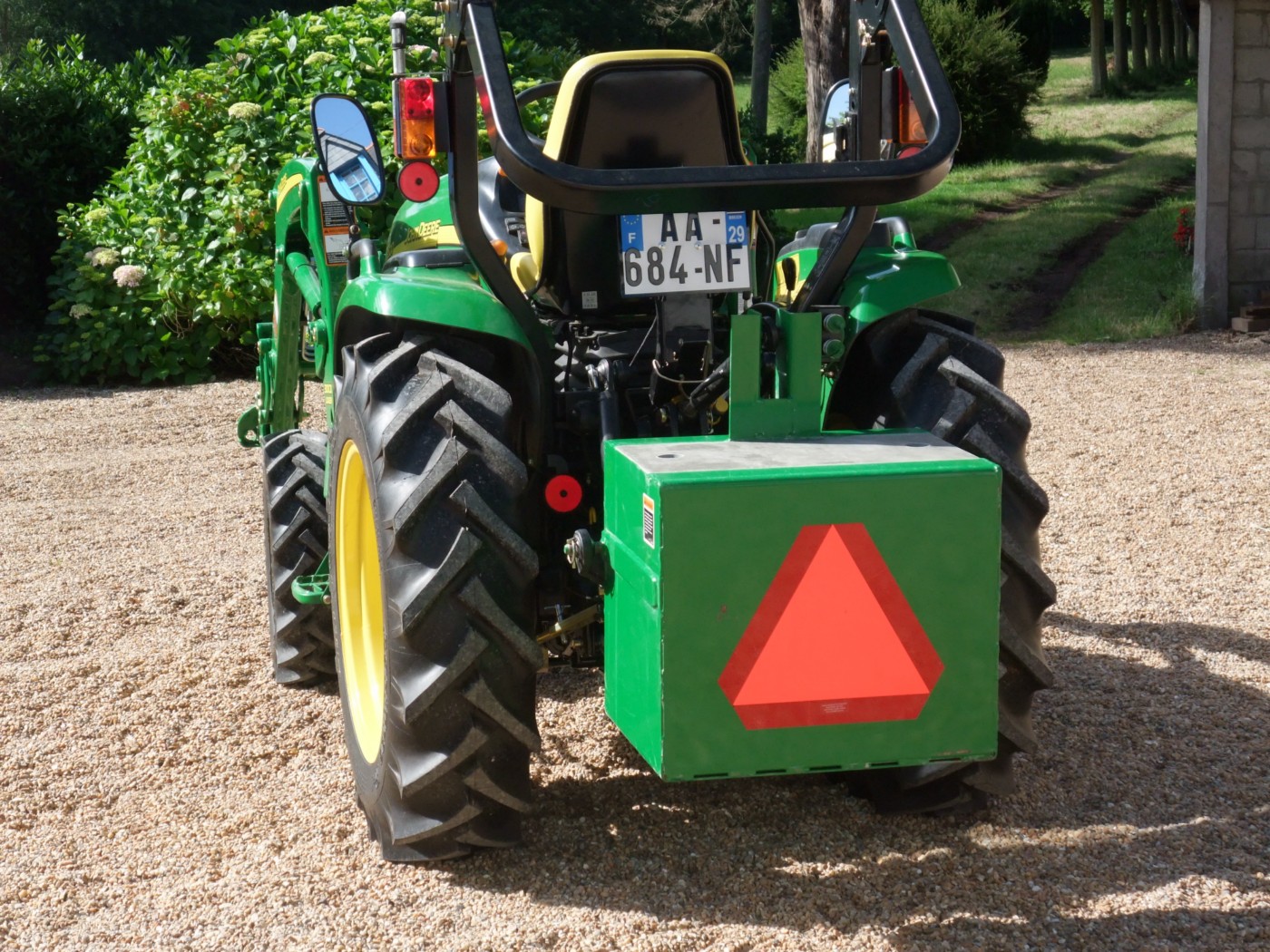

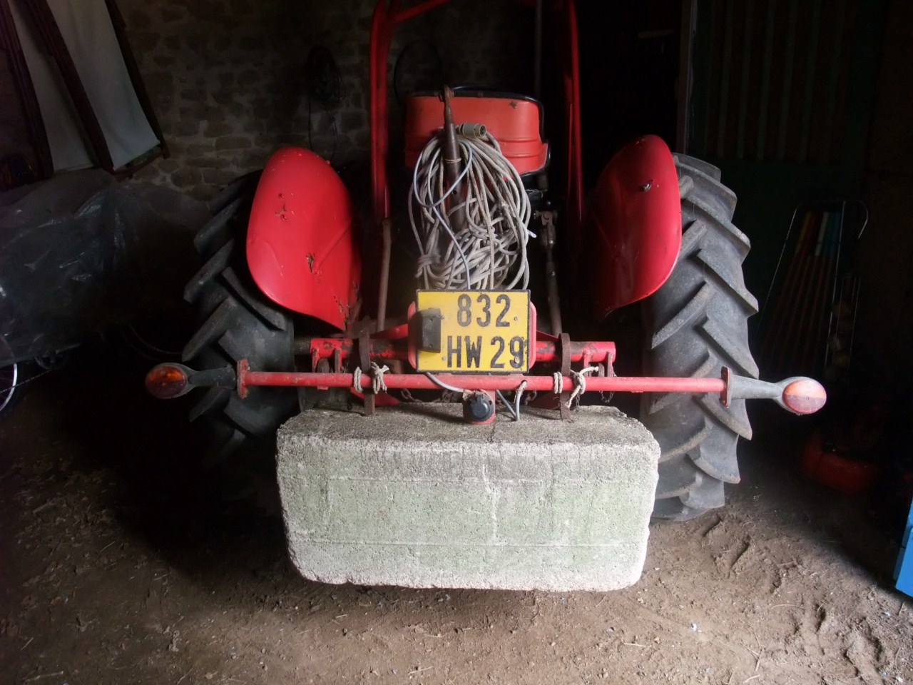

With or without power steering, steering will be difficult with a heavy load on the FEL. The only solution, which makes a world of difference, is to have a heavy counterweight on the back of the tractor. Below my former MF 35 and present JD 3520.
