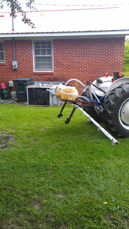

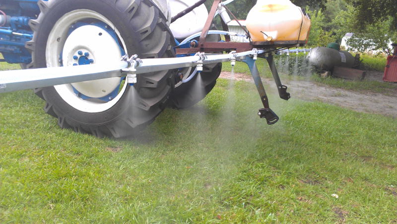

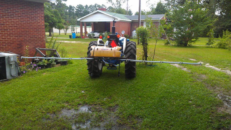

Than you everyone for your input below are some pics of what I came up with. Not 100%done I still have to make boom supports but I did try it out and it works great.

Looks great. My problem with spraying with the tractor is I only do it every 3-5 years so I forget what gear the tractor is in to apply 50 gallons over 4 acres without driving over again and again. I suspect I use gear 7 of 9 gears. I always fail to write down my recipe and my speed. For me I am also constrained by the quantity of rain, or lack thereof, and if there is going to be any washing rains a week later so the horses can go back on after weed killer. It is raining enough lately that I can actually do a pasture spraying with the big sprayer.
I assume someone told you that it is important to drain your lines at the end of the spray season and squirt a few pumps of clean motor oil in the roller pump after you removed the hoses. If you do not you run a good risk of having the pump seize up. It is waste of time to spend an hour disassembling a pump at the beginning of the season because you failed to oil up the pump.

Yes I was informed of that. I received the pump from a friend which he had for years. The first thing I did was soak oil in it and put it on the tractor to lube it up good. The whole project cost me $240 which I think is a great deal considering agri supply wanted $600 for their 6 foot 3pt hitch set up. I made twice the boom for less then half the price. I still need to come up with a spring solution in case I hit something. My idea did not pan out right. Other then that just need boom supports. I might add a boom section selector valve and a psi gauge but will do that at a later time. She is working now and cannot wait to get in the field to use it.
